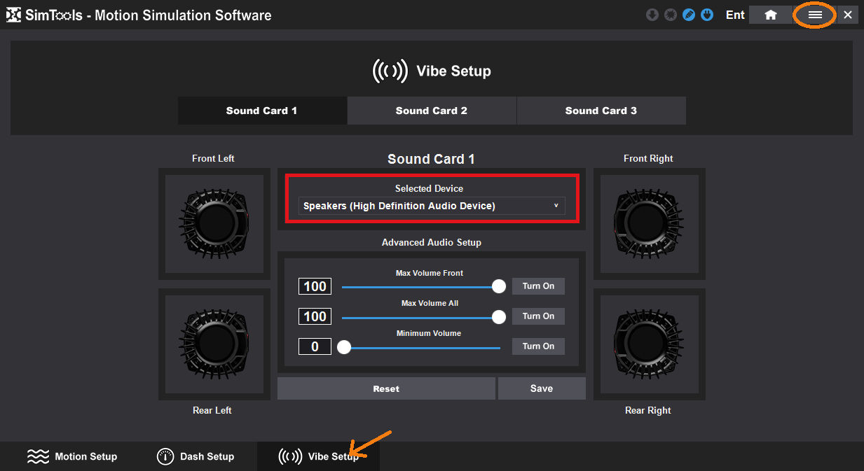

    You can set it up under Interface Setup (from the main hamburger menu - upper right)

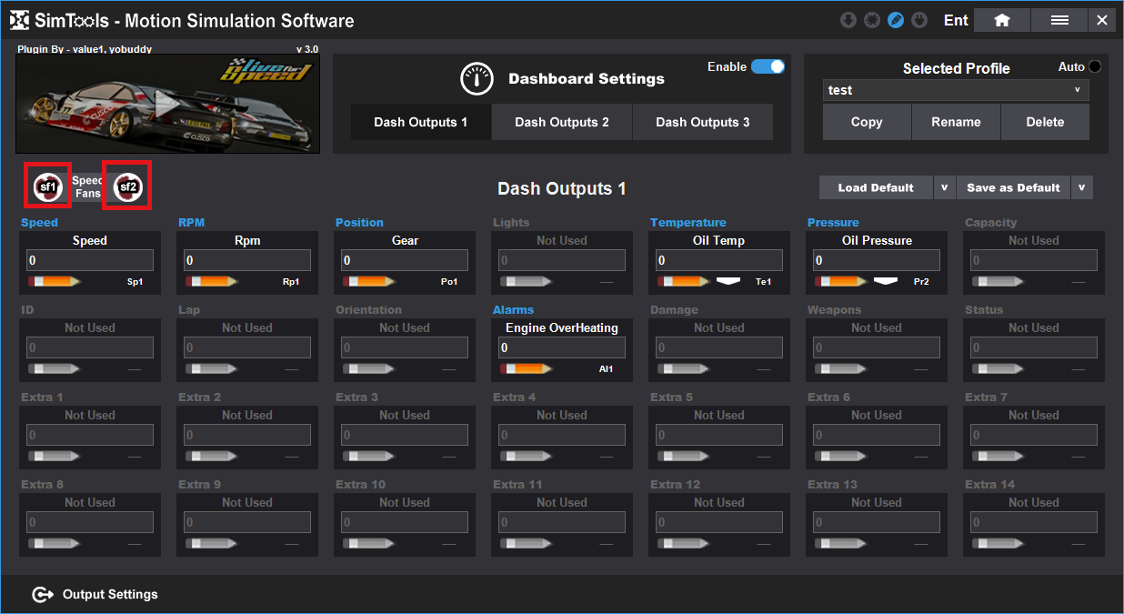

    I little confusing about how to "wind" working on dash. I choose TRUE WIND or SPEED? On output rules, dint use "Math * 1, Round 0, and Pad 3 0" for example? I try "GetBits 1 5 8 d" and my fans runs at max speed. On output settings, i just put ONE VAR is this correct? Like "<Sp3> , diferent old v2.5 ( S<Dash1> ) right? How can i access the tab "3d fans"?

  5. yobuddy
    51,779Coins
    +5,206 / 19 / -0
    Speed usually.
    Math * 1, anything * 1 is the same value, so this won't do anything I believe.
    Round 0 basically turns the output into a integer.
    Pad 3 0, means pad with '0' so a 3 output would be come a '003'.
    I try "GetBits 1 5 8 d" and my fans runs at max speed. On output settings.
    This would only allow a speed input of 1 to 5.
    I think you would want "GetBits 1 100 8 d" or something like that?
    And for decimal output you may still need: Round 0 and Pad 3 0.
    The 3d speed fans can be assigned like this 'S' + 'F' + # <sf1> or <sf2>
    Hope this helps?

    About finding the 3D fans for the game?
    The plugin does not support 3D speed fans I'm afraid.
    https://simtools.us/plugin/?varname=30&color=0e97dd
    I need to post the updates to the game API soon.
    As 3D speed fans was not available when the plugin was built I believe.

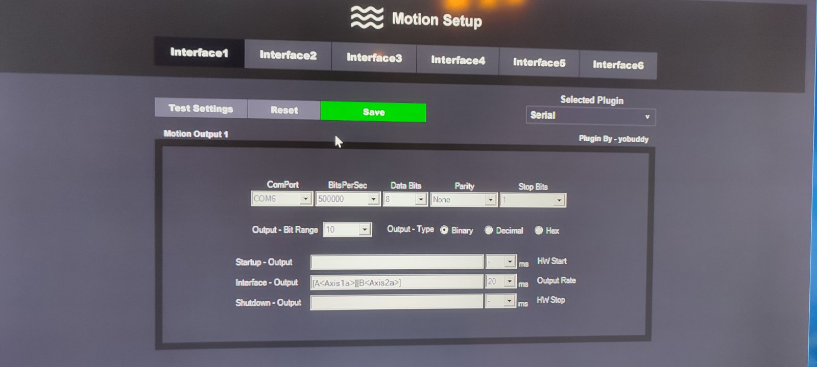

    yes, i did it. speed works as well, i try my wind sim in simtools 2.6 and works perfectly. on v3, show me correctly speeds variation, but no wind on fans. Maybe some error on my variable in interface output?
    i can use "S<Sp1>" or only "<Sp1>"?
  10. yobuddy
    51,779Coins
    +5,206 / 19 / -0
    Let's say the current speed value is 50, then:
    S<Sp1> would send 'S50'
    Where <Sp1> would send '50'
    Hope that makes sense, it would just matter on what you need for output is all.

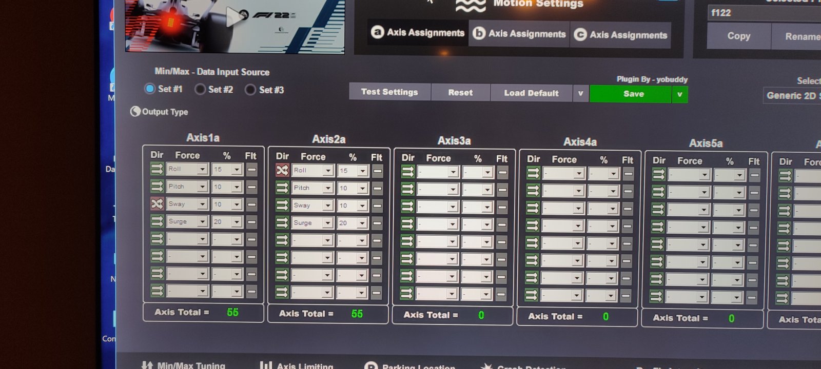

    I assume problem was faulty potentiometer. I have changed it and now i can run simtools v3. BUT i have another question, about f1 22 gears. I know that surge is responsible for gear kicking, but i can get that kick only from 6gear to 8gear. I have tried Min/Max tunning adjust, if i set 0.2-0.6 value, on braking my rig swings too much nose down and it feel unrealistic, if i set above 0.6, then braking is ok, but gears kicking only 7th and 8th. And also depends on situation where am i in a track, downhill gears feeling ok, uphill some time no kicking at all. If someone has any suggestions, please share. :)

    Sorry for late response. I am using roll, pitch sway, surge.

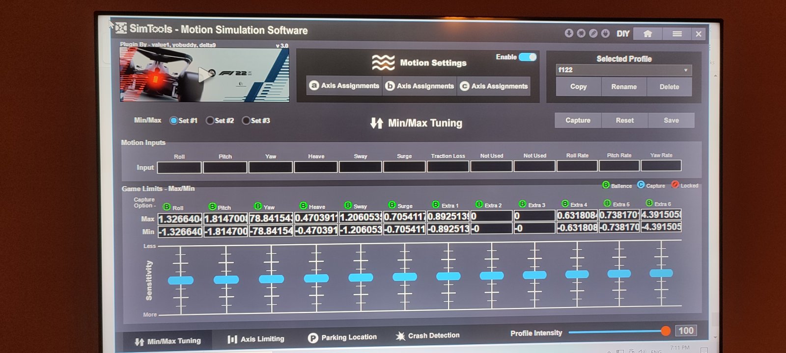

  13. yobuddy
    51,779Coins
    +5,206 / 19 / -0
    That would make sense, could be a loose connection too.
    Set Surge to the blue capture 'C' option and capture max/mins. (Instead of the green balanced option)
    You will find that the max and min value to not need to be balanced to get the best result.
    It may depend a bit on the resolution of your motors, but believe it will work better this way.
    I suggest you sent your axis profile so your only using surge, to make it as easy to get it as good as can be.
    Then add the others back in and you should be good to go.
    Take care,
