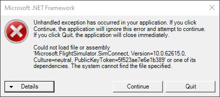

    I have a none steam version of msfs 2020 and it does not work for me. Here are the details of the error details.
    System.IO.FileNotFoundException: Could not load file or assembly 'Microsoft.FlightSimulator.SimConnect, Version=10.0.62615.0, Culture=neutral, PublicKeyToken=5f523ae7e6e1b389' or one of its dependencies. The system cannot find the file specified.
    File name: 'Microsoft.FlightSimulator.SimConnect, Version=10.0.62615.0, Culture=neutral, PublicKeyToken=5f523ae7e6e1b389'
    at MFS2020_GamePlugin.GamePlugin.GameStart()
    at MFS2020_GamePlugin.GamePlugin.Game_Start()
    at SimTools.MyGamePlugins.Cls_GamePlugins.GameStart(Int32 index)
    at SimTools.Frm_SimTools._StartEngine_Step3()
    at SimTools.Frm_SimTools.Timer_Step3Pause_Tick(Object sender, EventArgs e)
    at System.Windows.Forms.Timer.OnTick(EventArgs e)
    at System.Windows.Forms.Timer.TimerNativeWindow.WndProc(Message& m)
    WRN: Assembly binding logging is turned OFF.
    To enable assembly bind failure logging, set the registry value [HKLM\Software\Microsoft\Fusion!EnableLog] (DWORD) to 1.
    Note: There is some performance penalty associated with assembly bind failure logging.
    To turn this feature off, remove the registry value [HKLM\Software\Microsoft\Fusion!EnableLog].

  15. yobuddy
    51,779Coins
    +5,206 / 19 / -0
    @haroldjames You will need to dragdrop the exe of the game onto the banner of the msfs2020 game.
    This way it will launch your version instead of the steam version.
    I sent you the missing file in IM.
    We just need to figure out where it goes and then I will add it tot he game plugin itself.

    Hi Bud, I get the same error message, and I have the steam version. MSFS loads when I double click the start button, but the error pops up. If I click continue no telem data being received into ST
