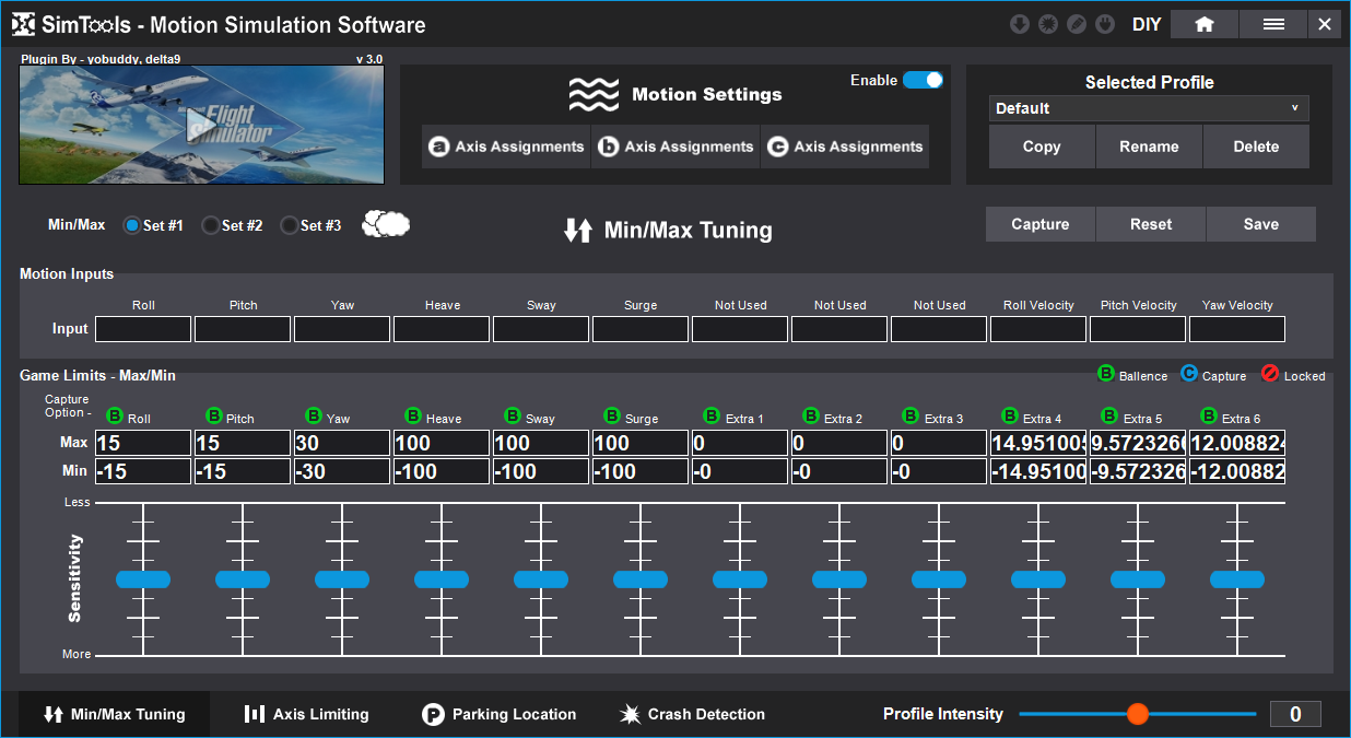

    Sounds like you need to capture some good Max/Min settings for you rig.
    And I would suggest you check each DOF in axis settings one at a time. (To make sure they are working in the right direction) Sounds like you may have something backwards.

    video scaling is 100%
    maybe...
    You had scale issues in non-English windows in the past, right? Isn't that the problem?
    There is no adjustment in the output type. Is that also a scale issue?
  3. yobuddy
    51,740Coins
    +5,205 / 19 / -0
    No, I have not seen any gui differences in different locations of windows.
    The slider is just to long with the white slider dot off the screen to the right is all.
    (the reset buttons are there also, but they are under the slider that is to long)
    The only other thing I can think of if scaling is at 100, is your DPI setting?
    What is your DPI set to?
    Is this windows 10 or 11?
    I'm going to return the sliders to the way they were earlier in the week as it didn't fix your problem.
    And then look for a different solution to the problem.
    We will figure it out one way or another...

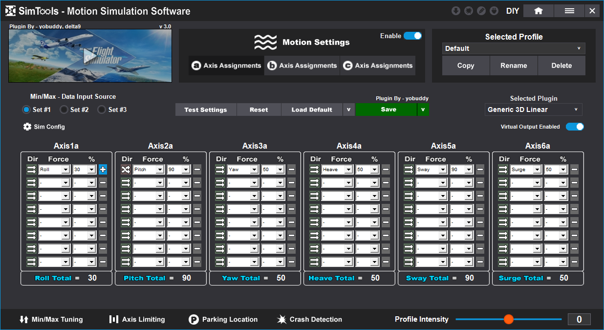

    i used..
    korean windows 10 , dpi set 100%, 7680*2160
    korean windows 11, dpi set 100%, 1920*1080
    i'm try...
    dpi set 125% to same
    150% to same
    hum... OTL...
    I don't think need to reverse the version.
    The output type is still not working, but the filter side is now scrollable.

    I asked another korean user to check just in case.
    The icons overlap, but scrollable. (update version)
    What's the ... I'm curious!!! @_@

    @Mu-KwangKim,
    Will you see if the same thing happens with the standard axis plugin?
  11. Mu-KwangKim
    Mar 14, 2012
    124
    South, Korea
    - 689Coins
    +33 / 0 / -0
    standard, basic all same.
    but
    I found a way.
    Click the load default button, the Degrees value becomes 1, and a move icon appears.
    There are still only four x icons, but I'll use them like this for now.
