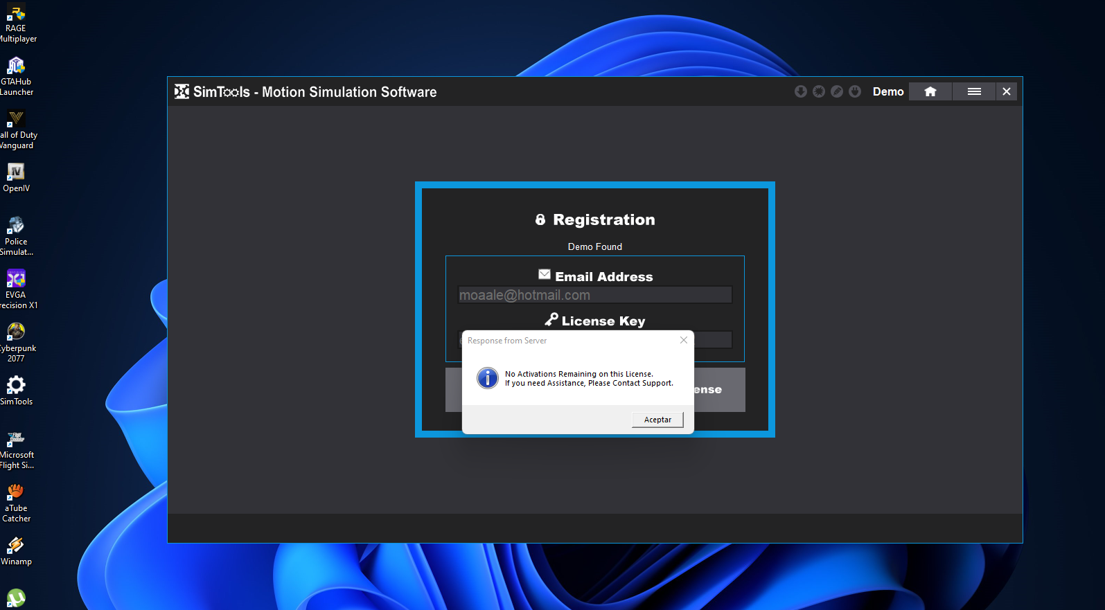

    2DOF, DC motor, SimforceGT
    sorry for changing the subject .... it may be that due to an update of simtools v3 all simtools v3 has been restarted and now at the moment of wanting to register it so that it stays in pro version it tells me that my license is expired
  4. yobuddy
    51,734Coins
    +5,205 / 19 / -0
    Please goto registration and click Activate
  5. moaale
    moaale IAN MRTIN
    Jun 29, 2011
    170
    NN
    ARGENTINA
    96Coins
    +41 / 0 / -0

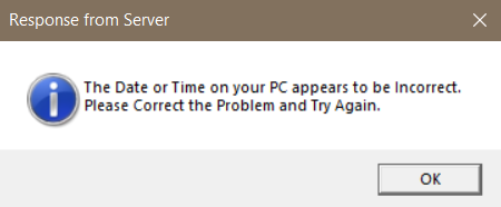

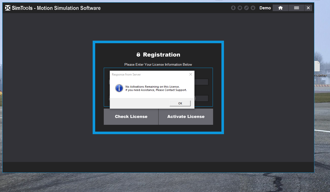

  17. Sky Field
    Sky Field New Member
    Jun 24, 2022
    - 12Coins
    2DOF, 3DOF
    Hello, I was getting the error below when first attempting to register my DIY licence. I updated simtools 2.5.3 and then it let me register v3. It was working great and i loved it. I opened it up again today and got a prompt to update simtools v3. After saying yes I am now back to the demo version and cannot register my licence. I am given the errors below again. I have tried updating the old simtools to 2.5.5 with no luck.
    Thanks for any help/advice
  18. Racer54098
    Racer54098 New Member
    Oct 28, 2021
    17
    111Coins
    +8 / 0 / -0
    Motion platform, 4DOF
    Hi, same here. I have SimTools 2.5.1 and I installed v3 beta for testing it. I was able to activate it my licence and got it working really good, I was driving with DR2.0 and with AC. Today it was updated and now I'm in demo mode again. Was it meant to be?

    The same thing happened to me today, but it activated me perfectly. Yes it gave me the same error as yours in the last update and after rebooting the PC it activated fine.
