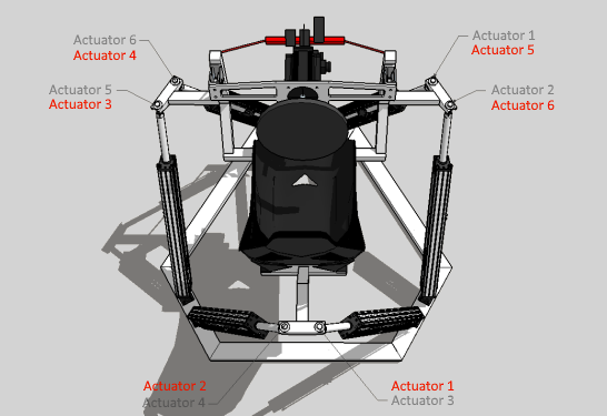

    After I installed this sequence setting, the actions of Pitch, ROLL, Sway, and Surge are all wrong, or they are coupled with each other. I can't tell what he's doing. I use a THANOS controller.

    @930175620,
    Looks like the axis output order may be wrong in the plugin.
    Please follow the Gray axis order. (Red is thano's order)
    (And I will fix the axis order pictures in the 3D axis plugins.)
    Thanks for beta testing!

  7. yobuddy
    51,776Coins
    +5,206 / 19 / -0
    Axis output order pictures fixed for both the 3d Rotating and Linear Axis plugins. :thumbs

  9. Djalma Ribeiro

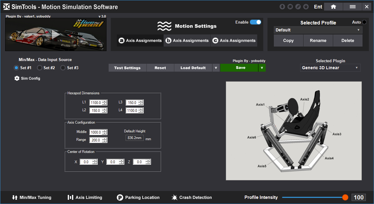

    The image of Rotating has changed, but Linear hasn't changed. ;)

    I deleted the plug-in and reinstalled it, but the image doesn't change.
  14. yobuddy
    51,776Coins
    +5,206 / 19 / -0
    Try deleting the plug-in, restart simtools, then reinstalled it.
    Let me know buddy!

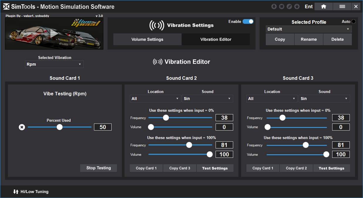

  16. yobuddy
    51,776Coins
    +5,206 / 19 / -0
    SimTools update posted with new vibe testing to avoid confusion :thumbs

    +33 / 0 / -0
    Oh. Changed.
    Plugin Remove,
    SimTools Restart,
    Plugin Reinstall.
    It has to be in the right order.
    Good job.
    p.s. But, All the settings are gone. HaHaHA~ OTL...
