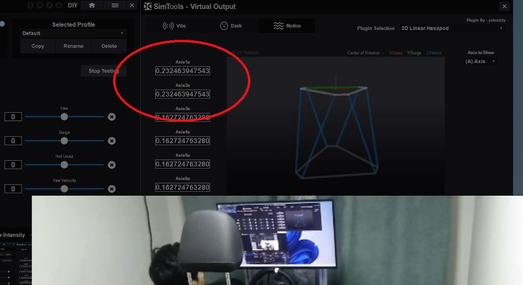

    Seems like your front left actuator has more movement that the others. (or is slower?)
    But you can tell in the video 0:45 second, that the 2 from actuators are getting the same commands.

  5. 930175620
    930175620 New Member
    Dec 24, 2022
    15
    65Coins
    +10 / 0 / -0
    When I use Flypt Mover, their speed is consistent, and each movement is normal. But using Simtools is abnormal.
  6. yobuddy
    51,775Coins
    +5,206 / 19 / -0
    No, it's working here fine.
    I did add this feature since the beginning of the beta, so maybe a re-install will fix you up.
  7. yobuddy
    51,775Coins
    +5,206 / 19 / -0
    Please close the virtual window and turn the output off in the axis assignments.
    Let me know how it goes buddy.
  8. 930175620
    Dec 24, 2022
    15
    65Coins
    +10 / 0 / -0
    I didn't understand what you want me to do, and what I need to feedback.
  9. 930175620
    Dec 24, 2022
    15
    65Coins
    +10 / 0 / -0
    When I turn the virtual window output off,front right actuator is slower then the others.
    But the movements of each axis are normal.

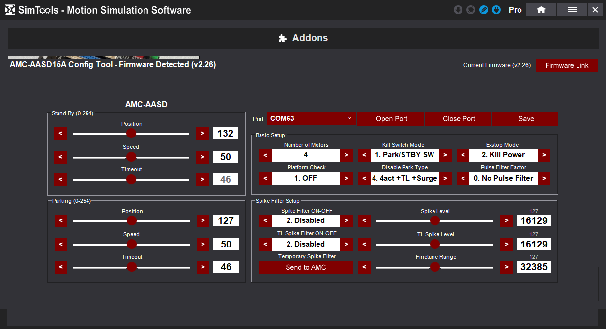

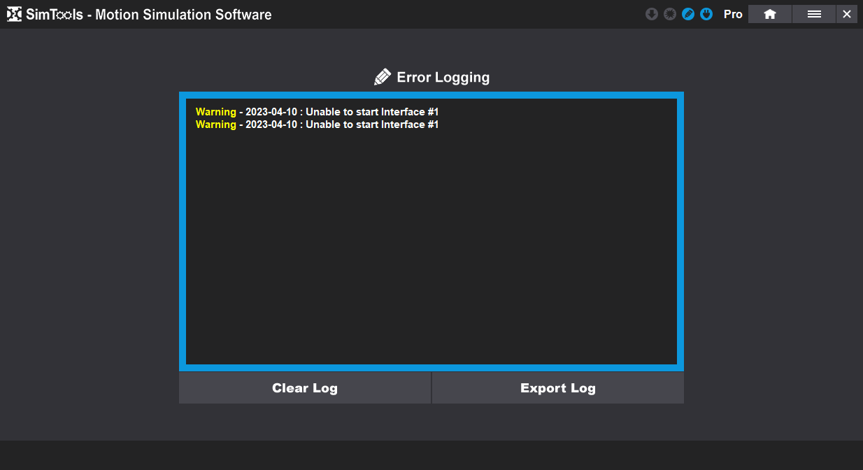

  17. Nix Park
    Nix Park New Member
    Mar 14, 2022
    7
    SW Engineer
    Republic of Korea
    - 53Coins
    3DOF, Motion platform
    I performed Test Settings during interface setup. The interface I'm using is thnos AMC AASD15A and I've installed the latest firmware. However, an error appears as shown below. Please check it out.
  18. yobuddy
    51,775Coins
    +5,206 / 19 / -0
    Please make sure you are using the right Com port, and that you have selected the correct AMC card in the interface settings.
    @Thanos,
    Has there been any changes in the newest AMC firmware buddy?
