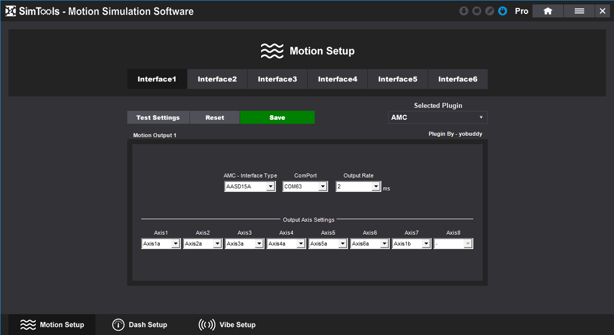

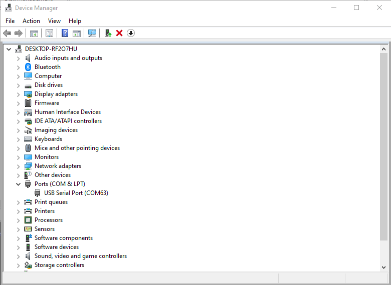

    @yobuddy, thank you for your response. I tested it again today, but the error logs are still occurring. I believe I am using the correct com port and have also selected the correct interface. Is there something that I might be missing?

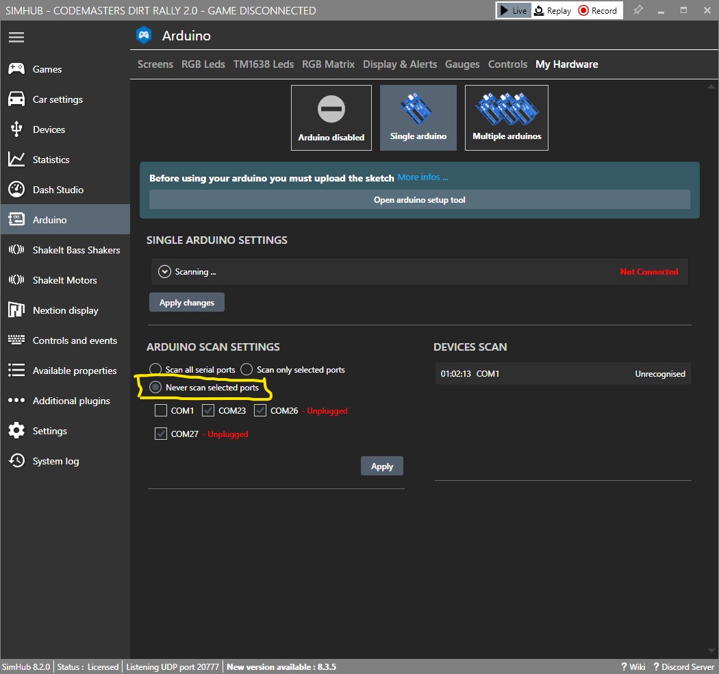

    I have the same issue few days back, it might be the com port used by another app. For example, I'm using Simhub, somehow simhub detected the motion com port, you can use 'Never scan selected port' in Simhub.
    Also for my case, because I'm using Arduino Uno. I have to change with other Uno board.

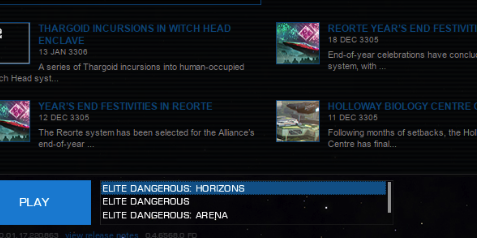

    One thing I am wondering about, and the different thing about this game vs other Steam games I am runningf is when I "start game" from Steam it actually opens a ED launcher that has it's own start game button where you have to select the version of ED you want to play. Do you also get this @Mechromancer ? Maybe this is causing confusion with SimTools?

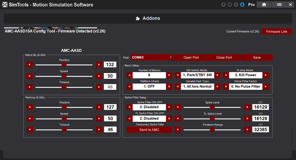

    I have installed and been using Simhub, but during testing, I only enabled the COM63 port that uses AMC for testing purposes.
    When I first used Simtools 2, I experienced a Language Setting bug that caused a similar issue. However, I was able to resolve it by changing the language settings.
    When I tried using Simtools 3 beta for the first time, it did not function properly, even after I tried changing the language settings. I suspect that while AMC and the port are connected, communication between them may not be working properly.
    What other aspects should I check to help identify the issue?

    I'm using the Pimax 8k Plus, so I launch the game from the Pimax app. It starts SteamVR, the ED launcher and the ED client all at once.
    However, every once in a while I have to log off ED for their maintenance. I log back in from the launcher that you referenced and I still get motion.
    BTW, I'm still on Horizons "classic". I didnt upgrade to Odyssey, so I don't know if there's been a recent update to Odyssey. Those updates almost always bork the motion, until @Wagnard updates the plug-in. Are you on Odyssey?

    I am on Horizons, I haven't purchased Odyssey. From the launcher I select: Elite Dangerous: Horizons, but in that list there are other versions of Elite Dangerous to select. I select that first option in my screen shot:

    Yeah, that's the one I choose.

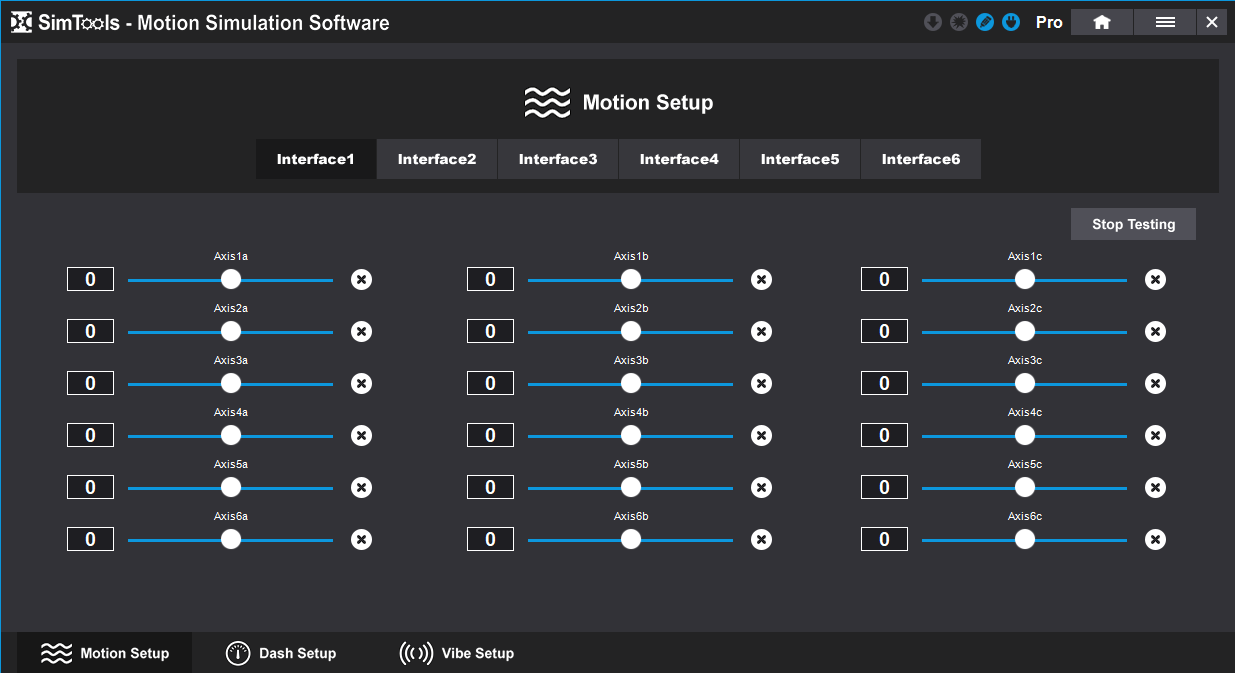

    Just another thought: when you go into the tuning center and hit "Capture", do you make sure your axis aren't "locked"? Also, once you initiate the capture, do you go back and give focus to the ED window?
    If I don't go back to the ED window, it won't generate data for the Tuning Center.

    Last I checked, my AMC is working here. (but I'm not using SimHub at all.)
    I would re-tune your Max/Min for output, as a lot of plugins have been updated.

    have you try to change the arduino tab settings on simhub As @deeph46 said?
    I had the same issues before and all I do is check every single box COM ports that I use for another devices.

    Hey man, sorry, but that option you choose is NOT the one i see. I have "Legacy Horizons". But I think @Wagnard said the plug should work for both.

    Ok thanks @Mechromancer! Just to be sure I will try the legacy option as well. Also, to your other question, I do give focus back to the game after setting capture in the min and max of simtools. I didn't notice anything related to the axis being locked. I will have another look about that though, thanks a lot man!
