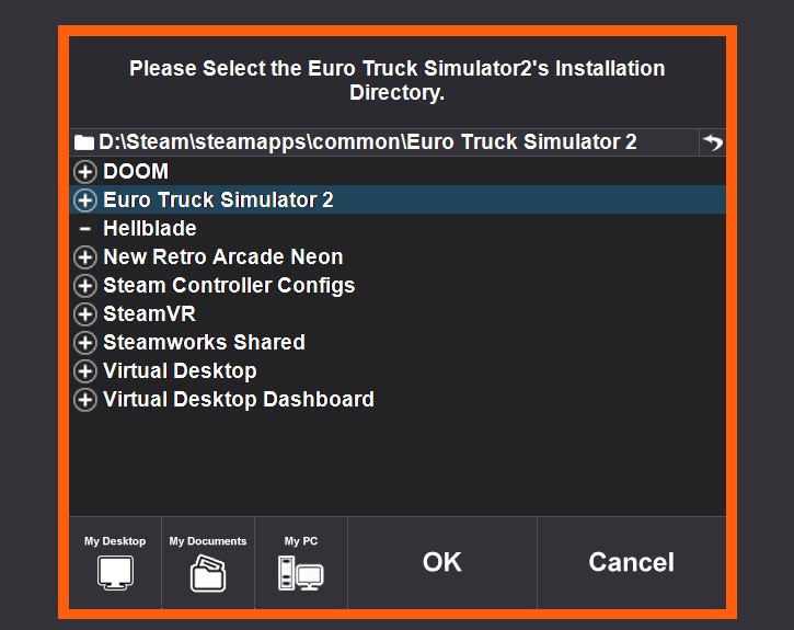

    Hello, I am trying to install the ETS2 plugin, for patching I give it D:\steam\steamapps\common\euro truck 2 folder and it keeps giving me path is not valid. Does anyone know why this is? also running Simtools3 as admin just to see if that was the issue.
    If I try to manually install by downloading the plugin and then moving it to the main window, it doesn't let me drop, the UI gives a cross icon on the mouse cursor.

    The plugin is looking for... PathSelected\bin\win_x86\eurotrucks2.exe
    Probably because your running the app as admin.

    Thanks. But I only have win_x64 directory in Euro Trucks. Does it only work for 32bit Euro Truck? I can check if Steam lets me download some branch that has that directory.

    It works with both 64 and 32 bit, has a dll for both.
    We just bought it from steam and installed it and this is the directory it setup.
    (it's also how the v2 plugin worked, so seemed to make sense is all.)
    I thought it was worth mentioning so others know running as admin will cause drag-drop problems.
    (you can not drag-drop items as admin in .net is all)
    So, do you have this path then?
    "PathSelected\bin\win_x64\eurotrucks2.exe"
    (As I can verify the needed location with it also.)

    Thank you. Yes. The new distribution that I installed fresh today, only comes with win_x64 directory and the path above. If I change that to win_x86 temporary, the plugin installs and puts the telemetry DLLS to both the X64 and X86 branches.
    I think it will really help newcomers to check for that path as well, yes.

    Cool, we will update the plugin!
