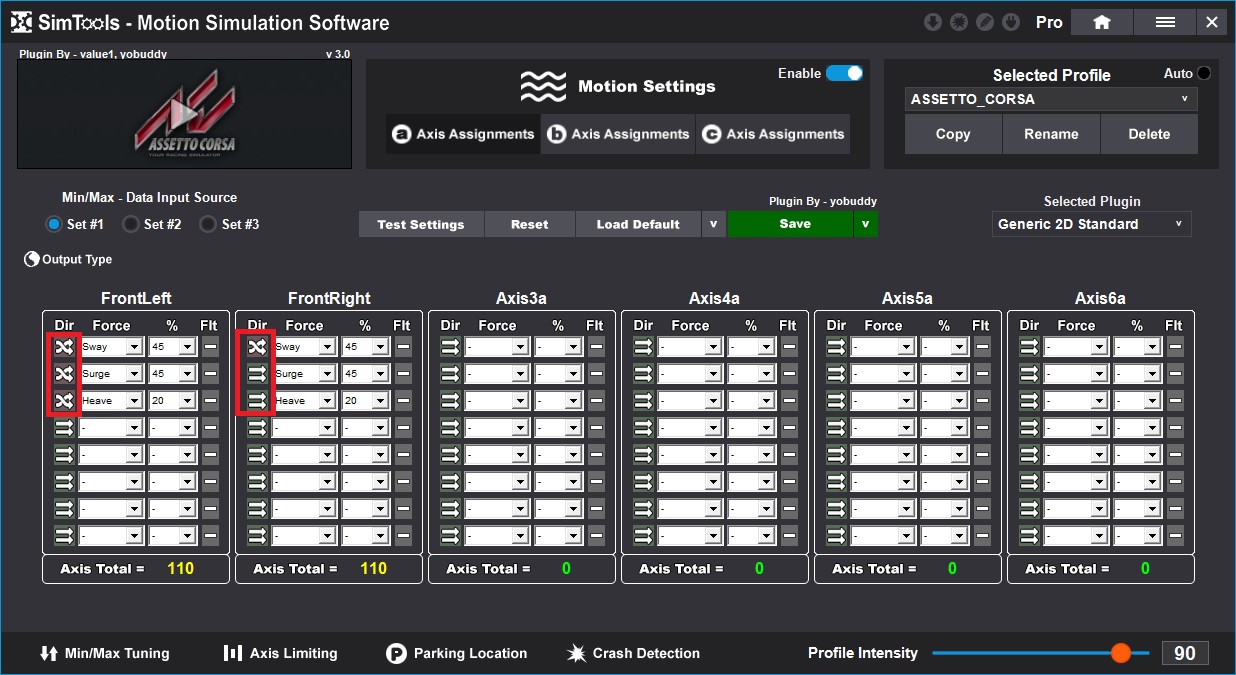

    So, I'm a little disappointed....that I didn't ask for help earlier. These settings are great! Thanx @yobuddy!
    Only thing was that the directions on my rig, for some reason, are backward:
    sway is ==
    heave is =x
    surge is =x
    Once I ironed that out, the ride was awesome.
    Just one question: would using PITCH be detrimental? On the track I'm racing on, there's a ramp leading in and out of the pit. When I was using PITCH, going up and down the ramps pitched the chair nicely. Now, I get a small heave (bump) when I hit the ramp, but that's it.
    Thanx @yobuddy, those settings are darn good.

    2DOF, DC motor, SimforceGT
    Mr. Yobuddy, the order of the movements would have to be those or they are indistinct in the photo....
    sway
    arises
    hello
    I have them like this
    arises
    sway
    heave.
    Or would it be the same?

    Mechromancer, could you put another photo of the settings?

    Sure, give me a couple.

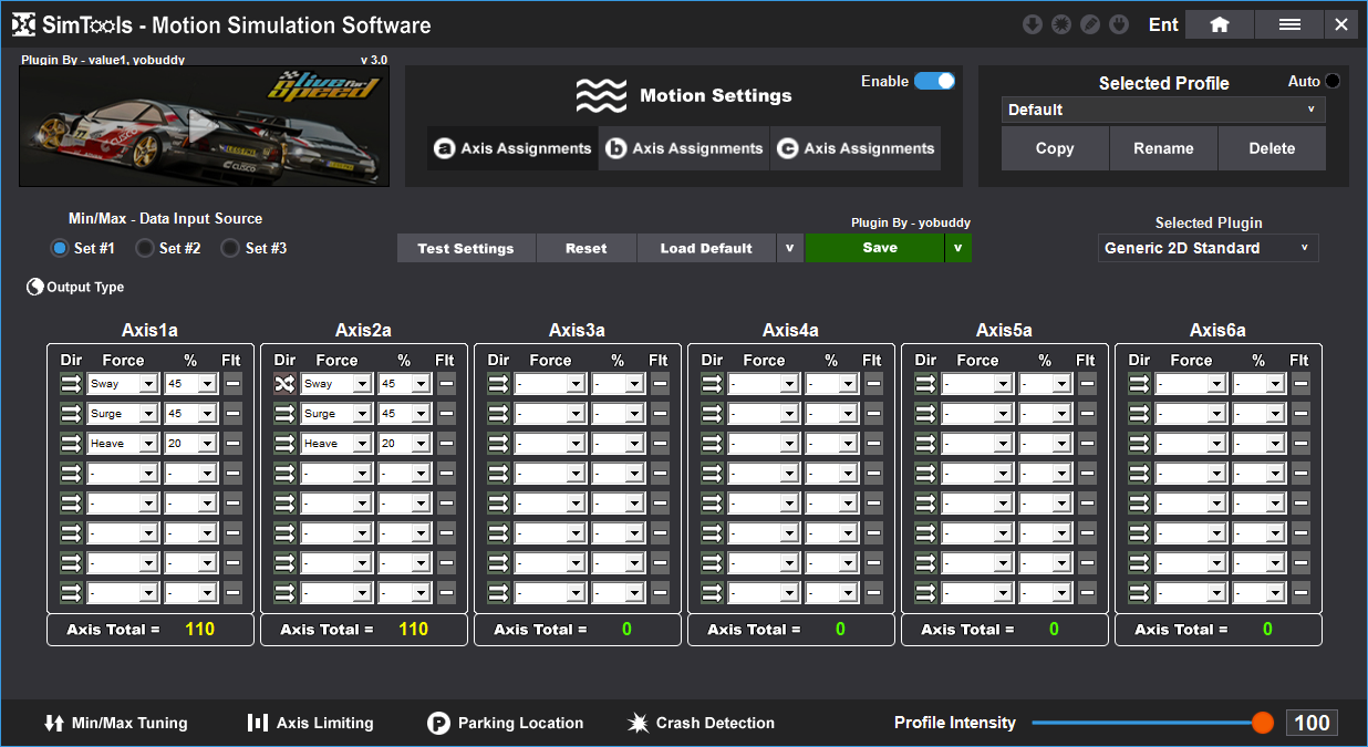

    You will probably have to reverse the directions of the axis (in the red boxes).
    I just remembered that the guys at DOR Reality had me reverse the polarity on my motors when I did the SFU gear upgrade.

    Son motores. La aplicacion permite cambiarle el nombre a los ejes. "FrontLeft" es Axis1a y "FrontRight" es Axis2a.
    They are motors. The app allows you to change the axis names. FrontLeft" is Axis1a y "FrontRight" is Axis2a.

  8. yobuddy
    51,773Coins
    +5,206 / 19 / -0
    Awesome! :thumbs
    Interesting, so the motors are both on one side of the sim?
    One in front and one in back?
    No, it's ok to use.
    Maybe lower surge 10% and then add 15% to pitch.
    Remember thou that pitch is just the degrees the vehicle is sitting on the track, where surge will give you a lot more feedback from your actions. (gas peddle and break for example.)
    (you may also want to try turning on the washout filter for pitch, setting the gain and return to 1)
    Take care,

    There's a foto a little bit further up in the thread. But this is the model:

    It's a standard DOF H2. But just like an hour ago I remembered that the guys at DOF had me reverse the polarity on the motors when I did the SFU upgrade. That's probably why I'm backwards. ;)
