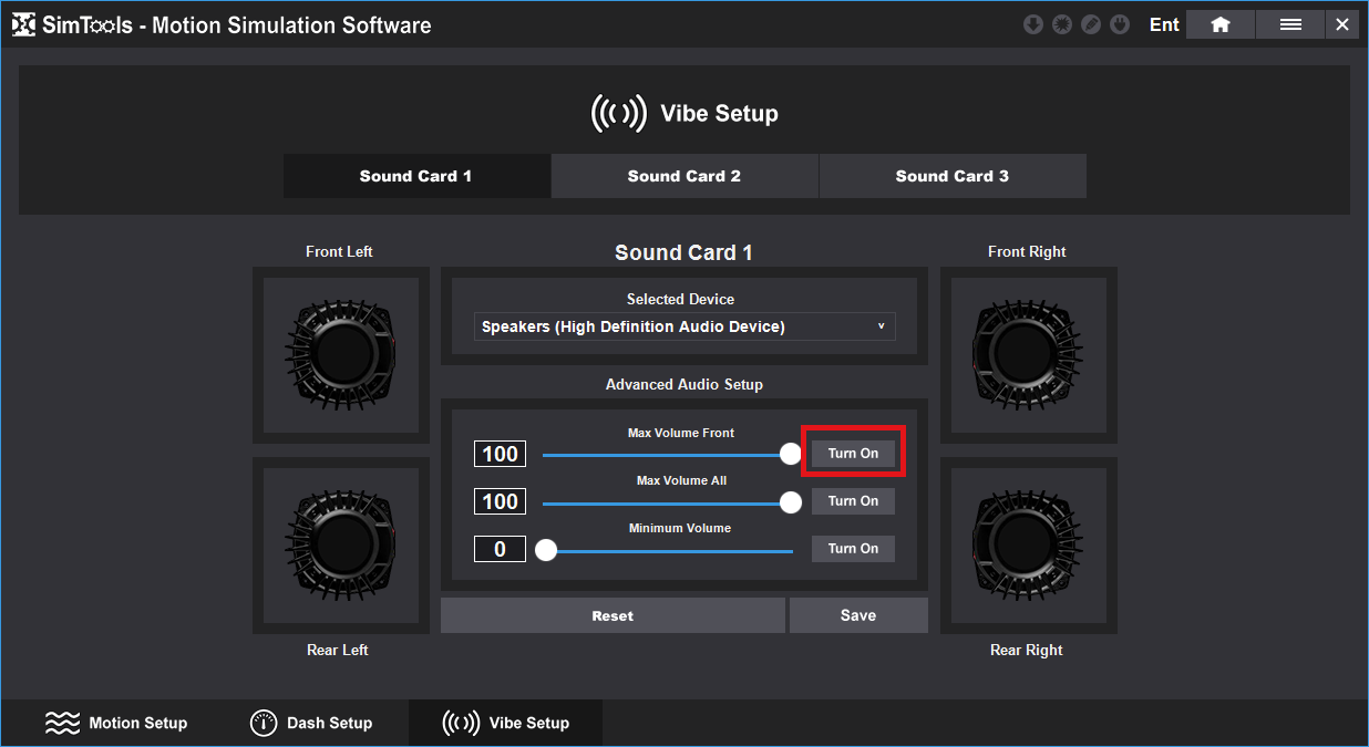

    I'm still testing console plugins.
    i have a problem with the gran turismo 7 plugin.
    Motion works, but i have select higher value for the movement - in total 204 for good movement.
    when i activate the vibe and make settings simtools crashes.
    In taskmanager simtools.exe is closed.
  5. Juan José Zurro Gallego

    It's better to logically set the axis assignments to between 100 to 120% total usage, and then simply adjust the Max/Min values for the plugin. You will get a better ride this way.
    I would have to know which vibe input is the problem.
    (since I did not create the plugin itself, we will have to contact the plugin writer and let him know the problem.)
    (may be worth figuring out how to re-create the problem first thou._

  10. Moppi07
    Moppi07 New Member

    which input is used makes no difference.
    I test rpm road details,
    the test of the settings leads to a crash of simtools
  12. yobuddy
    51,773Coins
    +5,206 / 19 / -0
    And the Interface page, where you first configured what sound card to use, does the test work there?

  17. Moppi07
    Moppi07 New Member
    Mar 28, 2020
    15
    - 4Coins
    2DOF, JRK
    Hi yobuddy
    I did the test you showed me and funnily enough simtools didn't crash anymore.
