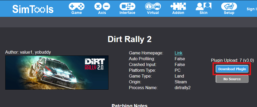

    Yes, I know I can't use plugins for v2 in v3. But the zip I downloaded was "upload 2 (v 3.0)" , uploaded
    2023-03-21 13:08:13 --- Update v2 --- Corrected Roll, Roll Rate, Pitch, Pitch Rate and Sway directions.
    according to the changelog.
    I hope this is the right one for v3.

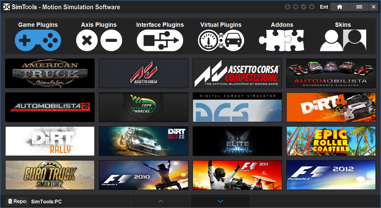

    For offline users, you can download a v3 plugin from it's data page and then drag drop it right into SimTools v3.
    What @noorbeast is mentioning thou, is if your online @Michael Pleym, then you can install the same plugins directly thru v3. (look to the lower right of the main screen, plugin manager)
    Simply hover and click one to install.
    Take care!

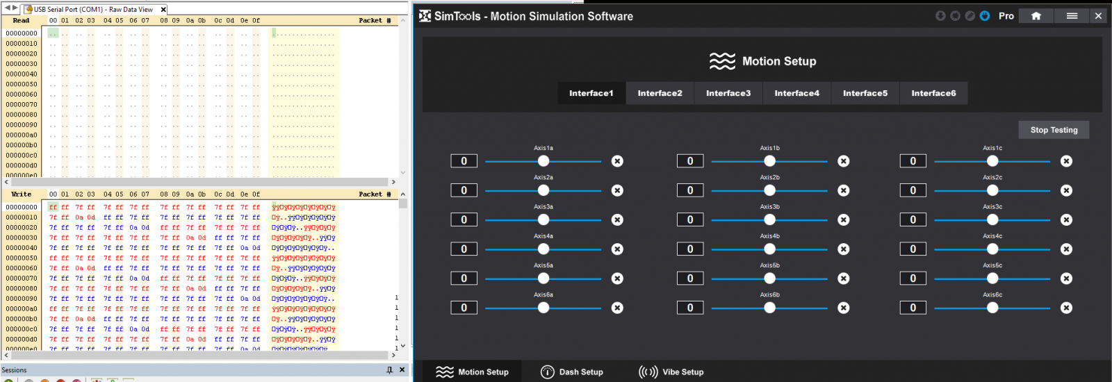

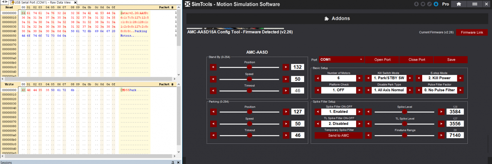

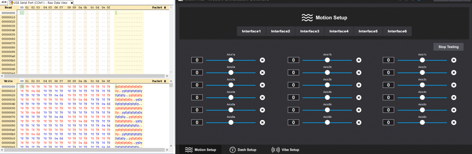

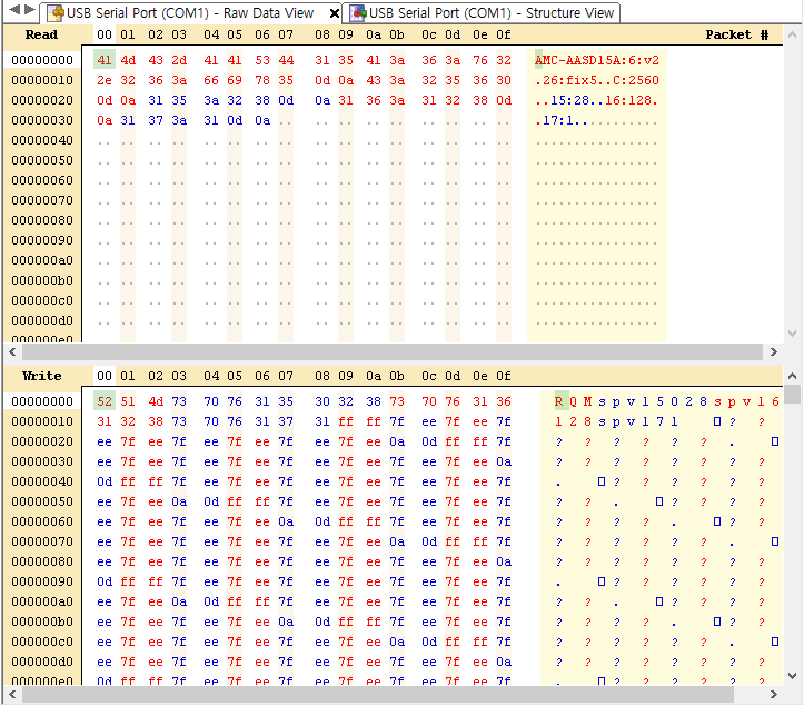

    @yobuddy,
    I apologize for bothering you repeatedly.
    However, I have conducted some tests to verify an issue with properly controlling the Thanos AMC using Simtool V3.
    To get straight to the point, Simtool V3 is not correctly sending data through the COM Port. I have verified this using a program capable of capturing COM Port communication.
    For the first test, I performed the Thanos controller motion test.
    (https://github.com/tronicgr/AMC-AAS...ster/Thanos-utility/Thanos-motion-test-simple)
    During the initial execution, the data was correctly sent and received, and the motor control values were being updated regularly.
    (Please refer to image 1)
    When running the 'AMC-AASD15A Config Tool' from the 'Addons' in Simtool V3, the data is sent and received correctly.
    (Please refer to image 2)
    However, it seems that incorrect values are being transmitted when performing 'Test Settings' in the 'Interface Setup' of Simtool V3. Shouldn't the motor control values be two-byte values with 0xFF 0xFF for normal operation? It seems that the issue starts from the 0x79 0x79 part.
    Additionally, the message "Connected >>> Motion data.." does not appear on the Thanos AMC.
    (Please refer to image 3)
    It seems that there is an issue preventing proper communication with the Thanos AMC.
    Can you provide any assistance or suggestions?
    Thank you in advance for your help.

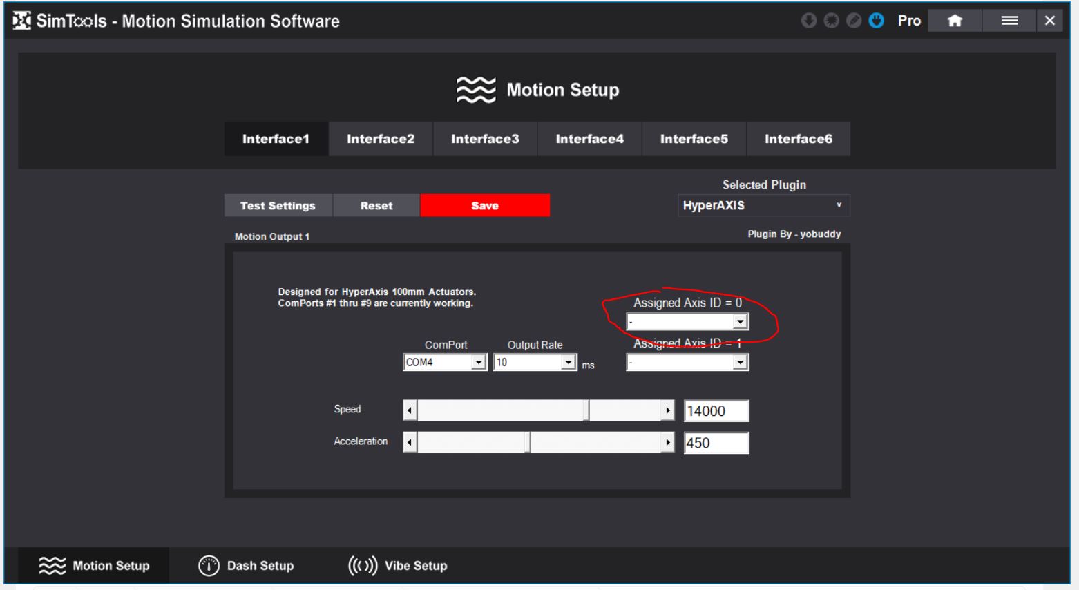

    Hey, i have an Problem with the HyperAxis Configuration, after Restart the Axis dont be saved, how can i fix it ??
    i have still save it before Restart

    @Nix Park,
    The same interface plugin is used for the config tool and interface testing.
    So they should both work, or both not work i would think.
    I will take a look this weekend thou.

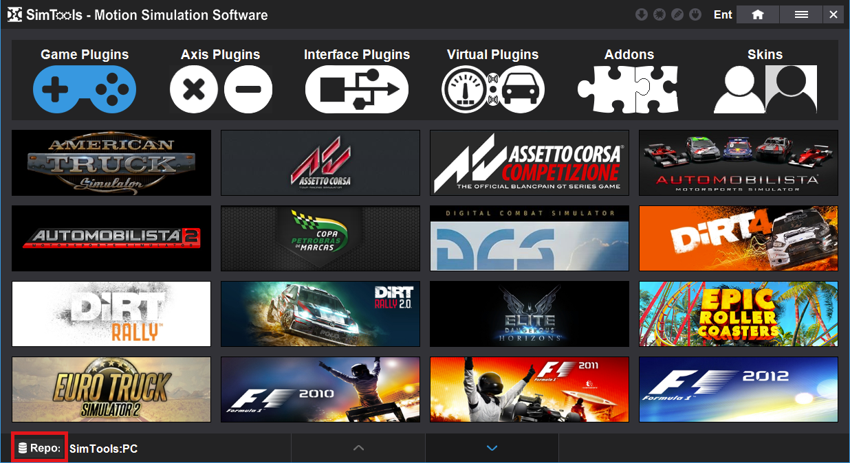

    Thanks for your explanation. Seems to be sth wrong with my installation of Simtools v3, because I don't have the DCS banner automaticly pop up in the plugin manager menu when I look there for it. I will try to do a reinstallation of the software and see if there will be any changes.
    Regards

    Maybe your in a different repo?
    Take a look in the bottom left of the plugin manager page, notice there is a button to change repo's.
    Maybe it does not say SimTools: PC?

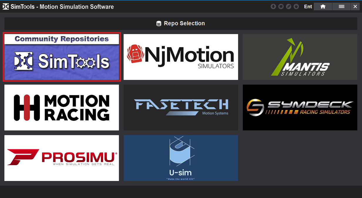

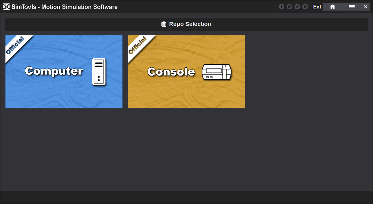

  10. Michael Pleym
    Michael Pleym Member
    Apr 25, 2023
    40
    258Coins
    +8 / 0 / -0
    Thank you yobuddy once again for your suggestions.
    No, it's not saying "SimTools: PC". It's saying "NjMotion Compact-R". And when clicking on it I come to the NjMotion Compact-R setup. Seems to me this is correct, no?
    //Michael
  11. yobuddy
    51,773Coins
    +5,206 / 19 / -0
    So you are in the NjMotion Compact-R repo is all.
    But you are free to change repo's, with the little button on the left.
    Select SimTools Community Repo.
    Then select the computer repo (blue one)
    And your free to change back at any time.
    Be aware that the plugins in the NjMotion Compact-R repo may come all pre-setup for you, where the SimTools PC repo will require manual setup.
    Take care!

    @Sin.Schumi,
    There is an updated HyperAxis plugin loaded to the server.
    Please let me know how it goes.

  14. Nix Park
    Nix Park New Member
    Mar 14, 2022
    7
    SW Engineer
    Republic of Korea
    - 53Coins
    3DOF, Motion platform
    @yobuddy,
    Thank you for looking into this.
    One thing for sure is that it works properly when changing the region and language settings to "United States (English)" as described in the link below:
    https://www.windowscentral.com/how-properly-change-system-default-language-windows-10
    I am sharing a screenshot of when it is working properly.
  15. yobuddy
    51,773Coins
    +5,206 / 19 / -0
    Has to be a ascii table region change problem as it's all I think of.
    Fortunately, I built v3 with this fix in mind, so there is a few things I can try.

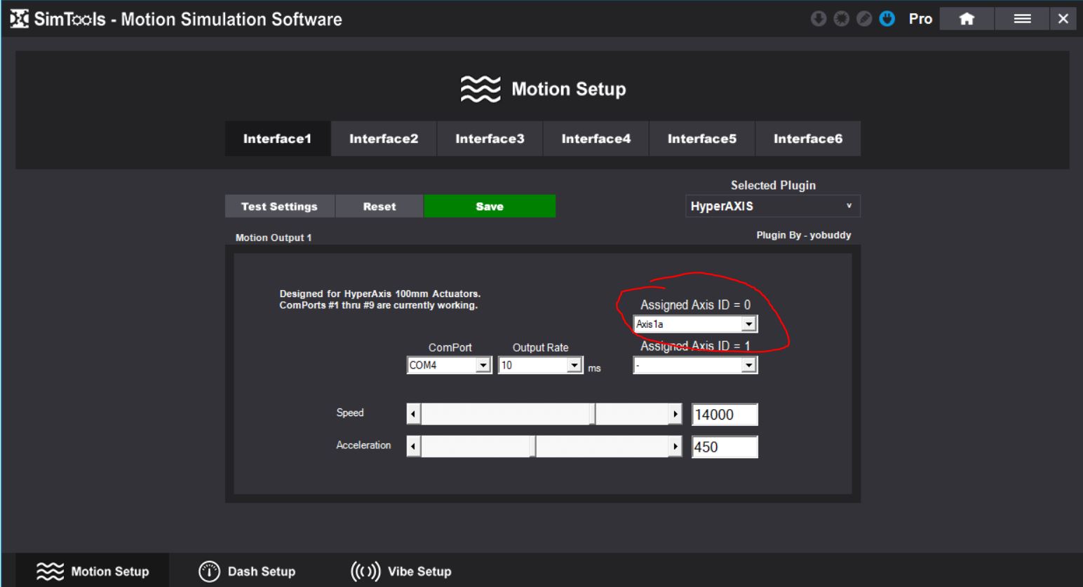

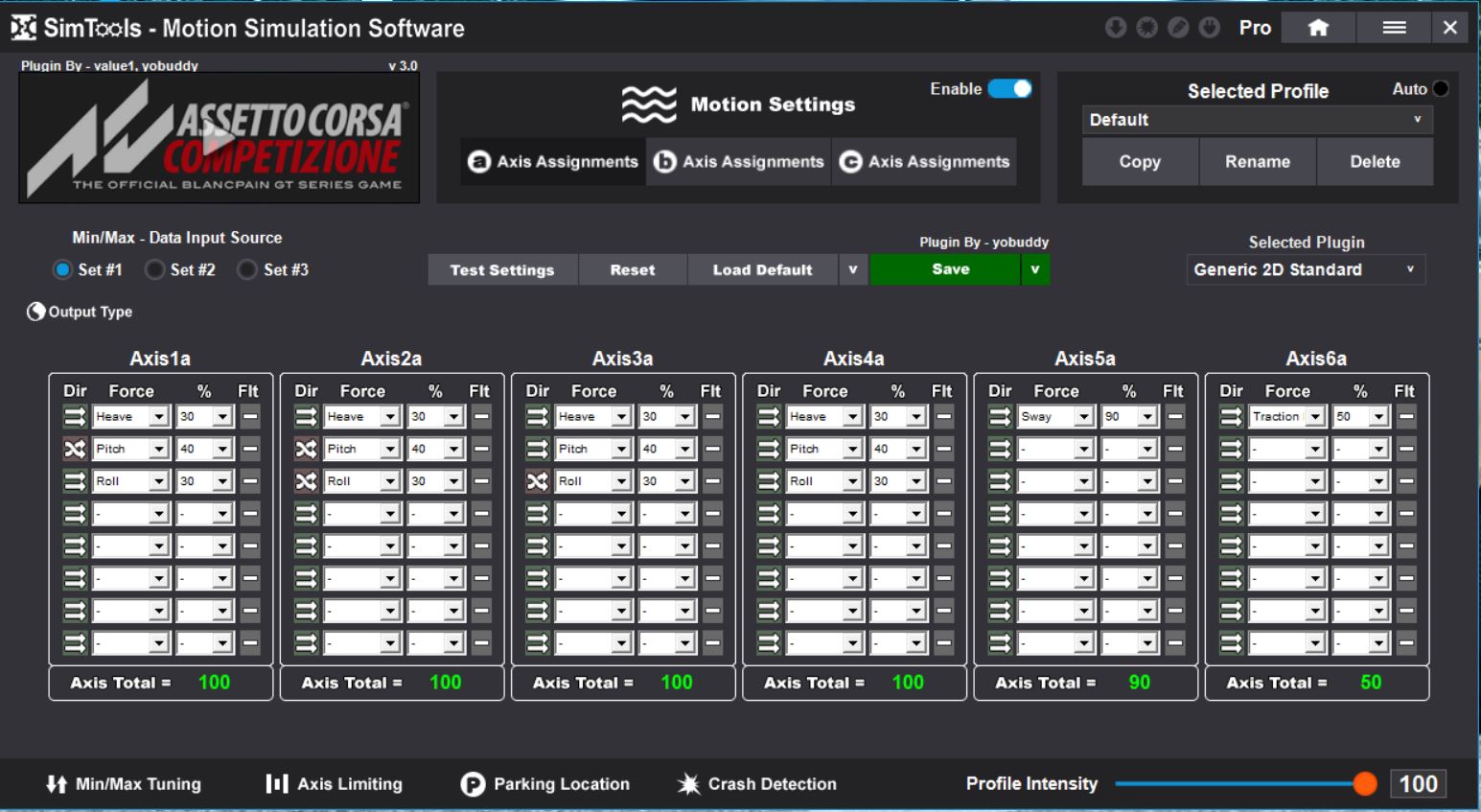

  16. Sin.Schumi
    Sin.Schumi Member Gold Contributor
    Aug 2, 2015
    44
    - 18Coins
    +8 / 0 / -0
    SCN5
    Thx, the Hyperaxis work now... After Configurate my Axis on Test its ok.
    Try ACC ingame there is no Movemt only Stutering, Is my Configruation so ok ??
    Had the Settings from Simtools 2.5 with MaxMin Settings..

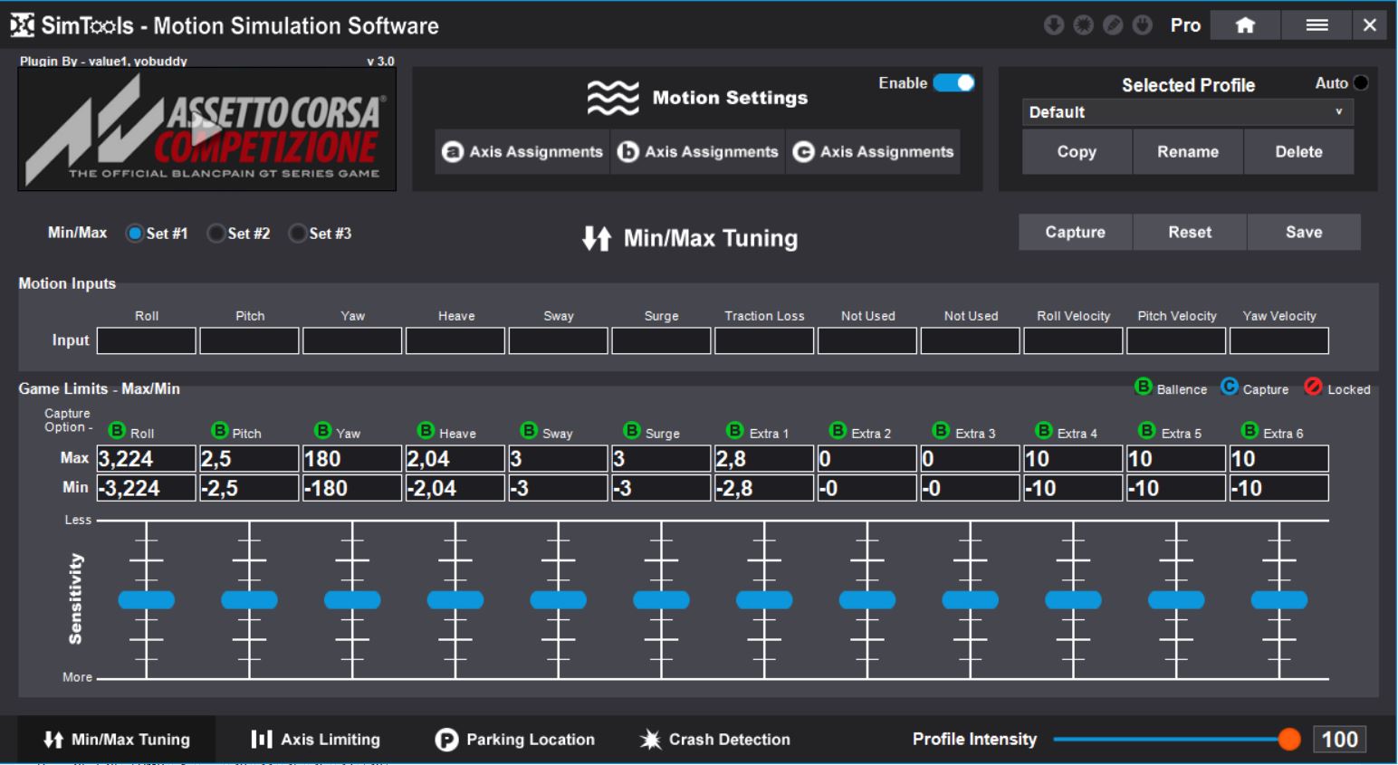

  17. yobuddy
    51,773Coins
    +5,206 / 19 / -0
    Try capturing new max min values as not all plugin from v2 are 1:1 in v3.
    While on the track, click 'Capture' then 'Reset', and then drive a lap without hitting a wall and click 'Save' and then 'Stop'.
    You may also want to try enabling only one DOF at a time to see if its working.
    Like just enable pitch and see how it works.
    It could be that one of the DOF direction is different than in v2.
    btw, for the first 4 actuators, I would replace the roll assignment with sway and pitch with surge.
    This way the sim will react to you inputs a lot better.
    Take care!
