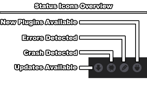

    Not quite sure what you mean by plugin page, could it be one of these status icons?

    Yes that's it, errors detected.

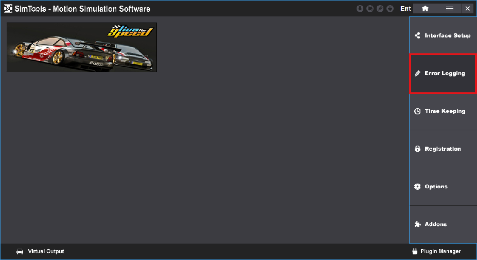

    This is a notice that you should take a look at the error log.

    Nearly all problems can now be captured by the error log, so it should let us know what happening.

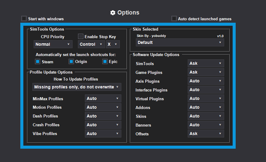

    SimTools close itself just after hitting play
    I don't know what is happening, just downloaded F1 22 plugin and SimTools just closes after hitting play to F1 22 (playing in steam).
    Reinstall SimTools, Steam, F122, even reinstalled windows 10 ... nothing seems to work.
    Will appreciate a lot if someone has a solution to this :(

    No, no sound nor error message... it just closes.
    I've been doing a lot of tests: Change USB cables, change ports, reinstall SimTools, Reinstall windows, reinstall steam, run the game first and then simtools, run the game within simtools by hitting the play button, check/uncheck auto detect option in SimTools, update drivers, deactivate windows defender, test with F1 and Assetto Corsa. Everything with two different computers and the result is the same everytime.
    Simtools closes itself 2 sec after the game starts... running out of ideas :(
    Attaching photo of the simtools settings

    Try disabling your firewall ;)

    Yes... that was the problem ! Just disabled the firewall and everything runs smoothly, thanks !

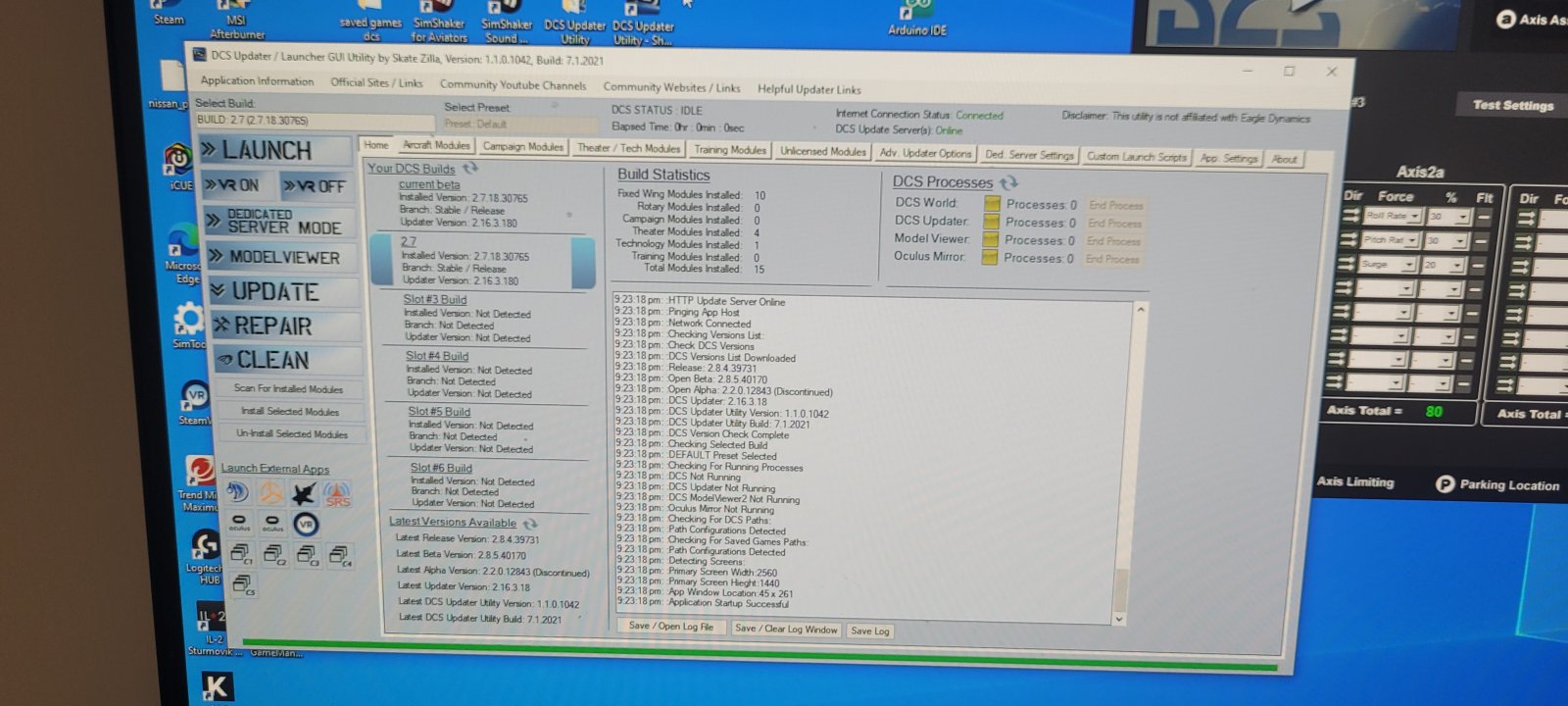

    Hi guys
    Please bare with me,I have successfully installed and configured v3.
    I get the expected response now from testing.
    My question is this,I get no input from the game DCS world.
    I have a feeling the game path is wrong.
    I use an utility by skatezilla which allows different builds to be chosen also vr or not.
    So it's not just a shortcut from the desktop as it were.
    Sorry but this is the one part i am really struggling with.
    I have enclosed a pic of the app.
    I believe this is the issue.
    How do I delete any path that is saved in the dcs plugin.
    Any help would be greatfully received.
