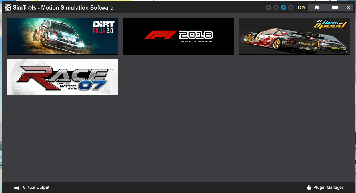

    Hello everyone, I installed licensed simtools v3.0 beta and encountered problems with the telemetry of 2 dirty4 and wrc10 games, other games work regularly, the plugins are installed.

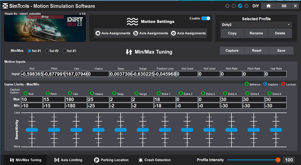

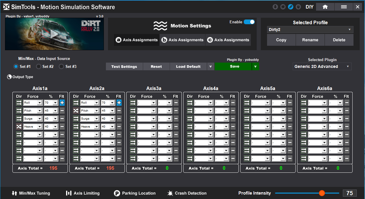

    Sorry I expressed myself badly, I meant that I don't get any movement. I am attaching a couple of photos of the configuration, of how the more I have the less I have also made other games. The interface and serial I use arduino with monster board, I hope I explained myself thanks.

    You have what seem to be very high Axis Allocation totals, and low intensity settings.
    Can you please post a picture of your Min/Max Tuning while the game is running.

    Looks to me like you need to have some sensible Axis Allocations and then capture the Min/Max values in the Tuning Center. The telemetry data is there, the motion profile just needs refining.
