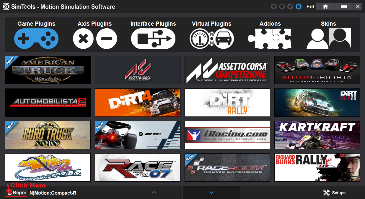

    @offman,
    We will make one for v3 for sure, probably not for v2, as we are trying to wrap up v3 at the moment.
    Have you tried the NjMotion Compact R repo for v3?
    The repo has a One Click Setup plugin available, and a pre-configured F122 plugin available also.
    (Meaning all you have to do is install the setup, then the plugin, and click play.)
    You can get to it with the lower left button found here.
    Take care,
