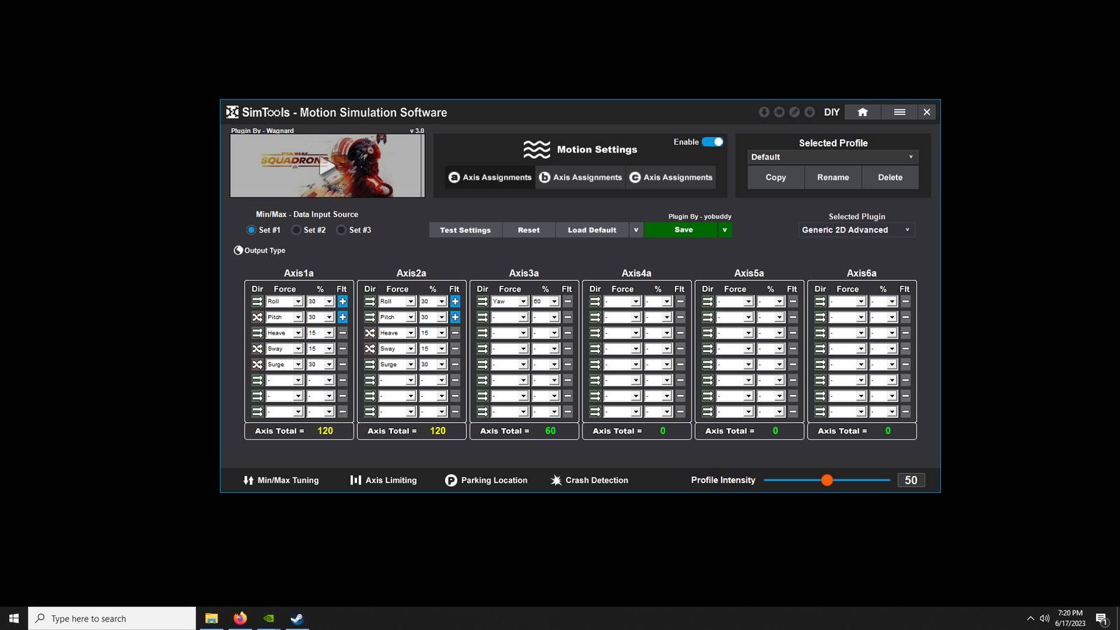

    I’m working through it. I followed the following advice and I am able to get values in Min / Max settings. But I haven’t gotten motion on the rig yet. I’m still reading though so I’m hopeful to work it out.
    So I’m getting telemetry into Simtools 3 but the motion isn’t working.
    EDIT: I have gotten everything working in v2, online and with EAC installed. Works great. But cannot understand what I’m doing wrong with the v3 beta.

    On the Max / Min Tuning page, the page you can see your getting game data, do you have some captured values in the lower part of the page? Got a screenshot maybe?

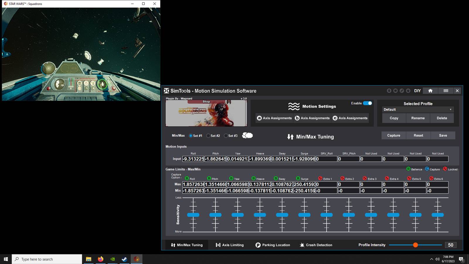

    Values are coming through and I have re-captured and saved them multiple times after trying various settings changes. Image shown was after saving. I would assume the tricky part is getting the data in, which is working fine. Just no motion.

    Thanks for the pic's, looks right to me.
    Can I verify that when you click 'Test Settings' in pic #2, you are able to move the sim around?

    +65 / 0 / -0
    Yes it moves as expected. When I launch the game and start motion it also kicks into position like it is ready to go.
