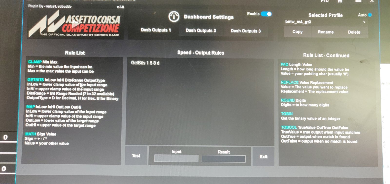

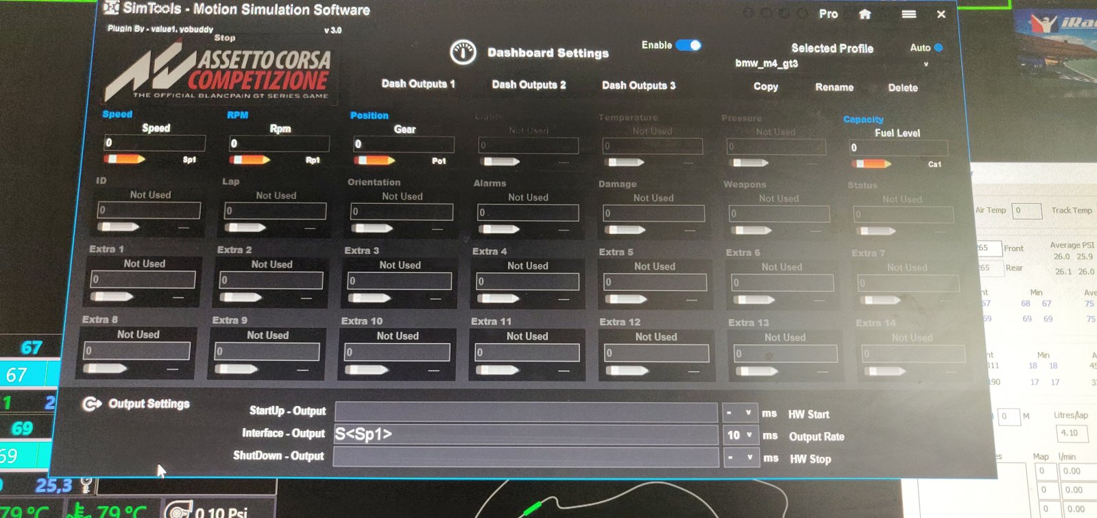

    After many attempts, I have now managed to get Simtools to show me the values in Dash and Vibe, but not in Motion.
    Then I want Dash to show my fans at the correct speed. Unfortunately this does not work, only full throttle when Simtols is connected to the Arduino.
    Are there any tips?
  2. yobuddy
    51,773Coins
    +5,206 / 19 / -0
    What motion interface do you have configured?
    The GetBits command is only looking for a input between 1 and 5.
    Try this, GetBits 0 100 8 d.
    Chat soon :thumbs

    @Neo_One,
    What sketch are you using buddy?
    Then maybe I can see what is needed for input is all.
    Since we are sending data as decimal, the output number jumps from 1 char to 3, like the difference in the output value length between output 6 and 106.
    So maybe add a Pad 3 0 command below the "GetBits 0 100 8 d" command.
    Chat soon :thumbs

    Hello, So I use the sketch
    Just tested with the "PAD 3 0" unfortunately does not work either

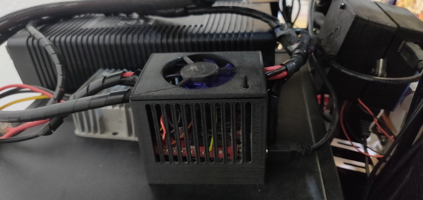

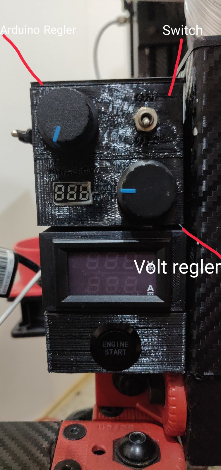

    But I only posted this sketch a week ago?
    Can I see a pic of your hardware?
  17. Neo_One
    Neo_One Member Gold Contributor
    Oct 20, 2017
    34
    Obersulm
    198Coins
    2DOF, AC motor, Arduino
    I have been using it like this for about 4 years.
