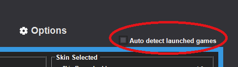

    Since today when I start f1 23 or automobolista via steam simtools v3 stops
    I believe there is a problem between the steam update and simtools.. suddenly no more movement.. no more vibrations..
    if I reinstall simtools, I lose all my settings I suppose?
  18. yobuddy
    51,775Coins
    +5,206 / 19 / -0
    @offman,
    Please uncheck "Auto detect launched games" and see how it goes.
    Simply double click the 'play button' for either game. and see if it now works?
    Please also try un-selecting your sound cards, and then setting them back and hit save.
    Please see if this might be the problem.

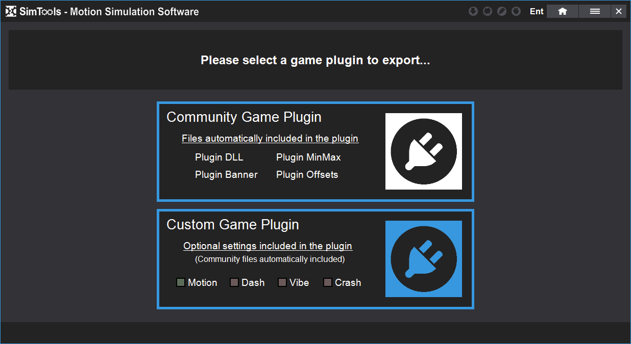

    To do a simple reinstall, goto Options, then Export Wizard.
    1) Now export a setup plugin.
    2) Now export a f1 23 and Automobolista game plugins,
    Choose Custom when asked (you can also add your Dash, Vibe and Crash settings if used)
    Now after SimTools is reinstalled, Simply drag-drop your setup file into the main gui of simtools.
    The drag your game plugins into the main gui one at a time.
    You should now be all re-setup and ready to click play!
    Let me know how it goes,
