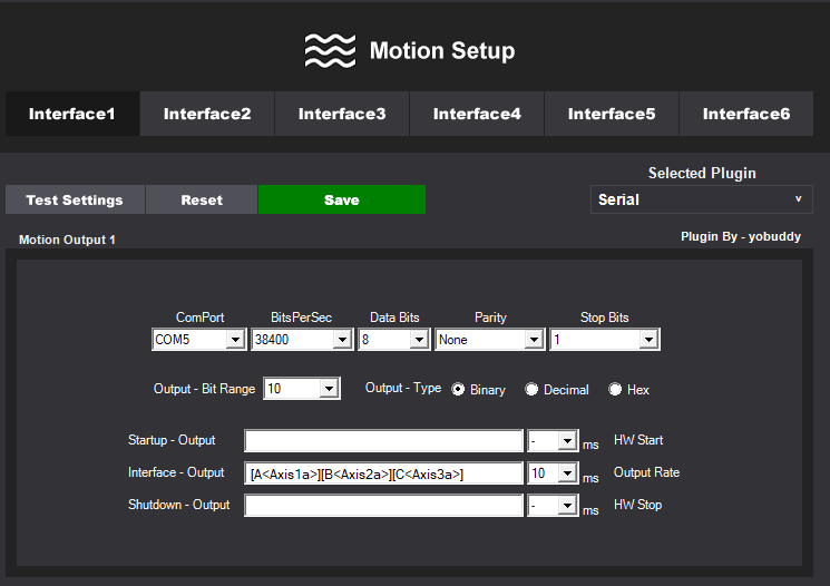

    BTW, the Output Interface command is [A<Axis1a>]. What is the A capital refer to?
  4. yobuddy
    51,775Coins
    +5,206 / 19 / -0
    All the motion related stuff is in the motion section.
    I'm guessing your referring to the SMC3 sketch for the Arduino? [A<Axis1a>][B<Axis2a>][C<Axis3a>]
    If so, its how the sketch inputs data is all, with the 'A' referring to motor one, B is motor two and C is motor three.

  7. deeph46
    deeph46 Member
    Mar 17, 2023
    117
    641Coins
    +16 / 0 / -0
    2DOF, 3DOF
    Yes, I'm referring to that command. Thanks for the info, it's clear now.

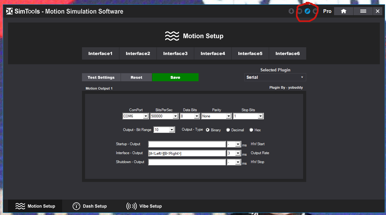

  14. MR Fast
    MR Fast New Member
    Jul 30, 2023
    32Coins
    3DOF, Arduino
    I will start with, I know I missed something, but I cannot figure out what. I built my rig and it is driven with an arduino. I have seen similar problems to mine in the forum, but none of the answers seem to fix my issue. I downloaded LVS to help diagnose any issues (ultimately GT7 via playstation is my goal) with either game, I can see the telemetry move in Simtools, but no motion output to my rig, not even in testing. (works fine in SMC utility) Game seems to grab the com port for the arduino, but provides no information to drive it. I have downloaded and configured serial interface and axis assignments. What am I missing????
  15. yobuddy
    51,775Coins
    +5,206 / 19 / -0
    @MR Fast,
    Please make sure the SMC utility is not running, then goto your interface settings for motion and click "Test Settings". Does it work?
    If not, can I get a screenshot of your interface settings.
    Chat soon,
  16. MR Fast
    MR Fast New Member
    Jul 30, 2023
    32Coins
    3DOF, Arduino
    SMC is off, rebooted to make sure...test settings does not work, here are my settings.
  17. yobuddy
    51,775Coins
    +5,206 / 19 / -0
    Please set the BitsPerSec to 500000 and it should work.

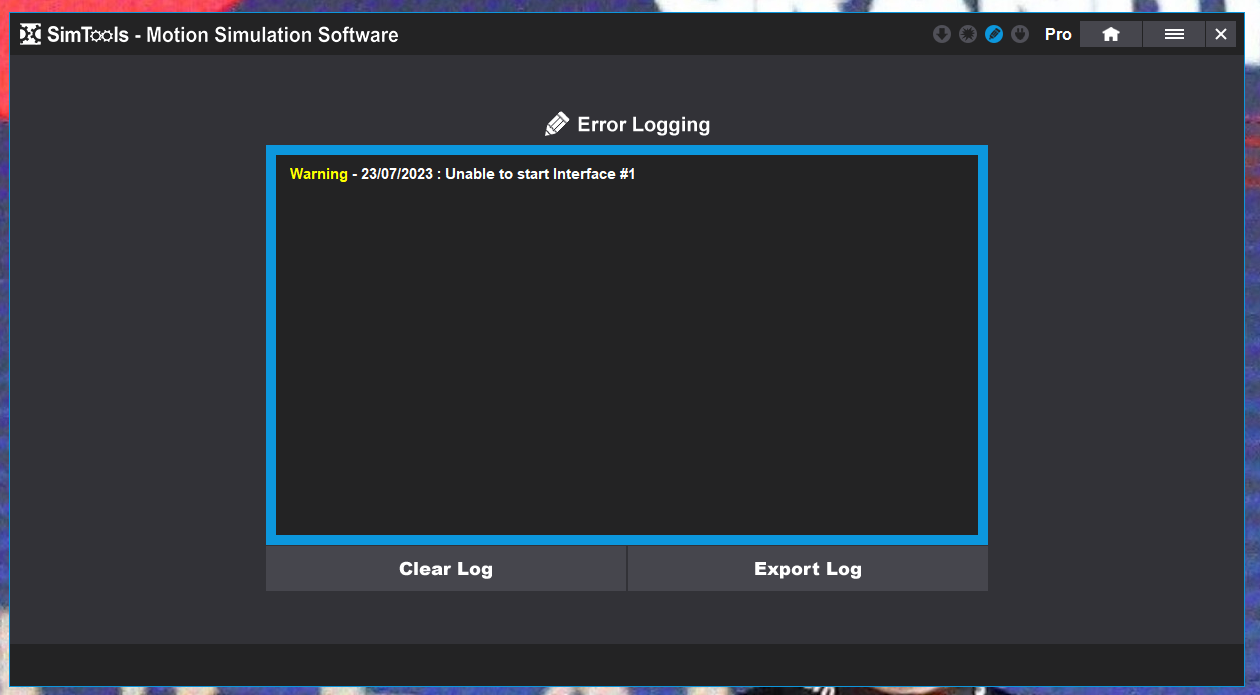

  18. MR Fast
    MR Fast New Member
    Jul 30, 2023
    32Coins
    3DOF, Arduino
    now I get an error message, "Unable to start interface" I did have that at times prior to the change we just made. Shut it all down and started back up and it worked with the interface test settings..... went to LFS and it is working in the game too...... now to work on my axis settings....... Thanks a ton!!!!
