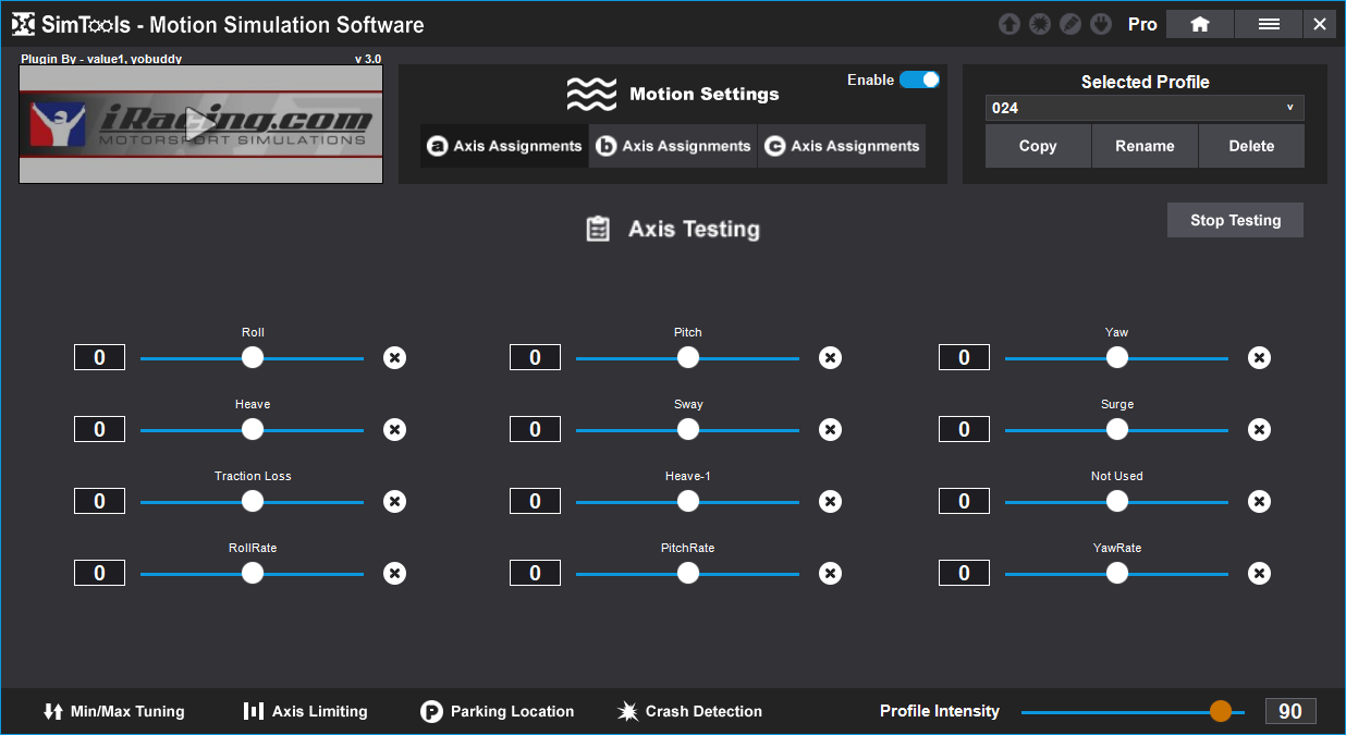

    This is a minor problem.
    Select "Test setting" during the game to display "Axis Testing".
    Next, move the "Axis Testing" slider to check the operation of the actuator.
    After that, when you press the triangle button on the top left (start operation), the screen freezes.
    "Stop testing" also has no response.
    "Stop testing"
    If I forget to press , I restart V3 every time.

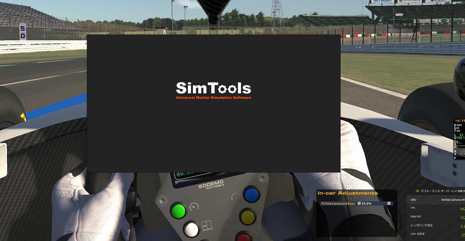

    When you start simtoolsV3, it will be displayed in the center of the active screen.
    This is a problem while driving, so please make the screen smaller or save the display position.

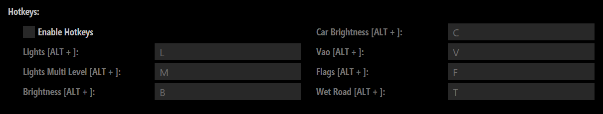

    Hi, are there any hotkeys to adjust on the fly current profile intensity?

    Hi, I have a problem with movement. Recently I wanted to play after a period , but I noticed when I was doing a surge and pitch test the motors have different speed what before was an equal speed, I tried to invert the motors between them, no change. it is possible to be from the arduino board, h bridge or is it from simtools, I specify that an update was made to simtools. please help
  7. yobuddy
    51,775Coins
    +5,206 / 19 / -0
    You should not be able to do this when its running.
    I will fix it thx!
    No, at one point i started adding them, but was not sure what keys to use and what all should have hotkeys.
    So I decided it should be an addon plugin, as the api could be used for both hotkeys, and a remote profiler app.
    The Intensity filter got updated in the last release, but you can set that to 100 (which turns it off) and give it a test. Maybe try a test with the intensity filter set to 100 and let me know what happens, and we can go from there buddy.

    Ok, thanks, I like the plugin idea. :thumbs
    In the apps I wrote for AC I included hotkeys but let them disabled and customizable by the users in the options.
    (Just an idea)

    I think I expressed myself wrongly, the two motors do not move equally (at the same angle), I managed somehow just by changing the max axis (leaving one at 100% and the other at 60%)

    If I may I would like to submit a request. Would it be possible to add a possibility of starting simtools minimized next to the strat with windows?
    Thank you for your work

    Maybe we could make the 'Start with windows' minimize by default?
    (Not sure we need another setting is all?)
  18. Blame73
    Blame73 Well-Known Member
    Nov 6, 2014
    1,216
    8,316Coins
    +1,145 / 5 / -0
    that'd be great, I'm not starting it with windows because of that splash screen, but if it would start minimized I wouldn't forget to launch simtools three times out of four :D
