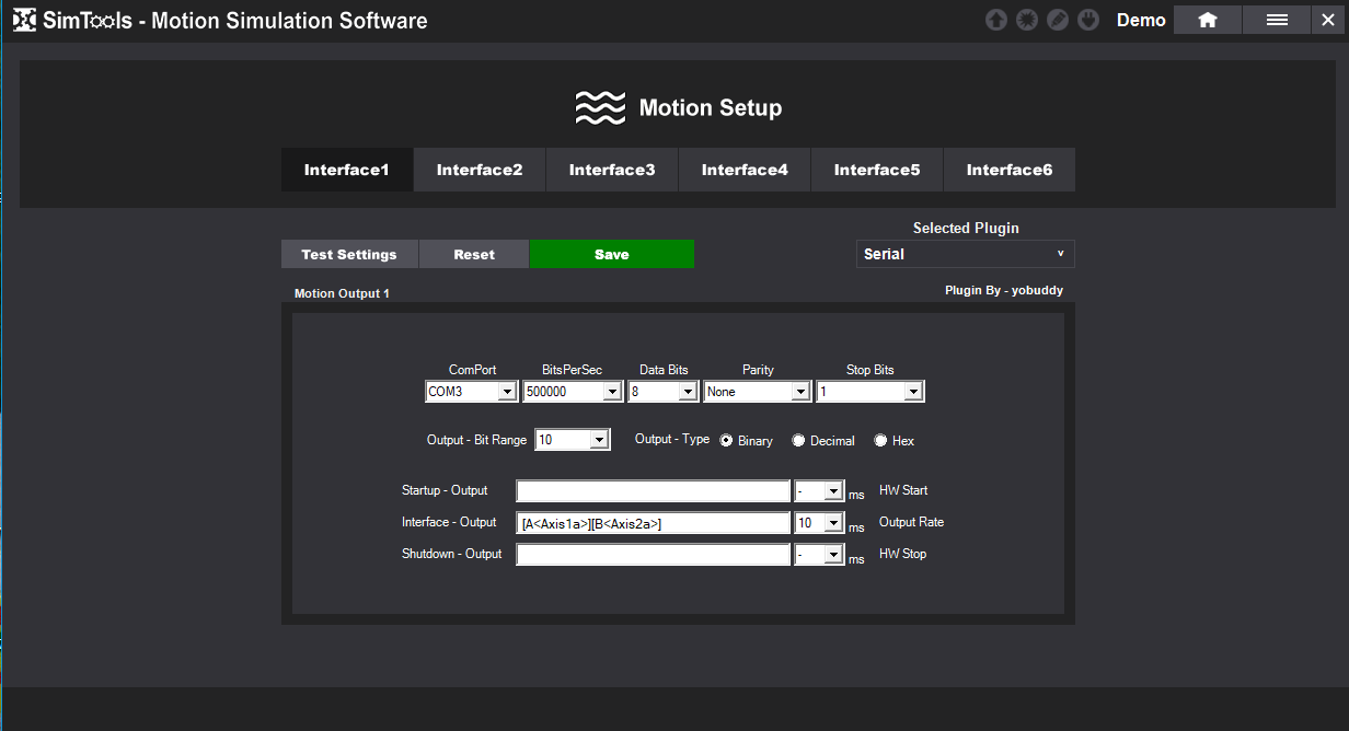

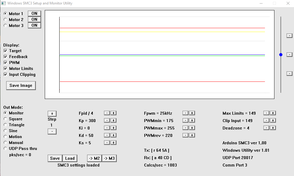

    3DOF, Arduino
    Here is a photo of my SMС Utils.png 3 utility settings

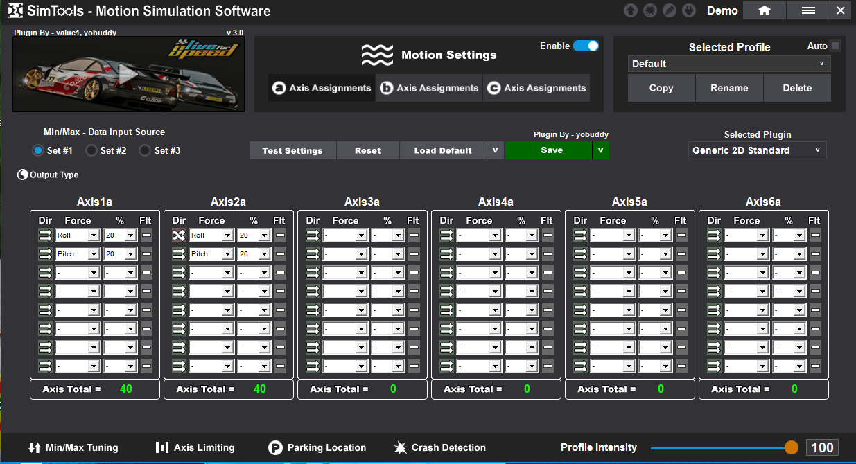

  3. Airbas72
    Airbas72 Member
    Oct 20, 2019
    37
    - 7Coins
    3DOF, Arduino

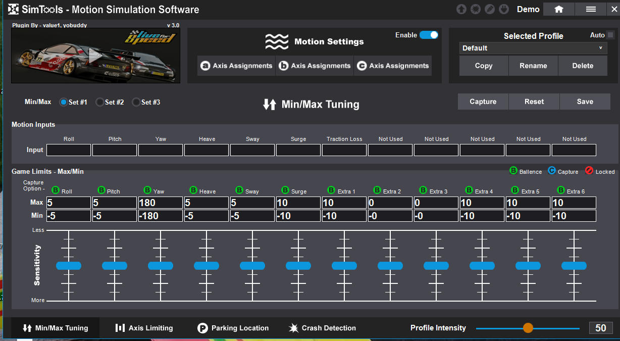

  4. Airbas72
    Airbas72 Member
    Oct 20, 2019
    37
    - 7Coins
    3DOF, Arduino
    Here is a photo of my SimTools 3 settings Снимок экрана (3).png Снимок экрана (4).png Снимок экрана (5).png Снимок экрана (6).png

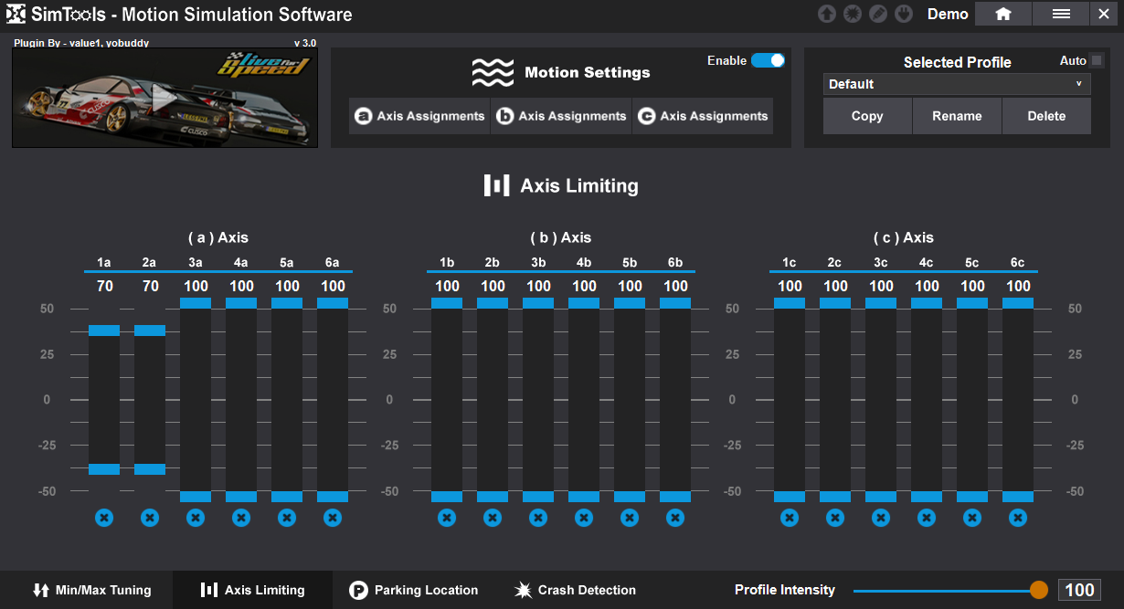

    Hi @yobuddy,
    I've had a thought about a possible addition to V3. If your setting up multiple axes but with the same forces and filtering, it can be time consuming checking the filtering is the same when you have up to 5 forces per axis clicking on the filter button for each then checking the numbers and then pressing exit for what could be 20 filter settings!
    Is it possible to have it so when you hover the mouse over the filter box it shows the filter settings popup? It could be slightly transparent or greyed out until you actually press on the filter button if you want to edit the settings.
    That way you can just move the mouse across the different axes to quickly compare filter settings.
    I hope that makes sense and is possible. :)

    Sure, be aware that the axis limiting settings is a global thing and not per profile.
    If you want to PM me some screen shots we can figure out whats going on.
    Take care,
  17. yobuddy
    51,735Coins
    +5,205 / 19 / -0
    It's one setting for all games/profiles is all, you can't have different settings per profile, if that is the problem.
    (Set and forget if you will)

    2DOF, 3DOF
    Adding my motion for seatbelt motion. Which option should I used ?
    -Pitch
    -Surge
    -Or else ? Which one?
    deeph
  19. yobuddy
    51,735Coins
    +5,205 / 19 / -0
    Surge will work nicely for your seatbelt buddy.
    Take care!
  20. noorbeast
    22,199
    154,657Coins
    +11,207 / 57 / -2
    The primary axis would be surge, but you can always mix others in like pitch to loosen up a hill and tighten a bit down a steep hill, or even sway for cornering.
