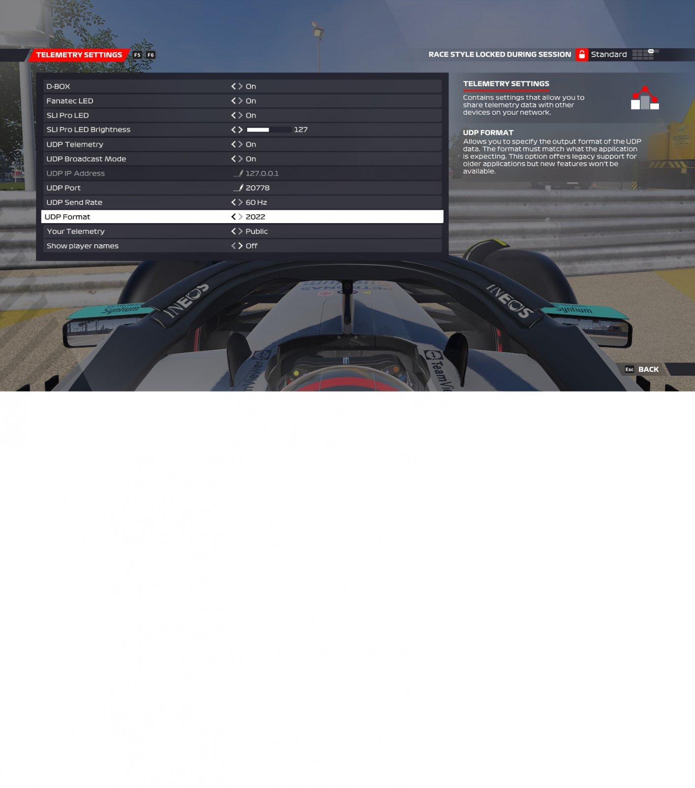

    Thanks, the game launches but when I am driving the car the motors are not moving. When I switchback to Gamemanager 2.6 everything works fine and the motors are moving and responding to the F1 2022 race game.
    I used the 2022 and the 2018 plugin, changes the settings in telemetery setup, patched the plugin, raced 5 laps to get the My games directory, did the patch etc. start the F1 2022 game but the motors are not responding. Switch back to gamemanager 2.6 everything works fine. Installed Race Room, setup Simtools 3 with the RaceRoom plugin and yes the game is working and the motors are responding.

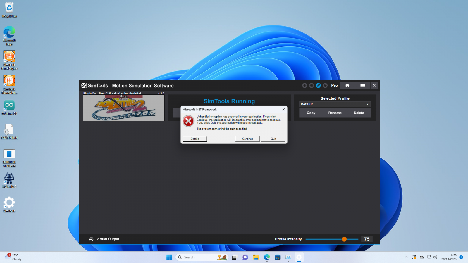

    Draging the desktop shorcut will cause the simtools to crash when i try to start it by double clicking the play button.
  8. yobuddy
    51,779Coins
    +5,206 / 19 / -0
    My guess is you have 2018 output on for f12022 (this is what the SimTools v2 plugin used for output)
    SimTools v3 thou, the f12022 game plugin uses the proper 2022 output for the game, so please make sure the game has it's output set to 2022 for SimTools v3.
    It just creates a 1:1 shortcut, so if it works on the desktop, it should be able to launch the game.
    Does the shortcut work from the desktop?

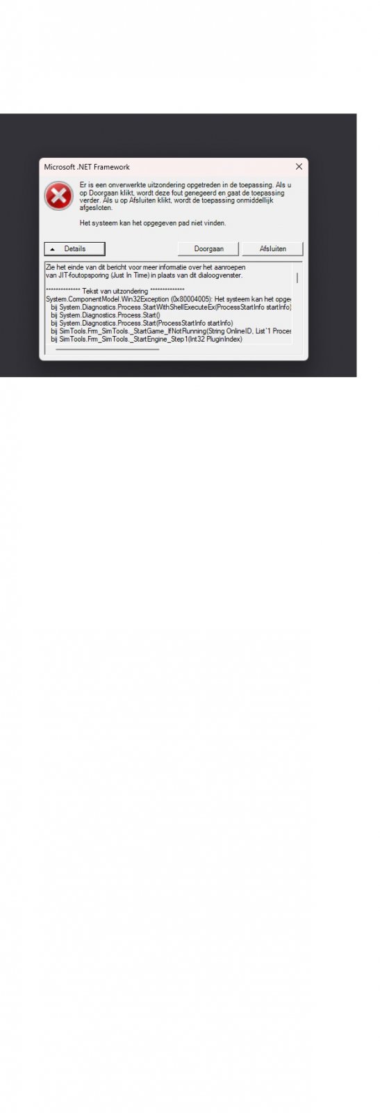

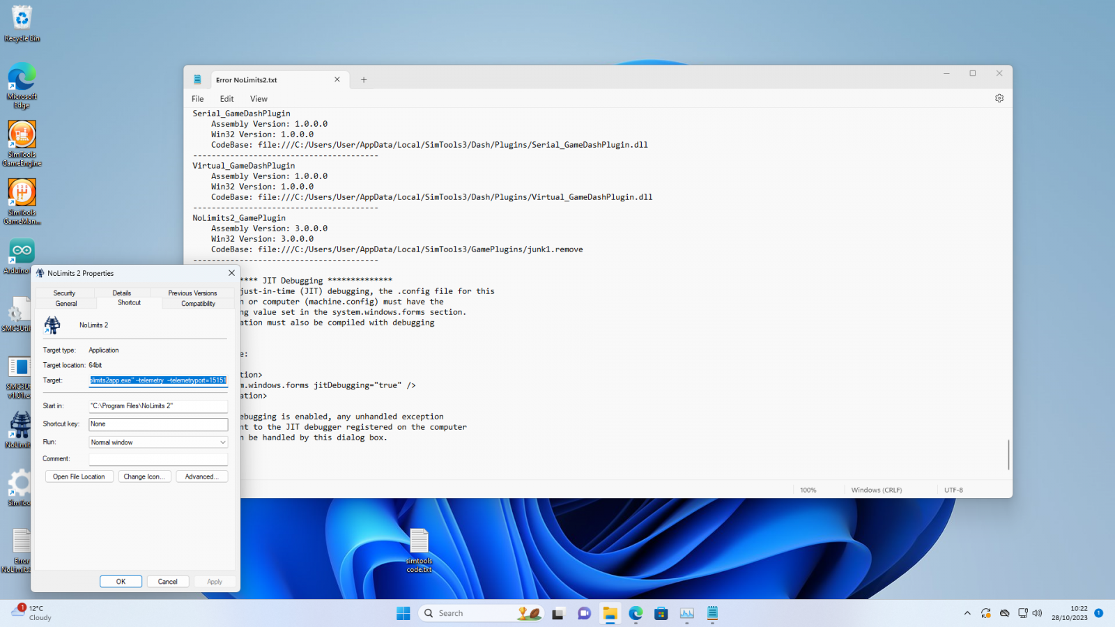

    See screemshots. The error says path not found. Not sure why it wont start. Maybe has to do that i have the ea play version with game pass? When using settings from game with 2018 udp it works with simtools v2.
  10. yobuddy
    51,779Coins
    +5,206 / 19 / -0
    Drag-Drop the games exe on the banner and see if that works.
    Yep, 2018 output for f12022 in v2 and 2022 output for f12022 in v3.

    I think I cannot start it from shortcut only via ea play. Saw the screenshot? It is on 2022
  12. yobuddy
    51,779Coins
    +5,206 / 19 / -0
    EA play is available for PC via Steam.
    The port should be 4123.
    (These are not the settings that get set when you patch the game with v3 is all)

    THanks a lot that worked! really weird why the patch wont change the settings. Is send rate 60 oke? Or should this also be different value?
  14. yobuddy
    51,779Coins
    +5,206 / 19 / -0
    60 is fine buddy, take care!

    New to the sim world and hoping someone can help me. I've started with NoLimits2 before I venture into more sims. I've had this working no problem using simtools version 2 Pro, now I have V3 Beta and can get all motors working great in testing. I changed the target exe name in properties to "C:\Program Files\NoLimits 2\64bit\nolimits2app.exe" --telemetry --telemetryport=15151 and dragged it over the game banner, but when I double click to start up this is the error I receive. I have spent hours trying to find a solution. Here's hoping someone has solved this before. Please ignore the blue error light as this refers to one of the motors disconnected
    Cheers

    enabled.
    For example:
    <configuration>
    </configuration>

    Sorry for such a basic answer to what looks incredibly complicated problem, but I notice you have an update to windows pending and is the blue dot in the lower right hand corner of the screen a notification message?
    I found problems could occur with these left unopened or not updated under simtools v2. It may be a very simplistic answer but it has worked for me in the past.

    Thank you for the reply. Windows has been updated but still didn't work. I've now installed and got the sim working with F1 2021 with the Xbox series X so at least that's a bonus
    Cheers
    Rob

    @ResidentRob,
    The game plugin actually make a launch shortcut, was the game not launching?
    Uninstalling the game plugin and restarting simtools, then re-installing the game plugin should fix the launch issue.
    Please let me know how it goes buddy.
