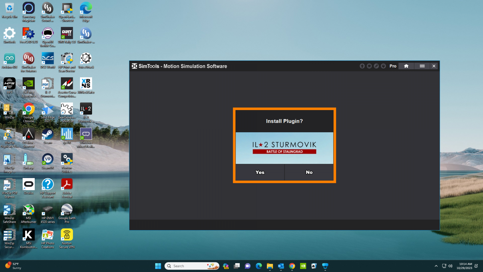

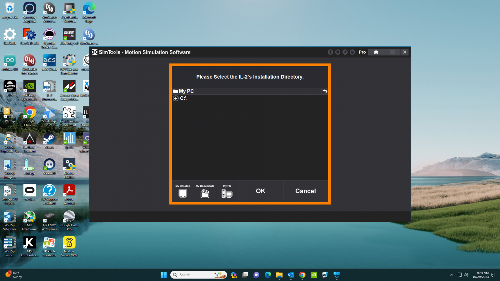

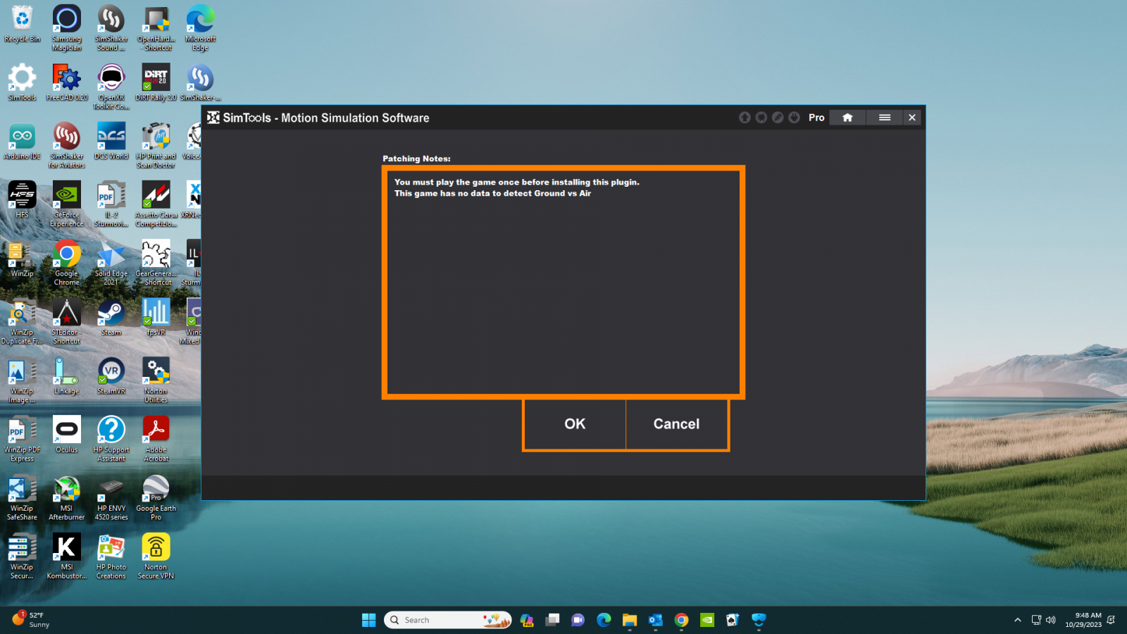

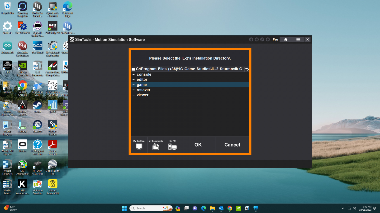

    I'm trying to figure out why this doesn't work. I know this is where the IL-2.exe is. But it won't patch.
    What am I doing wrong? I tried running the game but that didn't doing anything. Screenshot (3).png Screenshot (4).png Screenshot (5).png Screenshot (8).png
  2. yobuddy
    51,652Coins
    +5,204 / 19 / -0
    Please select the "IL-2 Sturmovik Battle of Stalingrad" folder.

    I only have " IL-2 Sturmovik great battles" it's the latest update of IL-2

    Hi YoBuddy
    I've tried this and still doesn't launch, I've even tried removing the plugin then restarting the pc and then adding again. The image i posted earlier is the same response when trying to launch the game from simtools. I can click directly on the game from the desktop and it will launch fine just not with simtools and then no movement. I went back to V2 and it works fine so I'll just have to do that when I want to use it

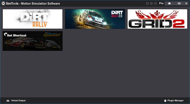

    I'm guessing you mean a shortcut for the game?
    If so, please drag-drop the shortcut over the game in SimTools v3 (like in the pic below)
    (Then when you launch the game in v3, it will use the new shortcut)

    The "IL-2 Sturmovik great battles" folder should work too.
    (The plugin is looking for: The path you give it and \data\startup.cfg)

    I tried that and it still didn't patch. I could only go down the path to data. I couldn't select startup.cfg, it is there though.

    You know when I tried to patch it said it didn't patch, but when I shut v3 down and then restarted, on the home page it shows the banner for IL-2. So i guess it did work. Thank you for the help!

    I meant to say the banner was on the v3 home page. When I put the mouse over it, it was working!
    When I clicked on the wavy lines it went right to motion settings.
