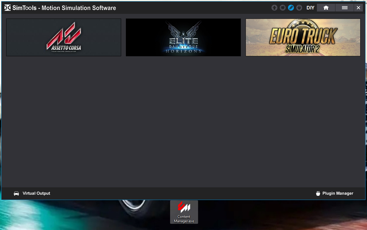

    Hello everyone, I'm trying to drag and drop the content manager for Assetto Corsa but it's not working:confused:
    Anyone have a solution?

    Can you tell me what is says in the error logging section of v3?
    I can see that you have an error, as the little blue pen is visible in the pic.
    (You could also try dragging the exe for content manager over the banner, I bet that works.)

    Hi Yobuddy,
    the error message comes from the ardwino uno card which is not connected.
    but for content management it doesn't work

    2DOF, 3DOF
    I believe you don't need to drag n drop CM app to banner. All you need to do is install the Simtools AC plugin and done.
    I just did that and it works as it should.
    EDIT: If you double clicks the CM you should get the rig moves.

    Hi Deeph46,
    if I understood correctly I can launch CM and the platform will move once in the race?
    however on my PC the automatic detection of launched games is not activated in SimTools, should I activate it?
    I will do my test tomorrow and follow your advice:thumbs

    Hi Carl,
    When you (just) open CM app your rig should be moved if you enable auto detect launched games.
    You should activate it, it makes ease the process:cheers

    @Carl,
    Are you running SimTools as admin?
    (As it will not work if you run SimTools as admin is all)
