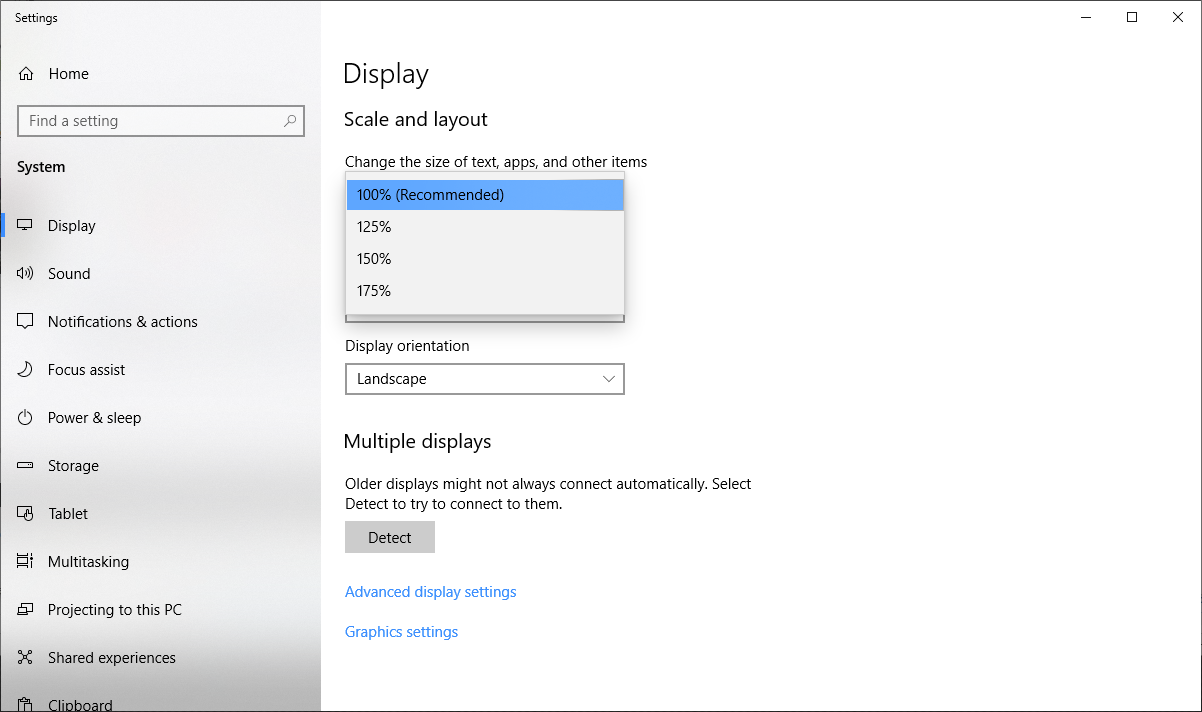

    hello youbuddy. For the past two weeks I have been Out ... physical problems, hospital, surgery ... now almost all solved. I just wanted to ask you if you managed to control the problem 1) that I had reported in my post #67 to you with my pc.
    You said this is a scaling problem
    Description of problem:
    1) In simtools v3 interface plugin I have installed "AMC INTERFACES THANOS". At this point I enter "INTERFACE SETUP" and on "select plugin" I select AMC. As soon as I do this the screen shrinks and becomes very small on my screen. At this point I can't enlarge it anymore. To be able to return to the enlarged screen, uninstall simtools v3 and reinstall it again. In the screen settings the text scaling value suggested by the system is 300% and if I try to change this value, however, things do not change, after selecting the puglin AMC the simtools v3 screen is greatly reduced compared to what it was initially and the only way to get simtools v3 back to its initial size is to uninstall and reinstall it. The monitor used is a sony 55 "4k tv. I tried to download simtools v3 demo in my office pc where I use a 22" monitor and where the suggested and set text scaling value is 100% and here the problem does not exist presents.

    The GUI scaling problems will get fixed when I get to skinning.
    For now set scaling to 100% and it will work fine.

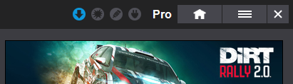

    hi @yobuddy thank you thats what it was i was on beta must have reinstalled alpha by mistake cheers back up and almost running i still have updates available at the top but cant see how to update it is there a way to find out if im on the latest version ?

    When you install v3, it always installs the latest version.
    The updates available probably means you have a game plugin that can be updated.
    You could also check you options page and see if you have some options set to not update.

    Check the scaling settings on the pc and make sure its set to 100 (for now).

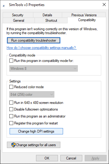

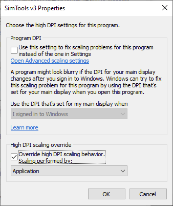

    @Mu-KwangKim
    Try right clicking on the simtools shortcut and then click "change high DPI settings".
    And then I'm guessing the bottom one will work?
    Let me know buddy.
