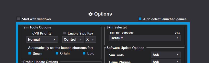

  3. Hobbs77
    Hobbs77 Active Member

    Hi @Hobbs77 for beta to work with simtools V3 you need to go into simtools V3 options and select auto detect launched games at the top right:thumbs sim3 auto.JPG

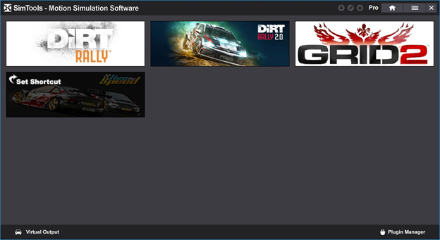

    To get simtools to launch a different version of the game, you may need to update the lauch path for the game in v3. To do this please drag-drop the shortcut, or games exe file, over the game in SimTools v3 (like in the pic below)
    (Then when you launch the game in v3, it will use the new shortcut)
    This is because the dirt 2.0 plugin for v3 has been updated to use the newest api for the game.

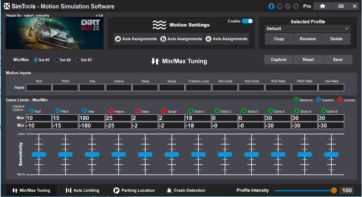

    Unpatched from Simtools2, removed plugin from simtools3, then installed from simtools3 again, this time it shakes like crazy, and continues even after exiting the game (shakes like crazy in the main menu).
    Xml-section before installing (and .bak-files removed by uninstalling patches/plugins)
    Code:
        <motion_platform>
            <dbox enabled="true" />
            <udp enabled="true" extradata="3" ip="127.0.0.1" port="20777" delay="1" />
            <custom_udp enabled="false" filename="packet_data.xml" ip="127.0.0.1" port="20777" delay="1" />
            <fanatec enabled="true" pedalVibrationScale="1.0" wheelVibrationScale="1.0" ledTrueForGearsFalseForSpeed="true" />
        </motion_platform>
    After installing plugin in Simtools3:
    Code:
      <motion_platform>
        <dbox enabled="false" />
        <udp enabled="true" extradata="3" ip="127.0.0.1" port="4123" delay="1" />
        <fanatec enabled="false" pedalVibrationScale="1.0" wheelVibrationScale="1.0" ledTrueForGearsFalseForSpeed="true" />
      </motion_platform>
    Screenshot of settings:
