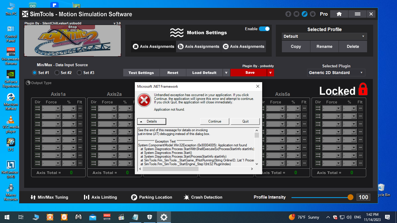

    Hello everyone
    Today I decided to share with you my humble experience about the problem that happened to me, which really exhausted me,
    and how I was able to solve this problem... I hope that this experience will be of benefit to everyone.
    //////////////// The problem /////////////////
    Error message "Microsoft .NET Framework"
    System.ComponentModel.Win32Exception (0x80004005): Application not found
    at System.Diagnostics.Process.StartWithShellExecuteEx(ProcessStartInfo startInfo)
    at System.Diagnostics.Process.Start()
    at System.Diagnostics.Process.Start(ProcessStartInfo startInfo)
    at SimTools.Frm_SimTools._StartGame_IfNotRunning(String OnlineID, List`1 ProcessesNames)
    at SimTools.Frm_SimTools._StartEngine_Step1(Int32 PluginIndex)
    at SimTools.Frm_SimTools.PicMenu_ClickedButton(Int32 ButtonID, ButtonClicked ButtonClicked)
    at SimTools.Frm_SimTools.AllStartButton()
    at MyBannerStopButton.MyBannerStopButton.MyBannerStopButton_MouseDown(Object sender, MouseEventArgs e)
    at System.Windows.Forms.Control.OnMouseDown(MouseEventArgs e)
    at System.Windows.Forms.Control.WmMouseDown(Message& m, MouseButtons button, Int32 clicks)
    at System.Windows.Forms.Control.WndProc(Message& m)
    at System.Windows.Forms.Control.ControlNativeWindow.OnMessage(Message& m)
    at System.Windows.Forms.Control.ControlNativeWindow.WndProc(Message& m)
    //////////////// The solution /////////////////
    #0_video in my youtube channel
    #1_Download and install programs :
    Download .NET Framework 4.8
    https://dotnet.microsoft.com/en-us/download/dotnet-framework/net48
    Download .NET Framework 4.8.1
    https://dotnet.microsoft.com/en-us/download/dotnet-framework/net481
    Download .NET Framework Repair Tool
    https://www.microsoft.com/en-us/download/details.aspx?id=30135
    #2_Activation .NET Framework :
    #3_Download the PLUGIN.ZIP file from the official website :
    https://simtools.us/plugin/?varname=167
    To "NoLimits2_GamePlugin.dll"
    To "NoLimits2_Banner.JPG"
    #5_Compress the file to .ZIP :
    file name "NoLimits2_GamePlugin.ZIP"
    #6_Open the program SimTools3 And Drop the file "NoLimits2_GamePlugin.ZIP" in to it :
    #7_Create a shortcut to the game application and rename it :
    Name shortcut to "NoLimits2"
    And Right click Properties > Shortcut > Target :
    And at the end of the path, "space" and paste "--telemetry --telemetryport=15151"
    And click Apply and OK
    #8_Copy a Shortcut file "NoLimits2" to path :
    C:\Users\"your User name"\AppData\Local\SimTools3\LaunchShortCuts
    #Enjoy the game

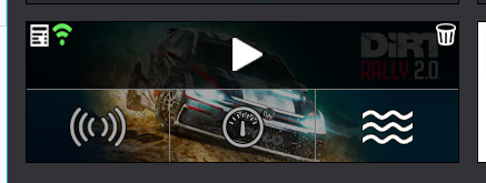

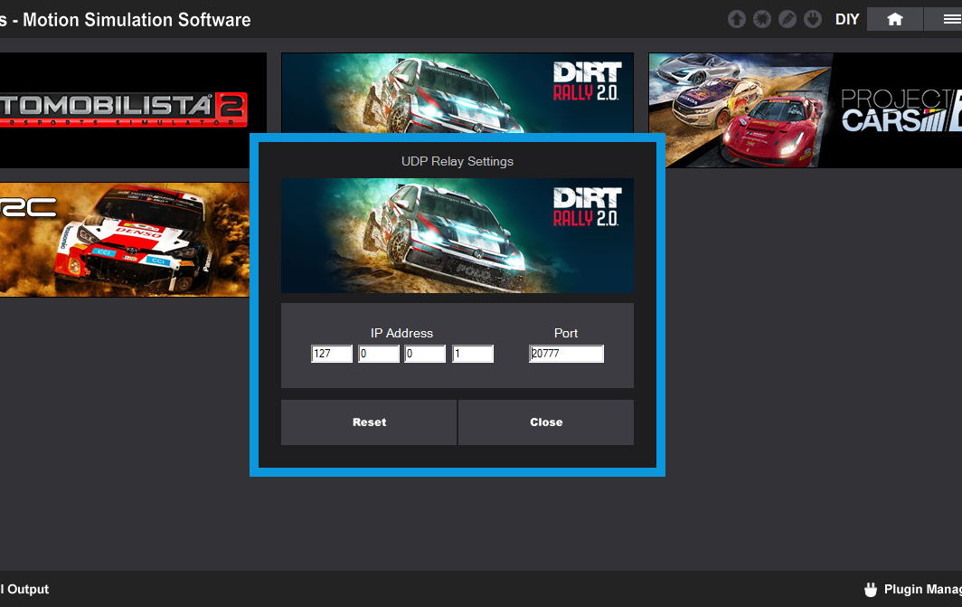

    Clicking the green wifi-icon top left allows you to set a relay address/port.
    Here is how it's configured on my machine:
    - DR2.0 Sends UDP-telemetry to port 4123
    - Simtools3 Listens to the UDP on port 4123, on every message it forwards a copy to udp port 20777 and then processes the telemetry and moves my simulator.
    - SimHub listens on UDP 20777 and uses the data for my DIY-buttkickers.
    If you only use SimTools3 then you should click the green wifi icon, remove address and port. Then configure DR2.0 in the xml-section to use port 4123.

    What dr2 port app buddy?
    If you mean the UDP Relay from the plugin, please know that you do not need to use it at all.
    Unless you are driving another application, then please click reset to clear these settings.
