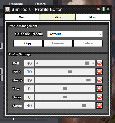

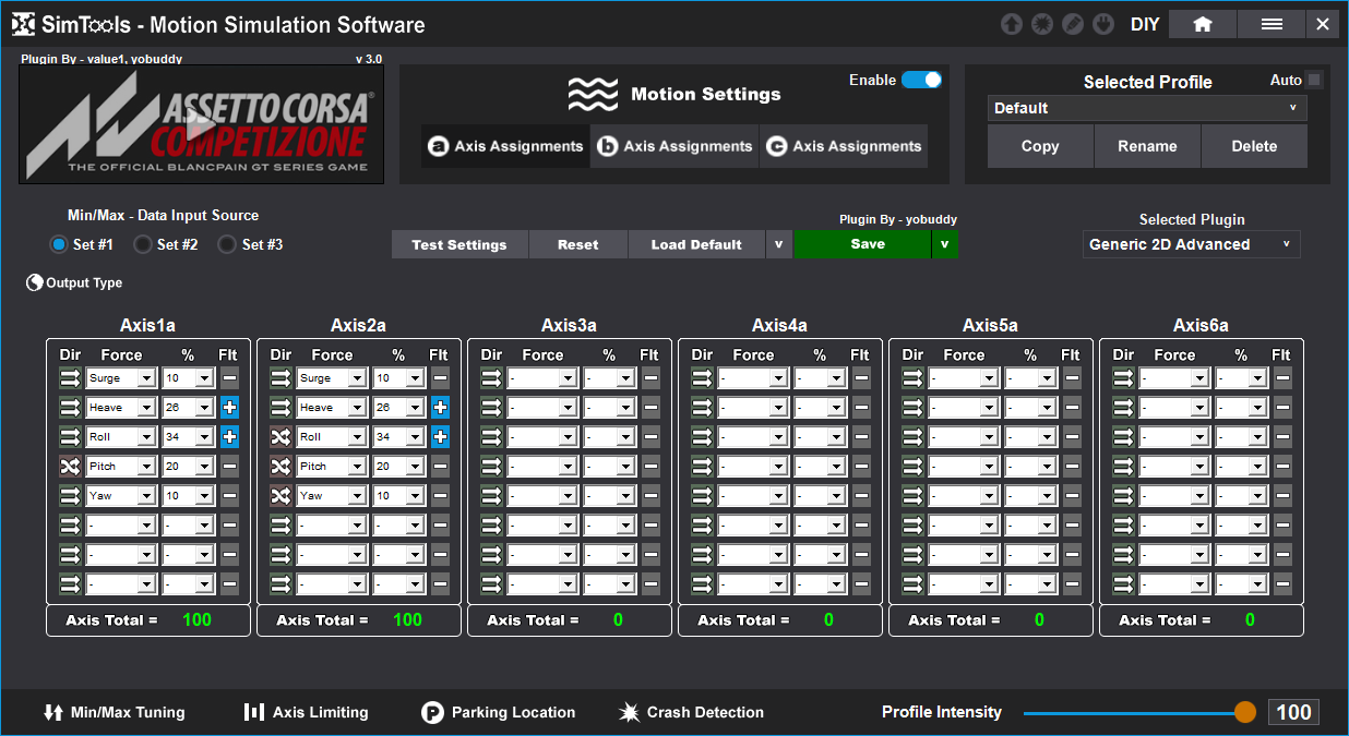

    Hello, can you help me? Where can i found profile settings in simtools 3.0 like in simtools 2.0?

    You have to clic on the waves of game plugin of you choice.

    and where i can found profile settings or something like this? upload_2023-11-26_12-36-8.png

    Selected profile top right

    I mean where can I adjust the heave, roll, etc. in profile settings, not in axis

    Mr.TopGearMan this profile settings is now called "sensitivity"and is located within the min/max tuning tab.
