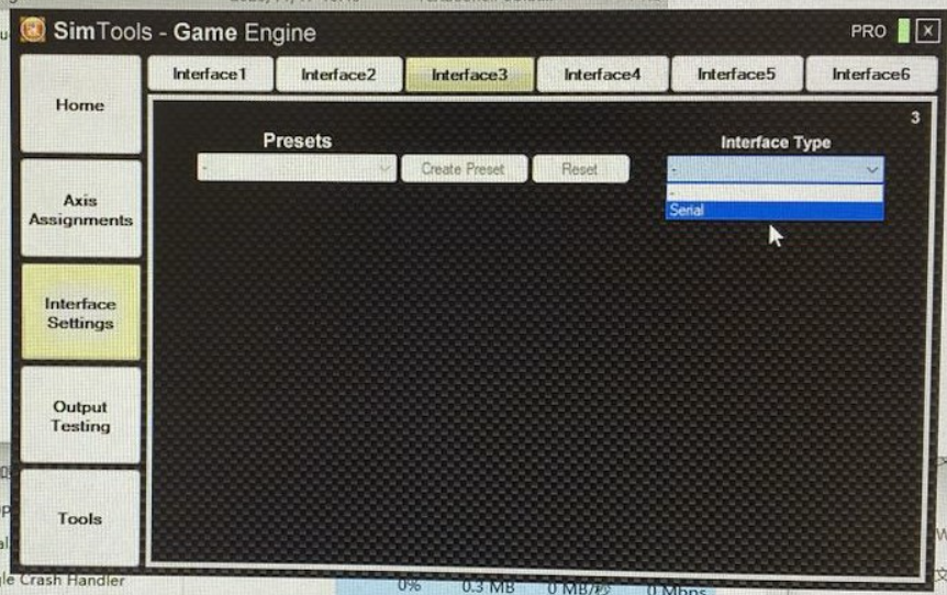

    Hi guys!
    I'm having problems setting up Simtools. When I installed the plugin, I found that I could not configure the network interface. I tried to reinstall the plugin, but the problem still failed.

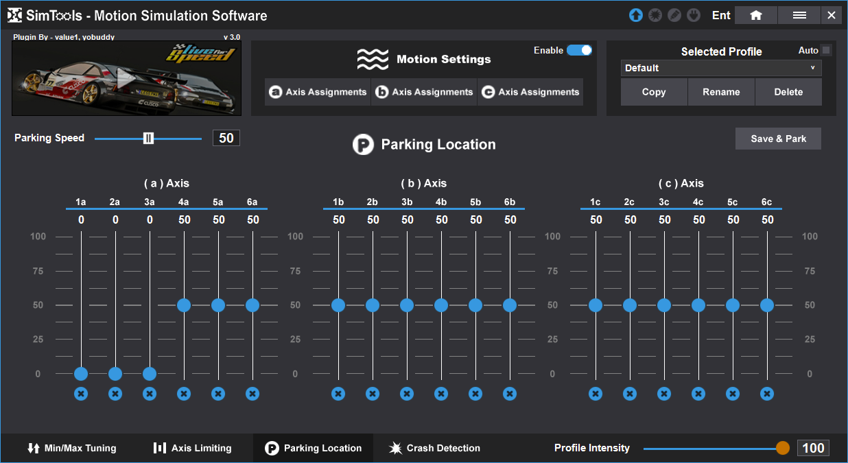

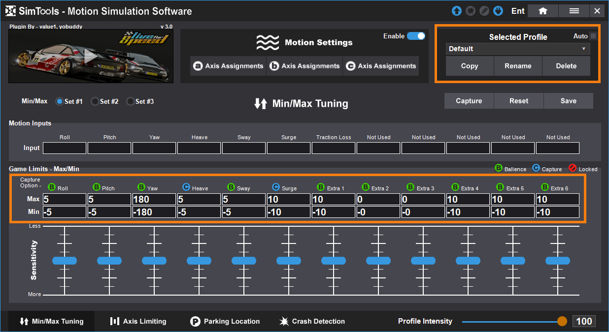

    All the profiles did in v2, was to adjust the games max/min values by up to + - 50%.
    Since in v3 we can have as many profiles as we want, we can simply adjust the the Max/Min values for the profile selected.
    You can set a parking location in the motion section.

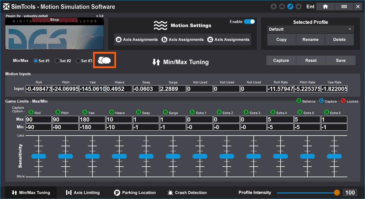

    Hello !
    Impossible to have télémétry for DCS with simtools V3 :/
    Patch ok
    Game start sim go UP but in simtools 3 no motion input from dcs !
  14. richdelta9
    richdelta9 Member Gold Contributor
    May 16, 2014
    47
    8,820Coins
    +65 / 0 / -0
    I just tried it here and it is working for me. You do need to fly around in the game before you can patch it. Have you done this? You also need to patch the game in the Saved Games folder not the installation folder.
    Make sure there are min/max values for Air and not just ground, so make sure you have the clouds showing with max min values as seen in the image. pK35S9BXDU.jpg

    I have the same problem as Kaneda. No telemetry from DCS too SimTools (= the line for input in Min/Max tuning screeen is empty of values).
    1. Flying around in DCS before patching. Checked.
    2. Patching to Saved Games folder. Checked.
    3. Air icon in Min/Max tuning screen. Checked.
    Dear Yobuddy. Can you please have a look at this issue, maybe give us a tutorial for DCS plugin especially. Not only on the SimTools side of the aile, but how to configure DCS as well.
    I seem not to be the only one with this problem.

    Rich and I tested the plugin directly above your post buddy.
    (The plugin does install the default lua script thou, it could be we need another one for places that use the coma as a decimal point?)
    Edit: Never mind, we fixed the coma decimal point problem before the first release - so that's not the problem.
    Did you have the game working before?
    Or is this a new install?
    (there was a game update on the 22 I believe)

    I try this morning et works !!
    Need to change , by . On régional option !

    We posted an update to the DCS plugin. It should work everywhere now without needing to change anything in Windows. If you have Auto set for plugin updates, then it will update correctly without needing to do anything. If you have Ask set for plugin updates, then you will need to uninstall the plugin and then restart SimTools and install the new plugin for it to update correctly. The Ask update bug is only an issue when you are updating a plugin that requires a re-patch like DCS and will be fixed in a later release of SimTools. Let us know if you have any issues with the DCS plugin update.
