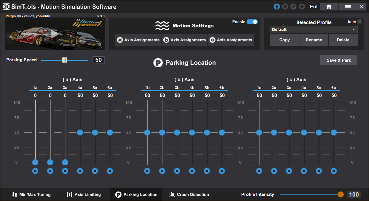

    You can set a parking location in the motion section.
    100438 [/QUOTE]
    Thank you!

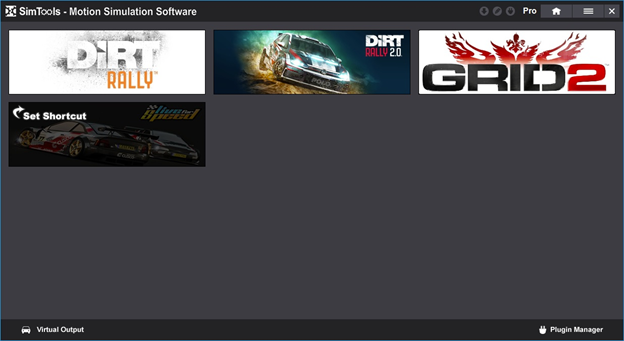

    Hi @f5umy,
    Have you set a new launch path for the game since your not using steam?
    If not, please drag-drop the games exe or shortcut on the games banner, and then give it another try buddy.

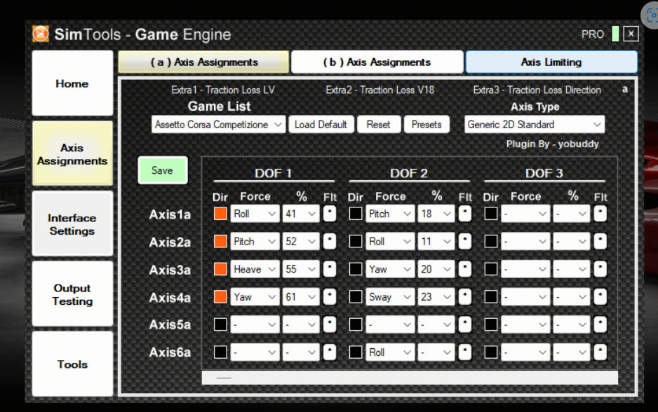

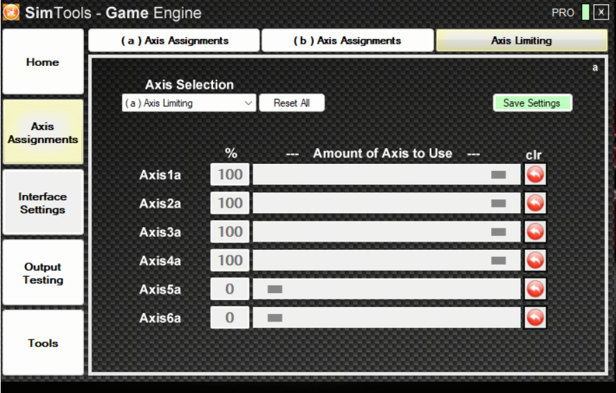

  5. kevin22731
    kevin22731 New Member
    Nov 15, 2023
    6
    - 14Coins
    4DOF
    Hey guys!
    I upgraded my simtools from version 2.3 to v3 and found that my seat seemed to fail without changing other Settings and connections. I used the previous 2.3 Settings and they still didn't work. Should I uninstall version 2.3? Or is there any other solution?
    Best wish.
    upload_2023-12-4_15-31-35.png upload_2023-12-4_15-31-52.png upload_2023-12-4_15-32-8.png upload_2023-12-4_15-32-35.png
    22,228
    154,837Coins
    +11,227 / 57 / -2
    What are your v3 Interface Settings, can you please post a picture of those?
  7. kevin22731
    Nov 15, 2023
    6
    - 14Coins
    4DOF
    Thank you for noorbeast reply, I have solved the problem.

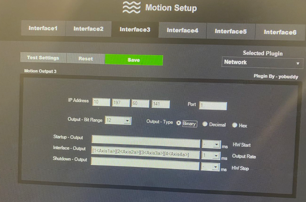

  8. Michael Pleym
    Michael Pleym Member
    Apr 25, 2023
    40
    258Coins
    +8 / 0 / -0
    @yobuddy and noorbeast
    Hi guys,
    as I wrote before I'm building a new computer for my sim rig. It will have upgraded MB, CPU, SSD and OS (Win 11). I will need to make new installations of drivers and software. I have two questions.
    1. noorbeast have told several times that SimTools license is only for one PC at the time. Will my current license understand it sits in another PC than before without me doing anything special, such as uninstall the program from my old harddrive (that is still living and kicking but not with any motion platform connected) ?
    2. In the Interface menu you can chose Network plugin (see pic above). What is the difference between Network plugin and Serial plugin. I have a NjMotion Evo seatmover and when installing the repo for that one, the Serial plugin is automaticly installed as I understand it. Can I manually chose the Network plugin for my platform and what will happen then?
    Kind regards
    Michael Pleym
    22,228
    154,837Coins
    +11,227 / 57 / -2
    When registering SimTools it will do so against the new computer hardware, so just uninstall the unused instance.
    Net or Serial relate to how communication is handled for the control hardware used, if it is a repo for the NjMotion it would make sense that configuration would be for the hardware that rig uses.

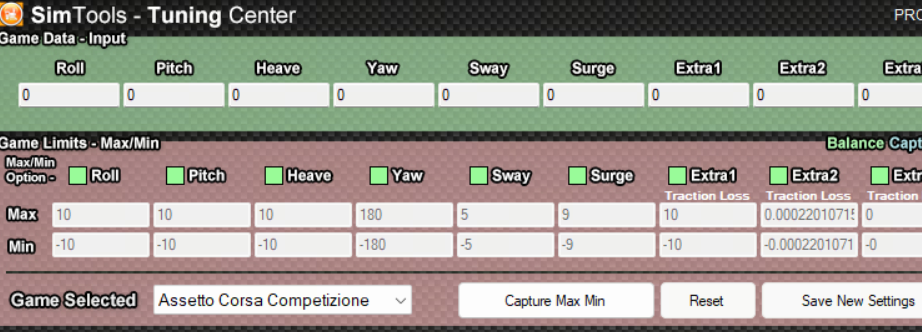

    Hi everyone!
    I'm trying to capture live telemetry data from Assetto Corsa Competizione.I found a couple of related plugins in the forums,such as Capture Live Telemetry BETA (xsimulator.net) and GameEngine output testing tool (xsimulator.net).But these two plugins are only supported in V2, I tried in V3 and it didn't work.
    Would you please give me some advice about capturing live telemetry data.Or do we have a plugin that supports the V3 version?
    Thanks for your reply!

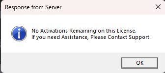

  19. deeph46
    deeph46 Member
    Mar 17, 2023
    117
    641Coins
    +16 / 0 / -0
    2DOF, 3DOF
    Hi Yobuddy,
    I recently reisntall my Windows, then installed Simtools 3 and got this notification.
    How do I fix that?
    deeph
