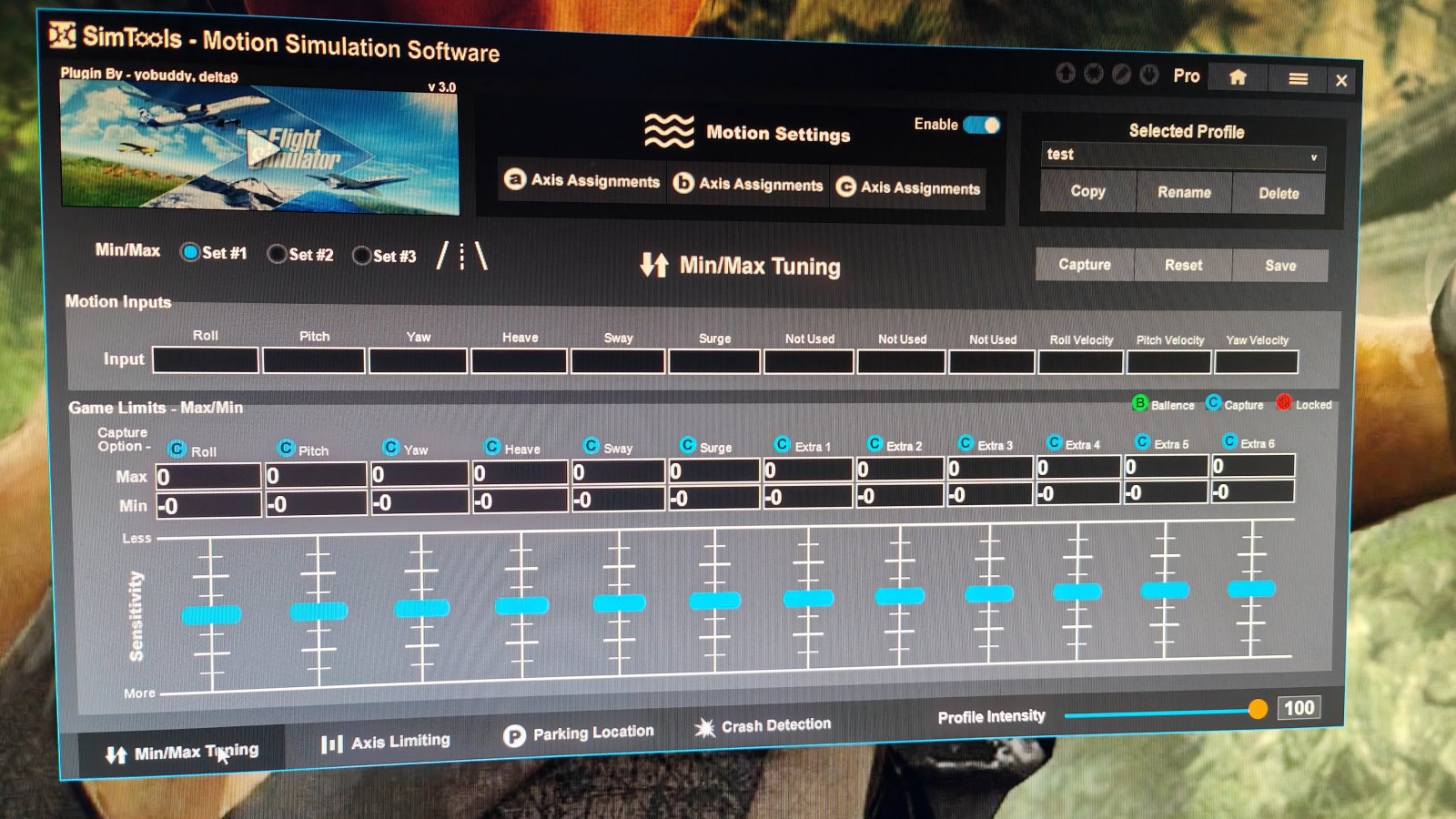

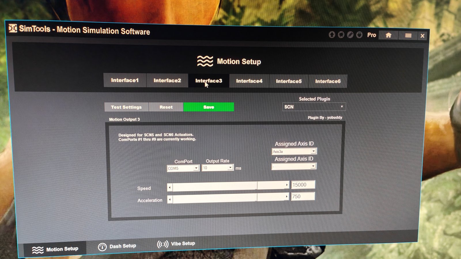

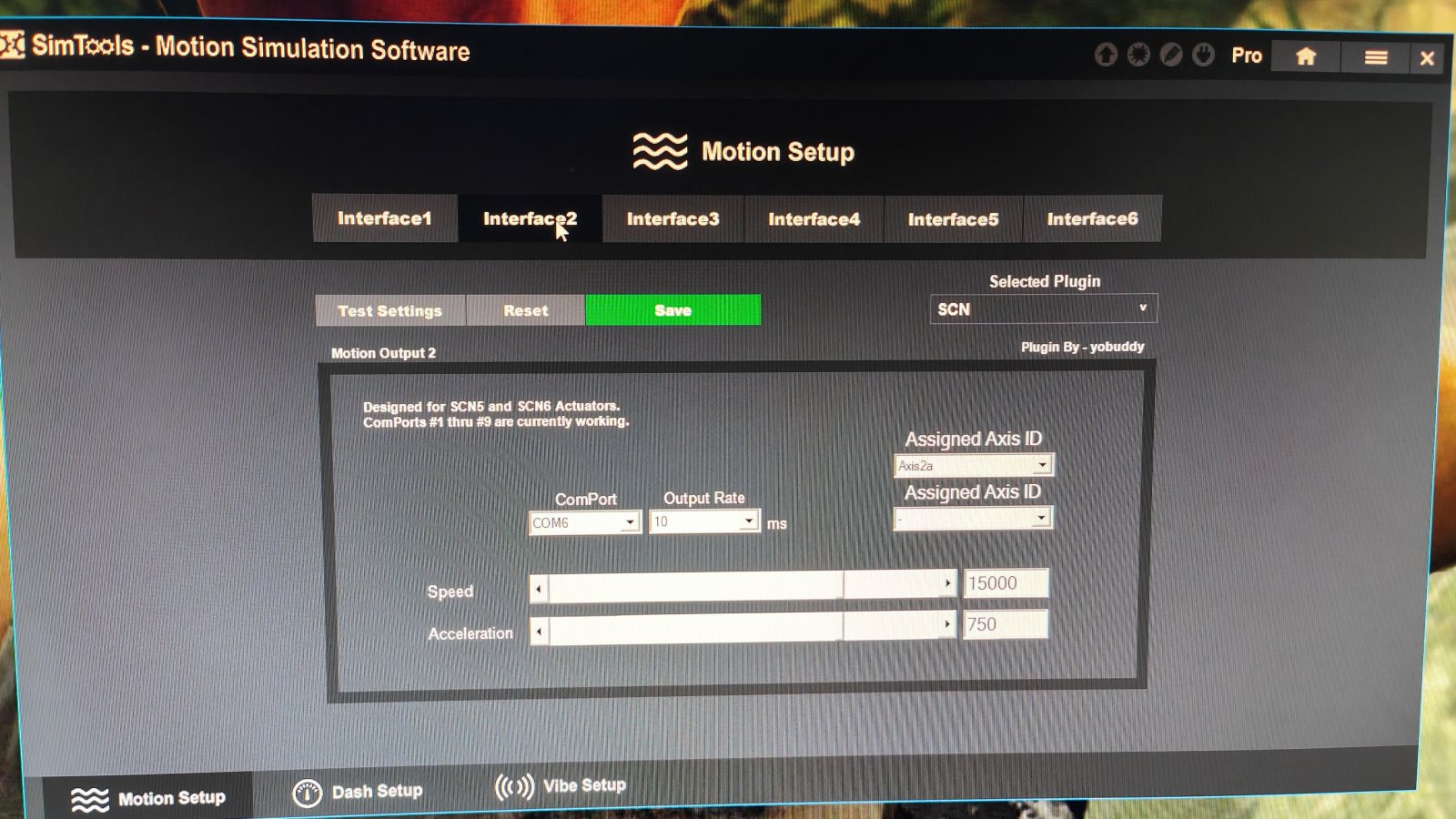

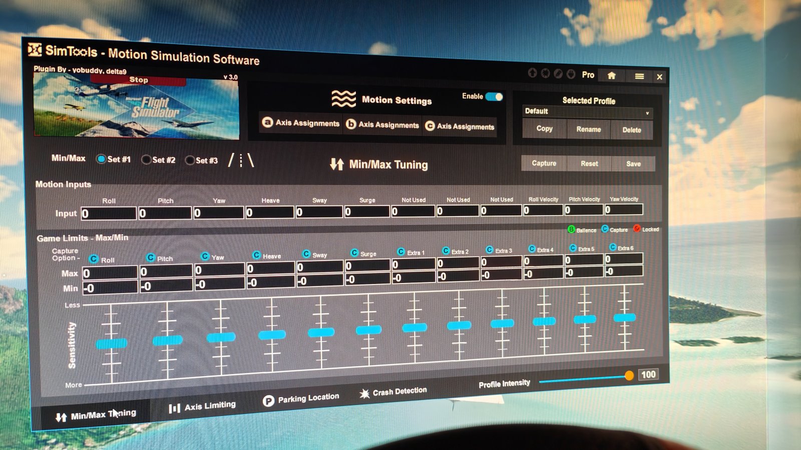

    Hi all,
    After years of absence from simtools, I am coming back to this software because my PROSIMU T1000 3DOF SCN6 is no longer compatible with SRS. Okay, so I'm diving back into this app. And the problems begin. So I'm on simtools V3, and I lost a cylinder. Can't get it to work. Well I think the problem is Hardware. I am waiting for news from PROSIMU. On the other hand, it is impossible to operate MFS2020. I can get asseto and other games to work, but mfs is impossible. Are you also experiencing this problem? If anyone can help me... I'm at the end of my skills. Thanks in advance.
    22,228
    154,837Coins
    +11,227 / 57 / -2
    Can you please post pictures of all of your settings, including Max/Min while MSFS2020 is in flight.

    I have the same profil for all game. I'm nobe on simtools, it's difficult for me to have a good setting for each game.
    22,228
    154,837Coins
    +11,227 / 57 / -2
    There may be other issues, and it is not clear if MSFS2020 is running, but all Max/Min values are set to zero, so need to be Captured if there actual data in the Input when the game is running:

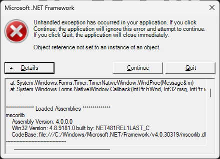

    See an error message when installing SimTools3 Beta (Pro license) on Windows 11 using following link. Please advise on how to fix this.

    Please hit the Details button on the error message and copy the full error message here.

    Attached file contains the complete error message.

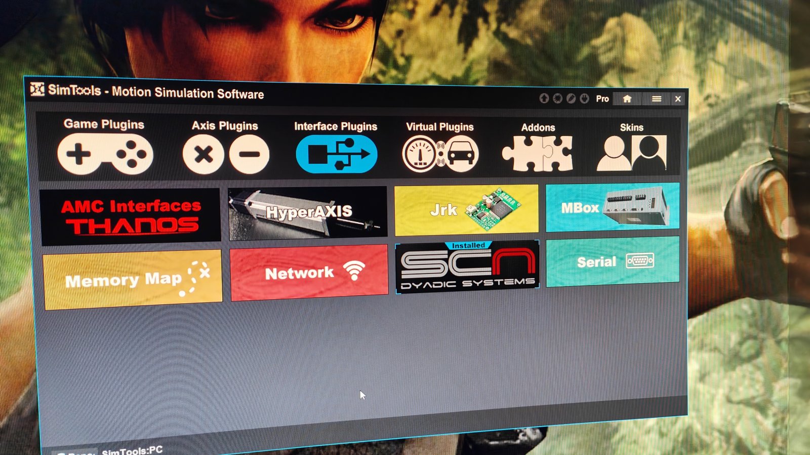

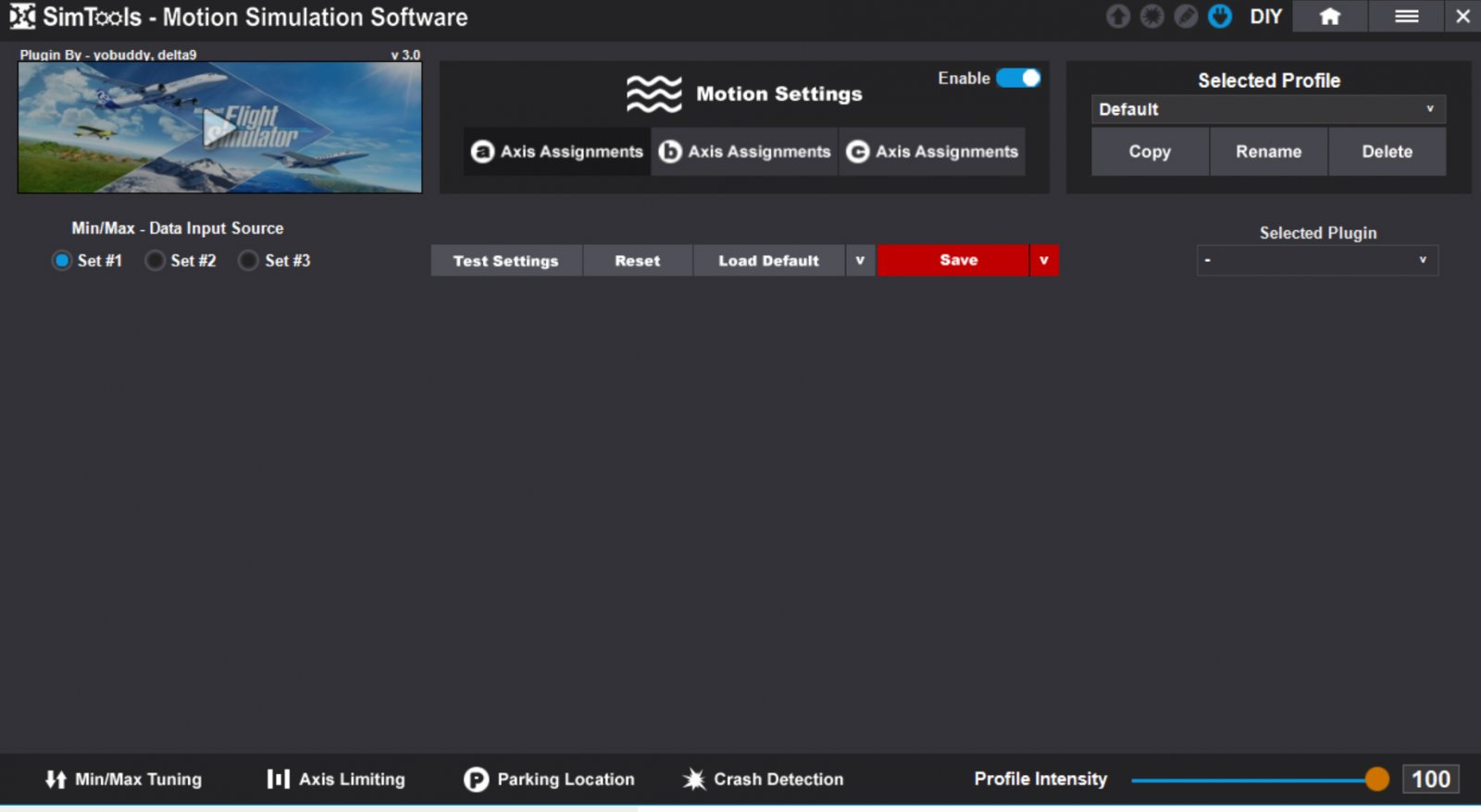

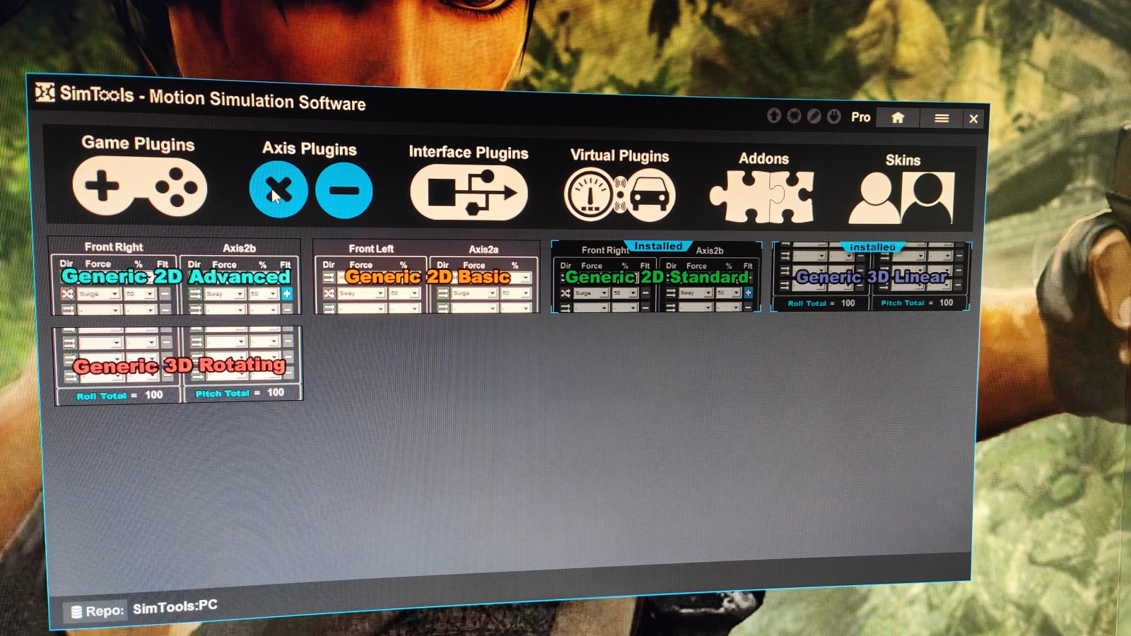

    Is there an ST3 manual? I can't figure out how to assign axes. This what I see:
  12. Tim Herschbach
    Tim Herschbach Member Gold Contributor
    Oct 23, 2023
    103
    585Coins
    +24 / 0 / -0
    Nevermind, I just saw that you have to download the serial plugin also. I seem to be making progress.
  13. Tim Herschbach
    Oct 23, 2023
    103
    585Coins
    +24 / 0 / -0
    Spoke too soon, I'm still not able to do anything. I also downloaded the generic 2d standard and sliders plugins thinking maybe they're needed, but I'm still only seeing the above screen. I'm not seeing any documentation anywhere for ST3 other than how to install.
    *sigh*. Now the plugin drop down for standard 2d works. Should be good now.

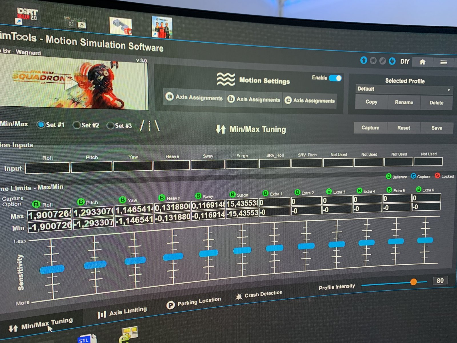

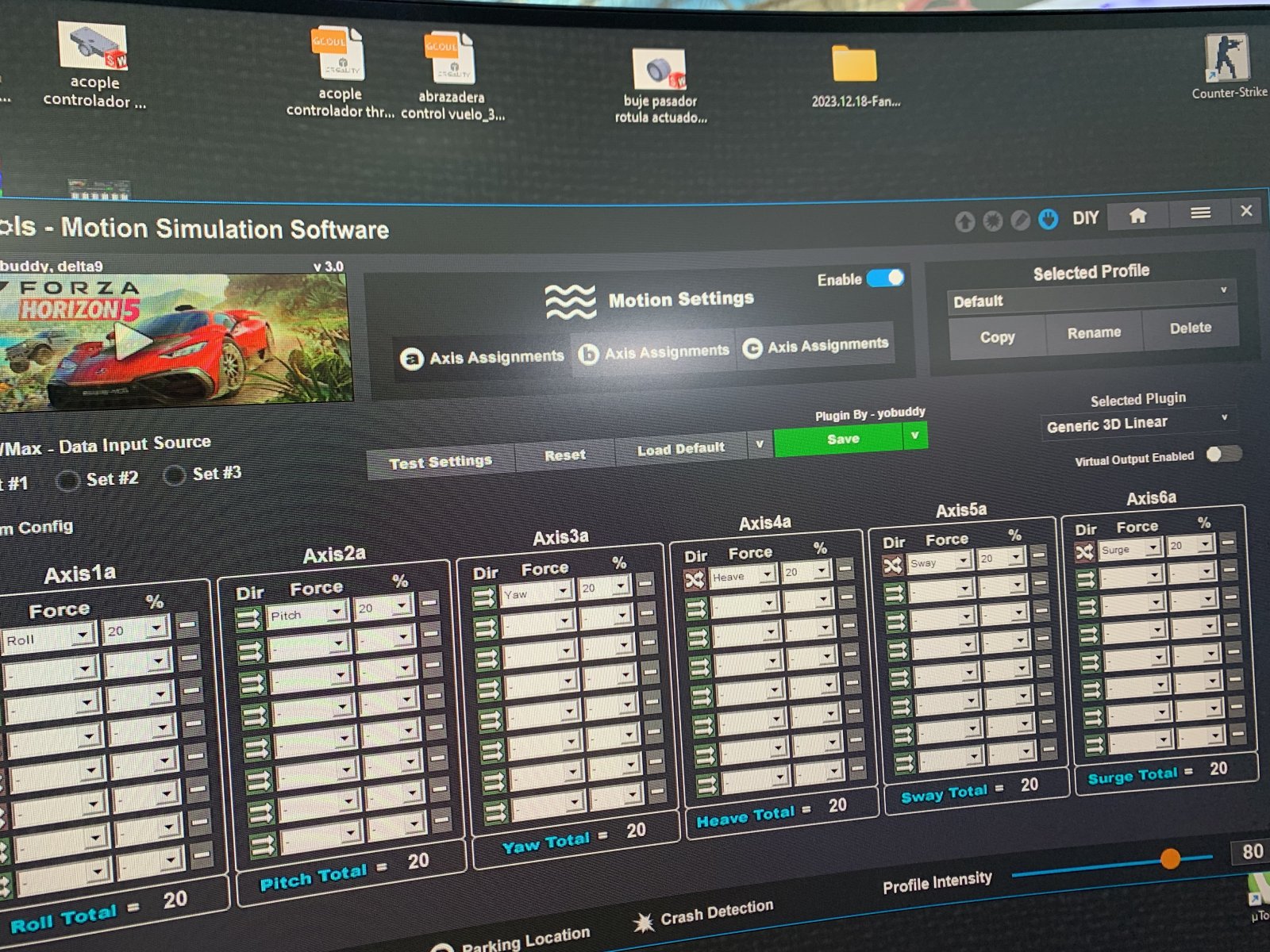

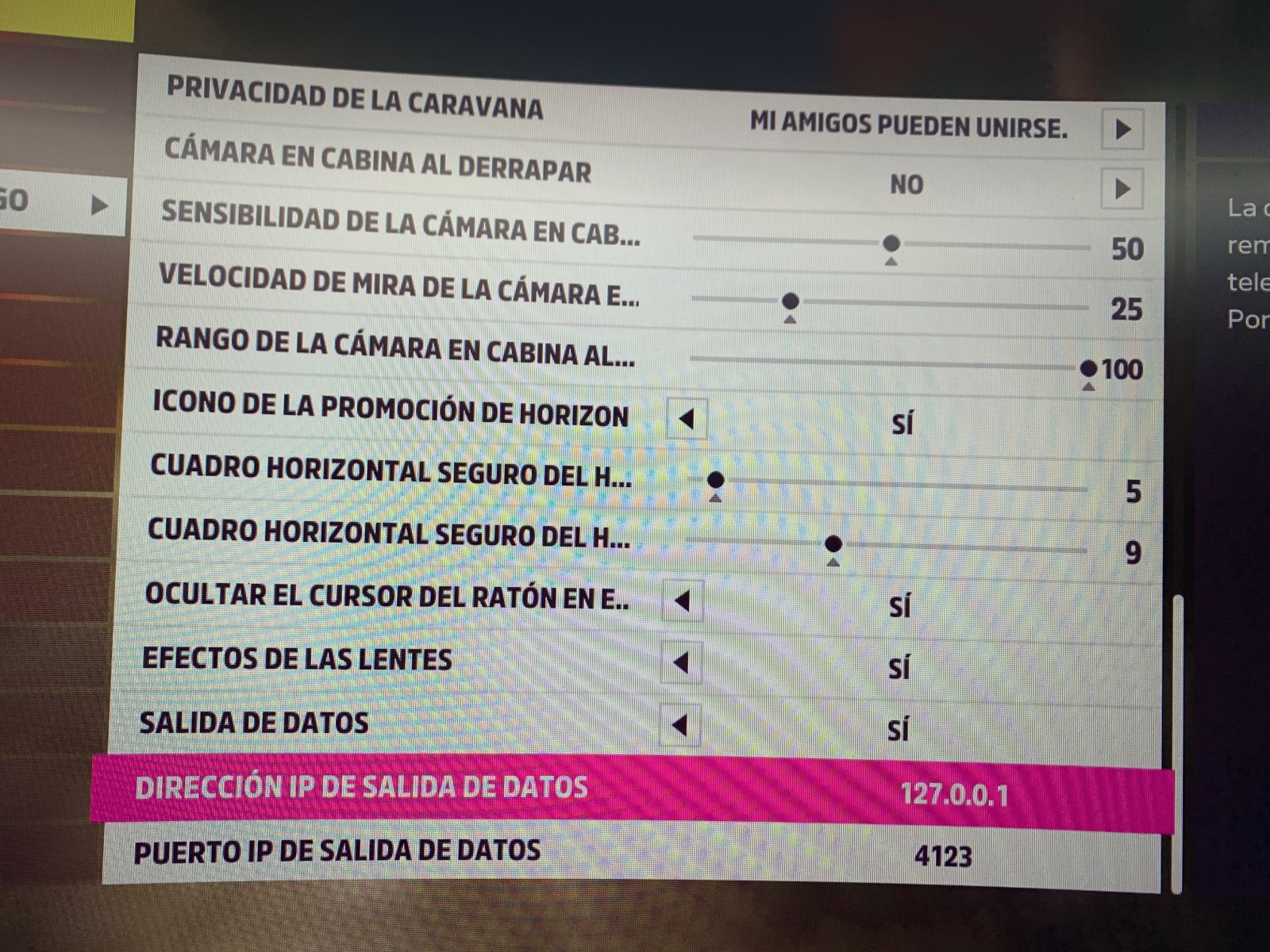

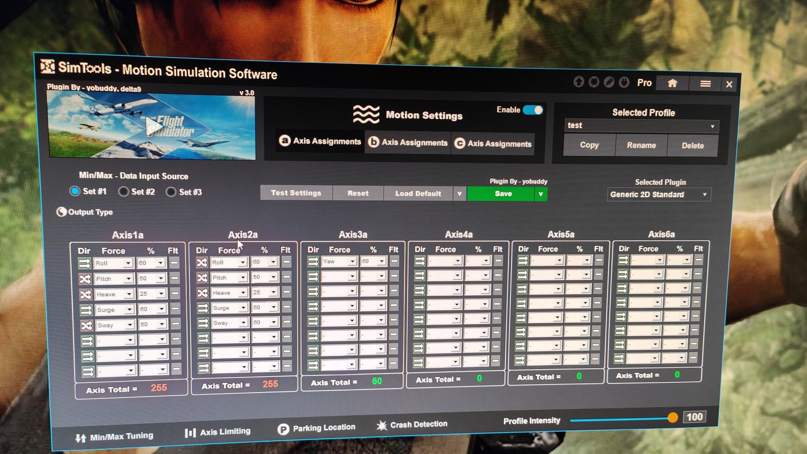

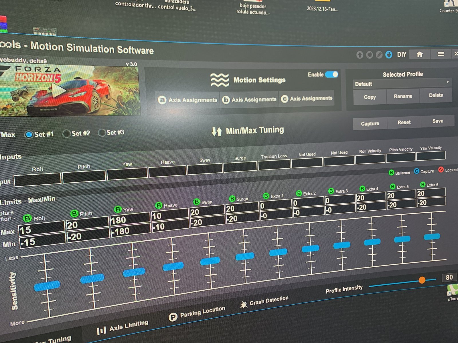

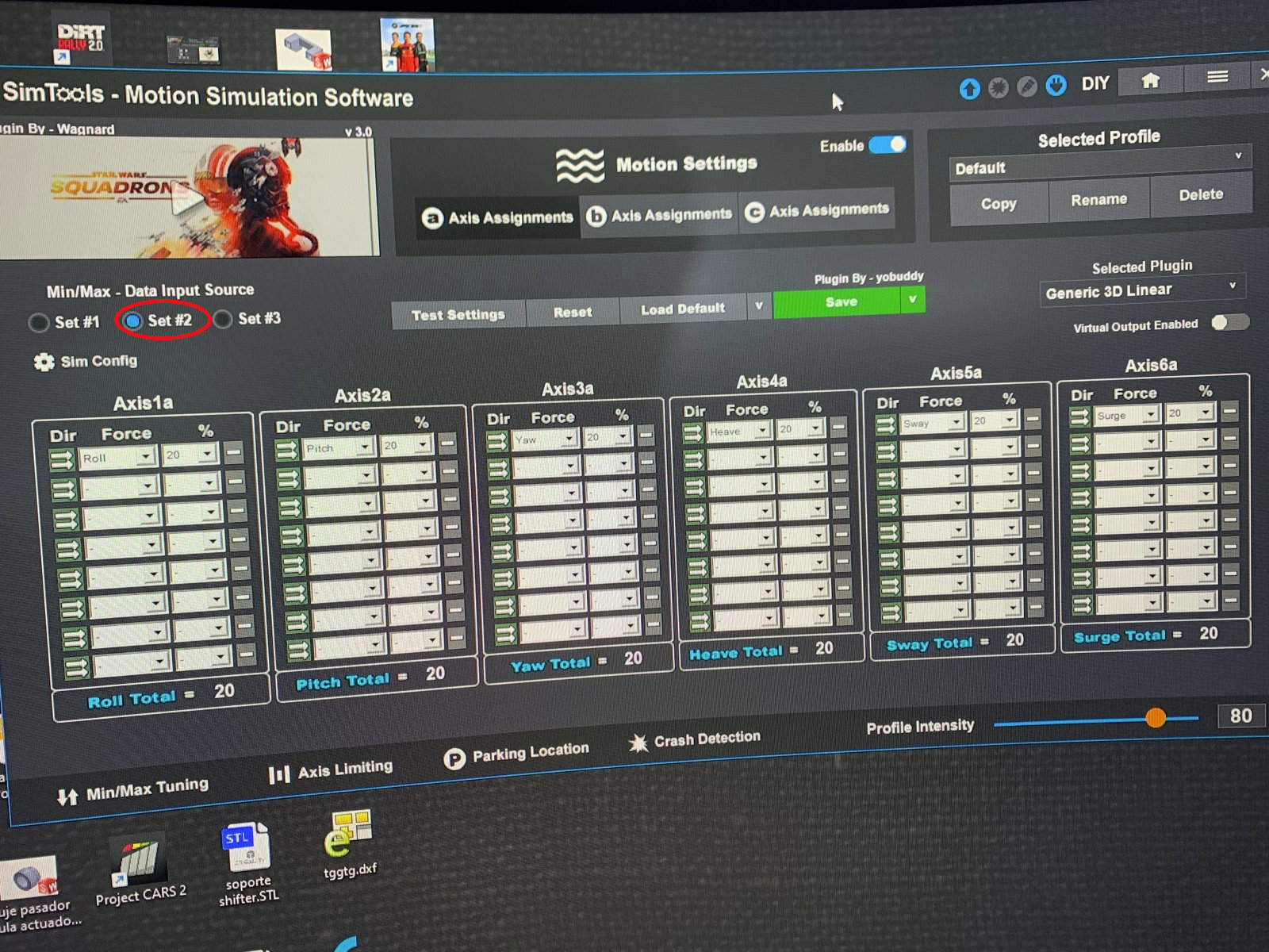

    I have a problem with Star wars squadrons plugin and Forza Horizon 5, I can capture min max data but there's no motion, any idea of what might be!? all the other games are working fine
  15. noorbeast
    22,228
    154,837Coins
    +11,227 / 57 / -2
  16. Jean Paul Andrade

    [​IMG] [​IMG]

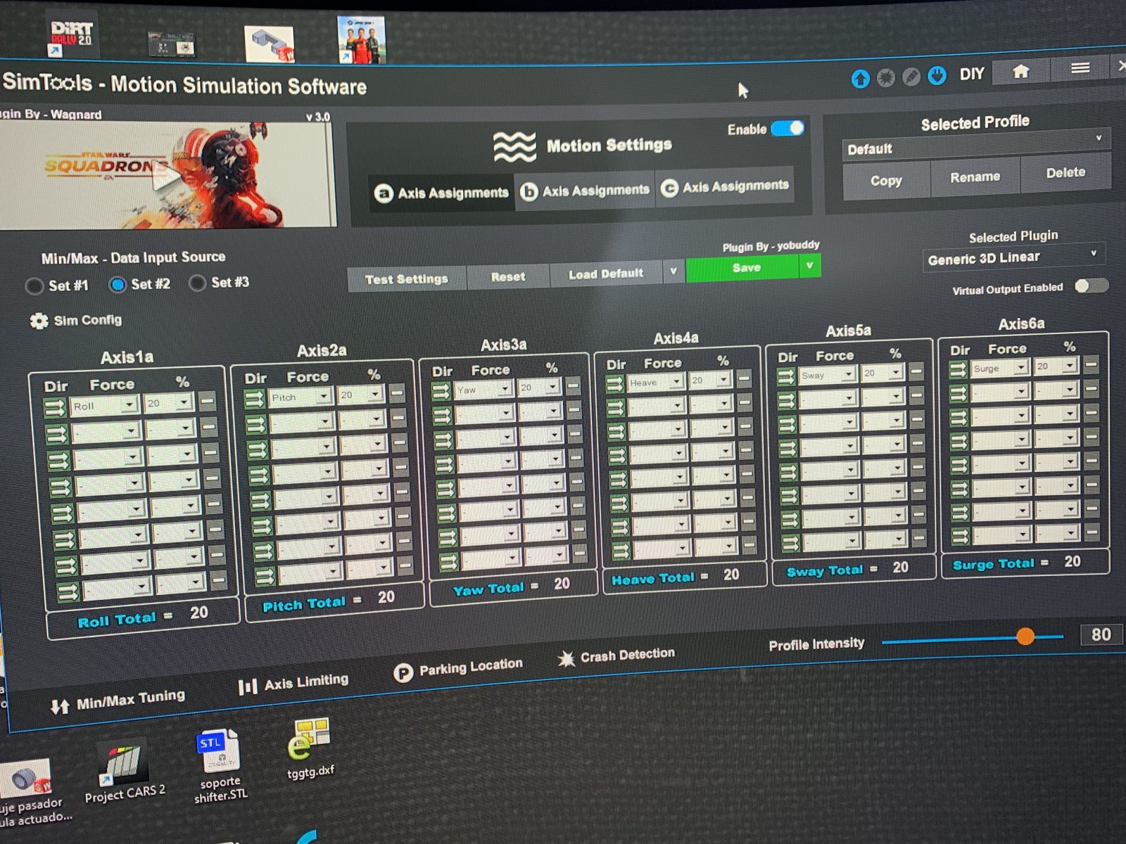

  17. yobuddy
    51,773Coins
    +5,206 / 19 / -0
    My guess is you have your axis assignments attached to set #2 of the max/min settings (see in the pic below), but you are showing set #1 for max/min in your first pic.
    Simply select set #1 in the pic below, and I bet you will be good to go.
  18. Jean Paul Andrade
    Jean Paul Andrade Member
    Jun 15, 2019
    86
    272Coins
    +27 / 0 / -0
    101464 [/QUOTE]
    you were totally right! Everything is working now! There is so much to learn! Thank you! I checked Forza horizon 5 and there is no data output, there must be a different thing
