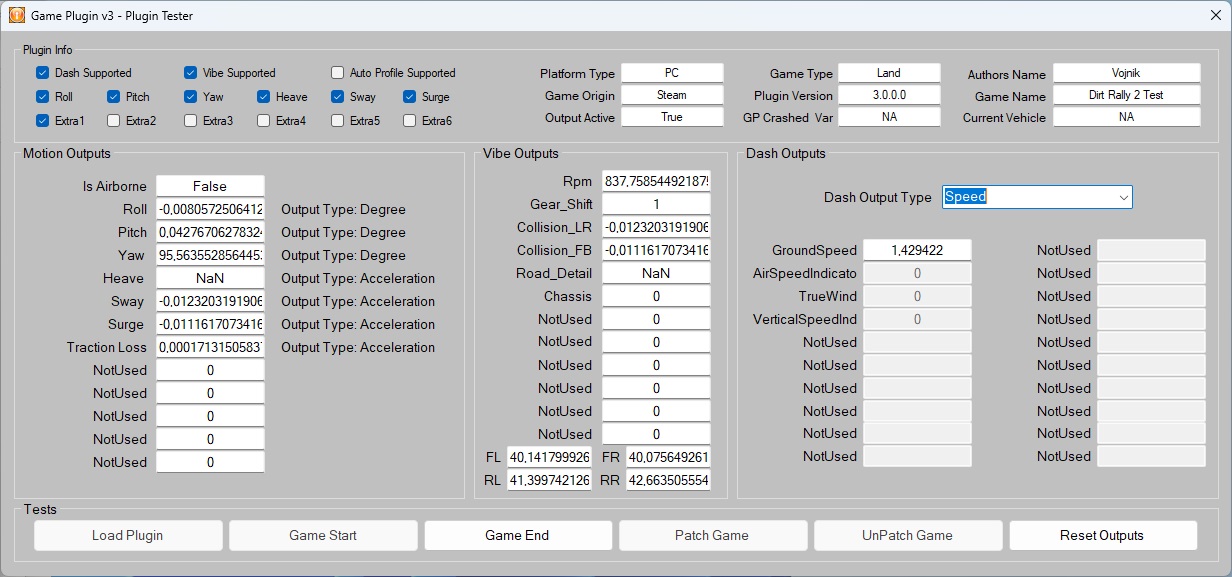

    R there any know problems with 3 motion profile or this is only my system? I have sometimes error messages profile can't be launch

    No telemetry data is received when I look under min/max tuning when using SimTools 3. The game for example Dirt Rally 2 is started with the play button but SimTools doesn't connect to the game. If I temporary enables SimHub to use port 4123 it connect to the game. The port should already be in use by SimTools but it isn't.
    SimTools 2 connects to the game without any issues.
    It's installed on a PC running Windows 11.
    I can see that the file....config.xml is patch with port 4123 under the tag motion...
    I'm running the latest SimTools SW.

    I have also tested with F1 23(stand alone) and Live for speed(Steam) without success in SimTools 3.
    Want to clarify that SimTools 2 gets motion data from Live for speed without issues and NOT Dirt Rally 2 as I wrote above.
    Is there any extra step to make SimTools 3 to connect to the game?

    Live for speed is not on steam thou?
    SimHub has automatic game configuration, so my guess is it's auto patching the games for itself.
    (As only one app can collect the game data, as the game is UDP based.)

    That's correct Live for speed is standalone. :)
    In SimHub there's a button if I want to patch the game automatically or not and I have never clicked it. I can see in the hardware_settings_config.xml that the port(4123) is still the same.
    I have compiled a Dirt Rally 2 plugin from the example project(based on Dirt Rally (1)) and uses it with the plugin tester and it works fine.
    See attached file.
    I have also used port 20777 in hardware_settings_config.xml and received data in SimHub and port forward to 4123. That also worked with my plugin in plugin tester.
    In the plugin I have added logging to file and the output is this when using plugin tester:
    2024-02-04 23:12:12 - StartUDP_GameListener
    2024-02-04 23:12:12 - Motion_ThreadReceive.Start
    2024-02-04 23:12:12 - _Start_MonitoringGame
    2024-02-04 23:12:12 - Game_ActivePackets is FALSE
    2024-02-04 23:12:13 - Game_ActivePackets is TRUE
    2024-02-04 23:12:14 - Game_ActivePackets is TRUE
    2024-02-04 23:12:15 - Game_ActivePackets is TRUE
    2024-02-04 23:12:17 - Game_ActivePackets is TRUE
    2024-02-04 23:12:18 - Game_ActivePackets is TRUE
    2024-02-04 23:12:19 - Game_ActivePackets is TRUE
    2024-02-04 23:12:20 - Game_ActivePackets is TRUE
    2024-02-04 23:12:20 - StopUDP_GameListener
    But when starting Dirt Rally 2(with my plugin) from inside SimTools3 by clicking play button none of above logs are printed.
    The plugin is never called and started by SimTool. The game is only started. Have tested with both Auto detect launched games checked and not.
    Using Windows 11 and SimTools3 from january 23 2024. Is this related to windows 11? Have also run SimTools with administrator if it is related to access rights. Have used default installation directory.
    Have no more ideas!!
