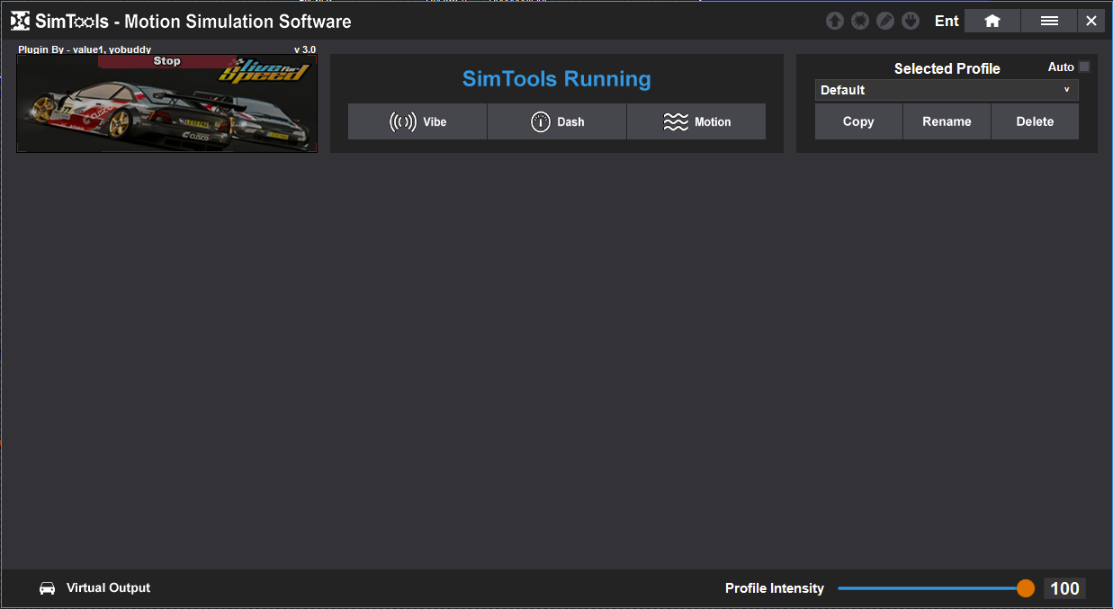

  10. yobuddy
    51,773Coins
    +5,206 / 19 / -0
    The game plugin will not be called if an interface is not setup and at least one is working.
    (Otherwise SimTools thinks that it has nothing to do.)
    Please setup the Network interface plugin, and simply send the data to 127.0.0.1, port 6123 (or any port that is not used).
    I believe setting up the network interface will give you the action you are looking for with your game plugin.
    Take care!

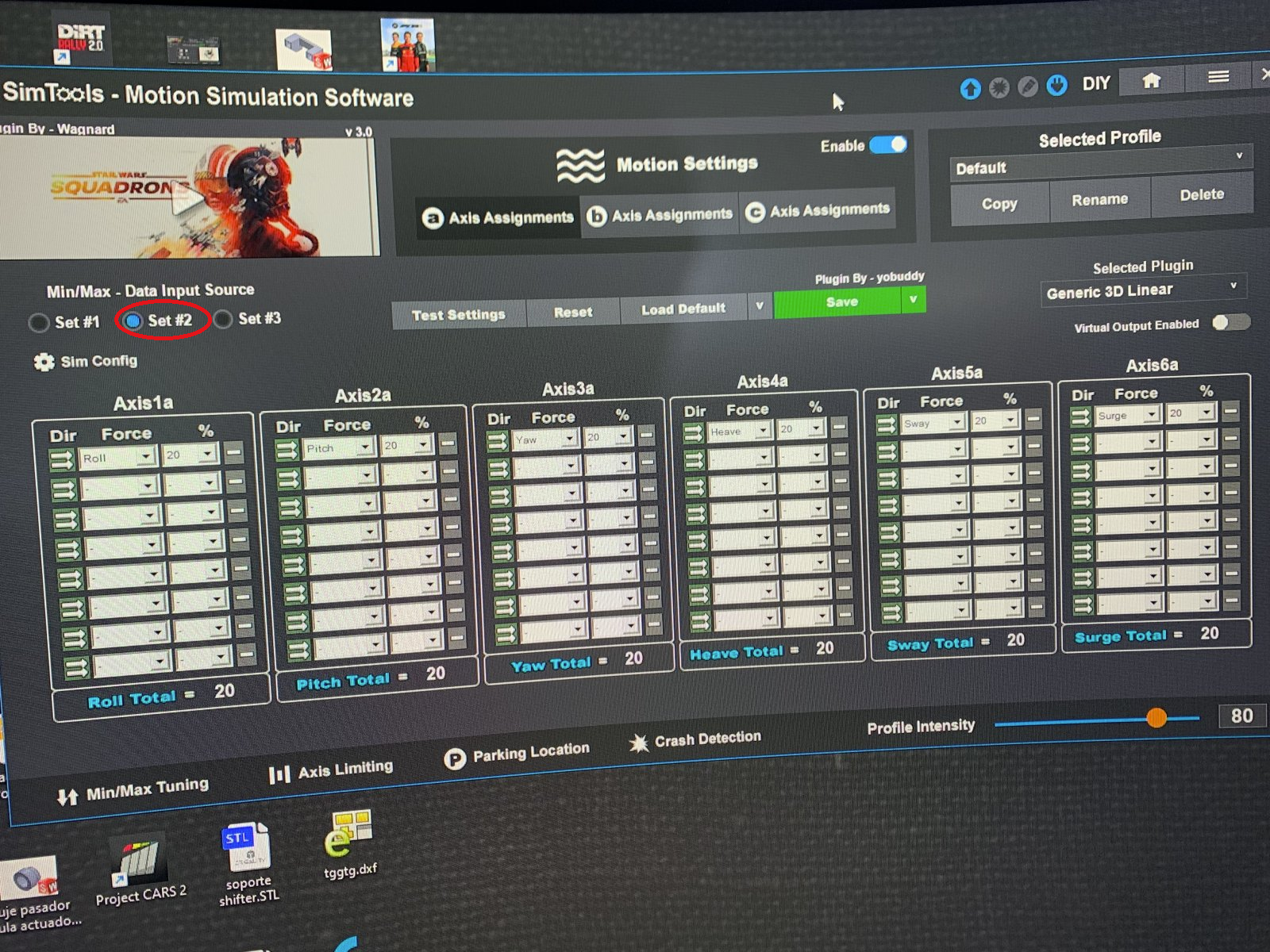

    Hi! Do you have any issue with starwars squadrons like ""start error
    indice fuera de los limites de la matriz
    en Squadrons_GamePlugin.GamePlugin.GameStart()
    520_Offsets.xml or config not found! Patch game again!""?
    I can't solve it
    ""start error
    I can't solve it

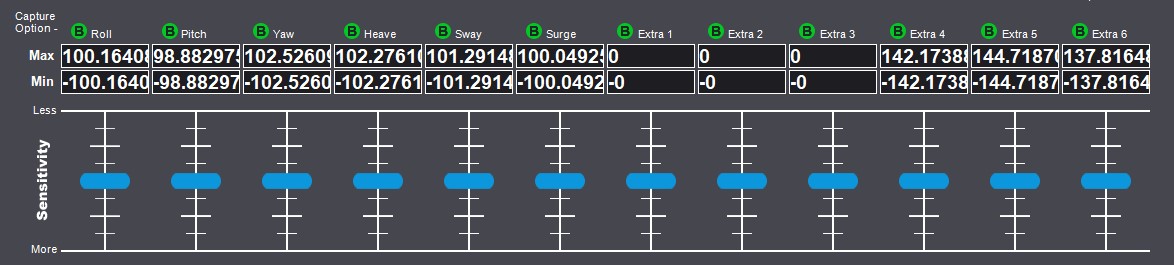

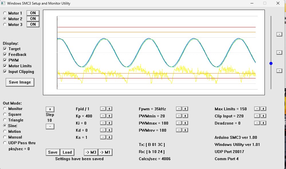

    I have now given up trying to use FS2020 with Simtools 3, it is unplayable, in incredibly over sensitive, axis limiting seems to have no effect, it's like being on a rollercoaster.
    I use the sim with F12023 and Assetto Corsa with no issues whatsoever.
    Is anyone using Simtools 3 with FS2020?
  16. itsumairu
    itsumairu Active Member
    Dec 13, 2021
    210
    Psychologist
    Indonesia
    440Coins
    +92 / 2 / -0
    2DOF, 3DOF, DC motor, Arduino
    its not the axis limiting, have you tried to fine tuning on "min/Max Tuning" tab?
    to my understanding, its that tab that responsible for the "sensitivity" of the motion.
  17. Richard Eaton
    Richard Eaton Member
    Oct 4, 2023
    88
    241Coins
    +11 / 1 / -0
    Hi, thanks for the reply, yes I've done tuning to death, to the point where I've set all axis to 100% but it makes little or no difference, at that setting it should move like a sloth.

    what platform do you have? can you send us your settings?

    I just updated to the latest version of simtools v3 (havnt updated since last September) and fs2020 still works, but no longer getting any telemetry for DCS. I updated the plug in and validated that the export.lua was written. Anything else to check?

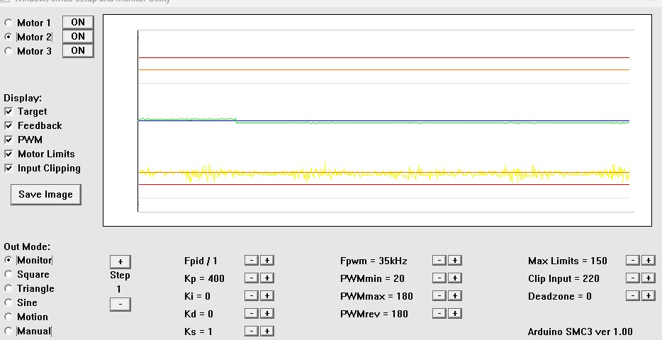

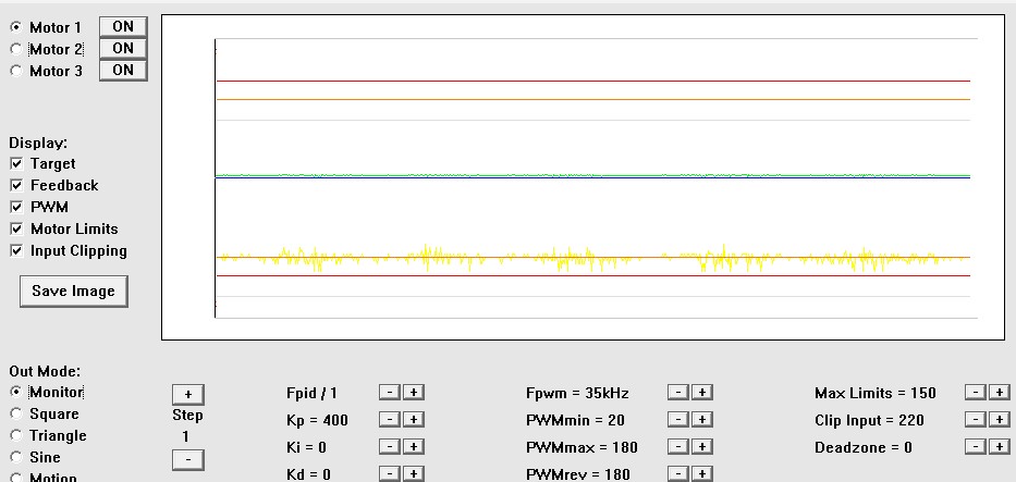

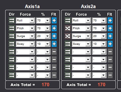

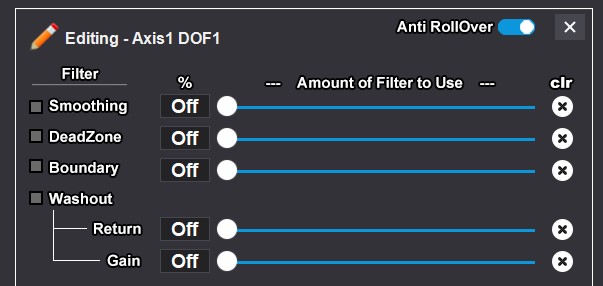

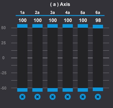

  20. Richard Eaton
    Oct 4, 2023
    88
    241Coins
    +11 / 1 / -0
    Hi, please see below settings in simtools and SMC, my platform is a 2DOF central pivot with rear motors Screenshot 2024-02-02 172436.jpg Screenshot 2024-02-02 172436.jpg Screenshot 2024-02-02 172457.jpg Screenshot 2024-02-02 172511.jpg Screenshot 2024-02-02 172533.jpg Screenshot 2024-02-05 121224.jpg Screenshot 2024-02-09 165343.jpg Screenshot 2024-02-09 165418.jpg
