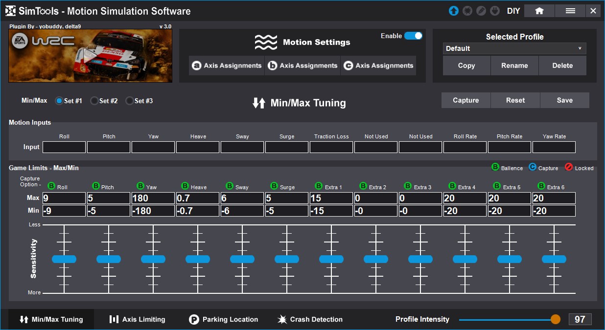

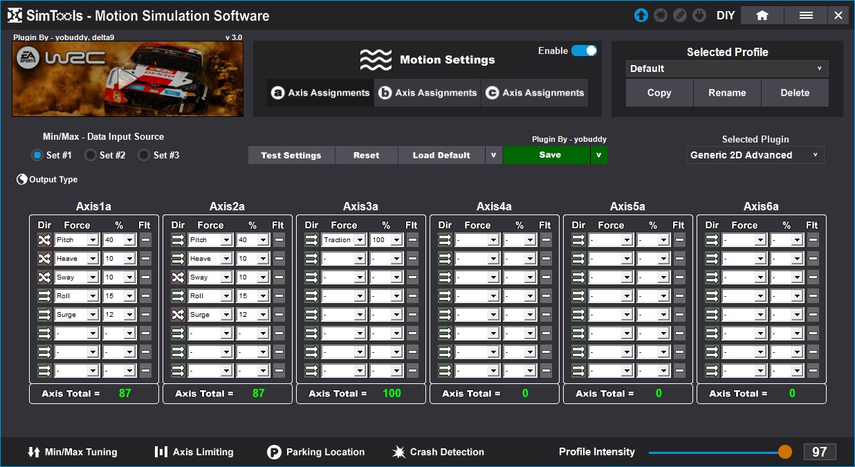

    2DOF, 3DOF, DC motor, Arduino
    the number here is so high. for me its between 5-10. so do change the number of fine tuning, between that number. a 100 is a no.
    and, if I'm not wrong, the sum of the axis is 100-120 max (ideally), yours is 170, so you should put a number that between that numbers. make the roll and pitch a 30, its enough

    here is my settings for the EA WRC.

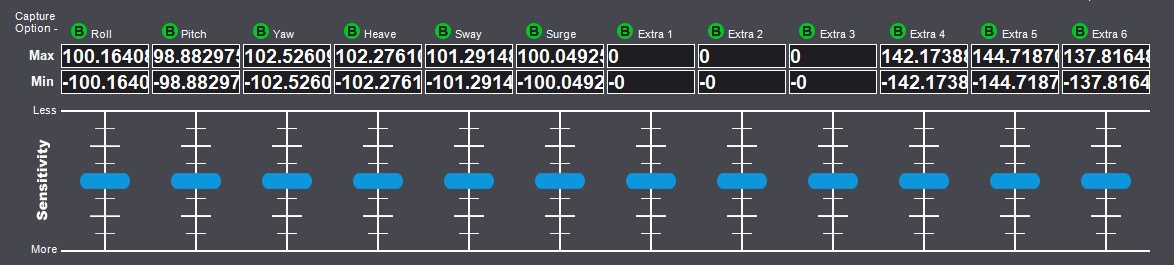

    Hi, racing and Flight Sim are 2 very different things, for Flight Sim you can have a much higher axis total. Also the the fine tuning works as the higher the number the softer the movement, so having mine set to 100 was a test to see if it made any difference, it didn't. I have also run the simulator based on the captured settings.
    Racing in F1 2023 and Assetto Corsa is fine, I have no issues.

    Yes, tried intensity, it just seems the data coming from FS2020 doesn't seem particularly accurate....I think it's a FS issue rather than.
    I'm currently resetting the FS profile and starting again firstly capturing the axis movements one at a time....
