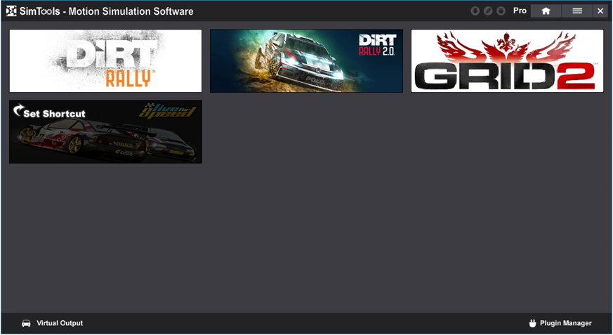

    Hi. I have DCS Standalone and the plugin wants me to start dcs from steam. Is there any non steam dcs plugin ?
  5. yobuddy
    51,771Coins
    +5,206 / 19 / -0
    Setting a Launch Path – You may find that some game plugins do not set a launch path for a given game plugin, or the path is setup for a different version of the game than you have installed. To update a launch path for any game plugin, simply drag and drop the games exe or shortcut on the banner for the given game plugin.
    Hope this helps buddy!
