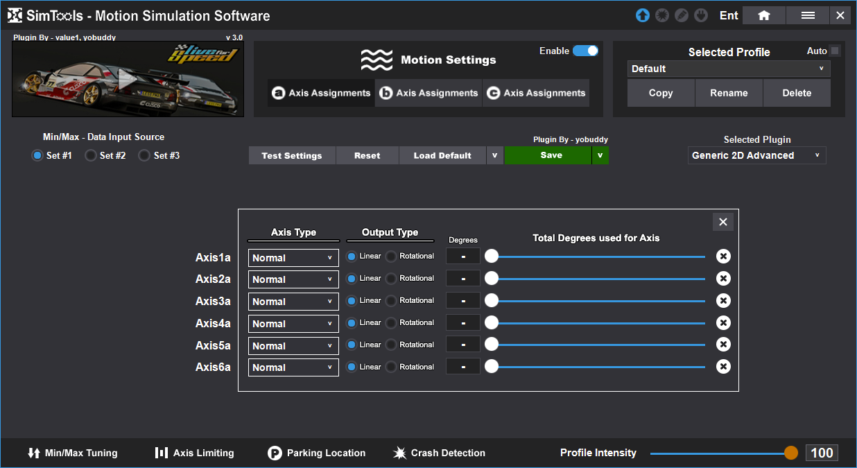

    I set it up to 120° and 70% in simtools and test axis.. I do not see any changes. Will be affect only in game and not when I test the axis?

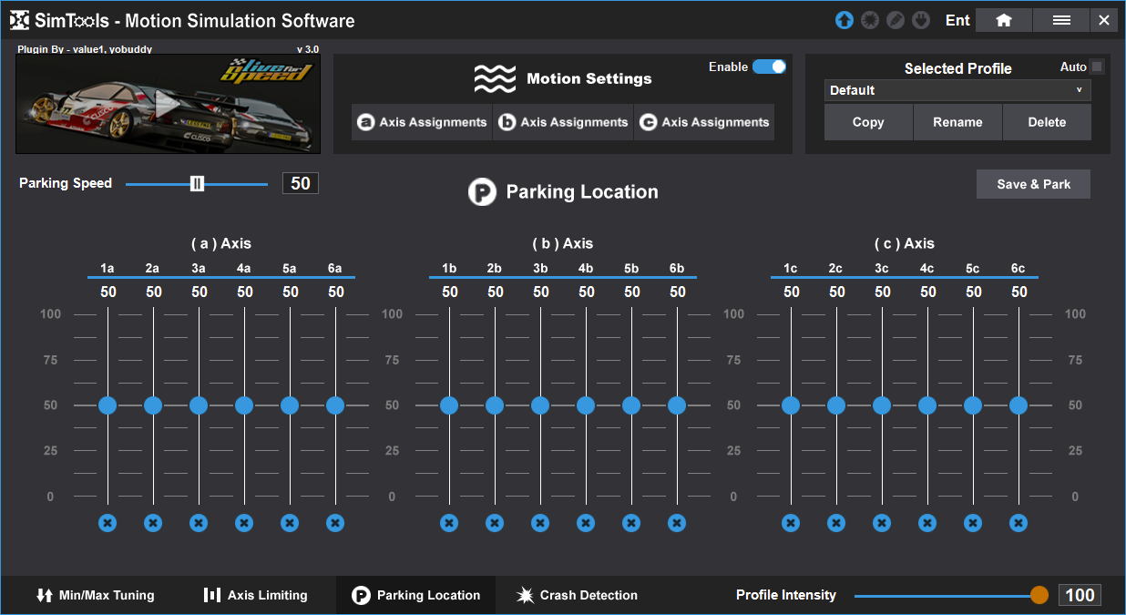

    further I wanted to mention, that the parking position does not work. Every time I start a game, the simulator is jumping to parking position and I have the speed to 1.
    Only when I tested and push the button, save and park will be parking slow.

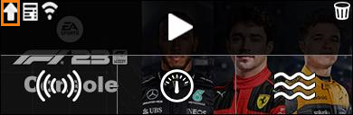

    Hi, My Simtools V3 is telling me there are updates and plug-in updates available but I can’t see a way to update. I think previously it has asked if I want to update and I’ve said yes but this time the option didn’t appear.
    thanks

    Take a look at your installed plugins, my guess is one of them has an update icon, like I have circled in orange below.

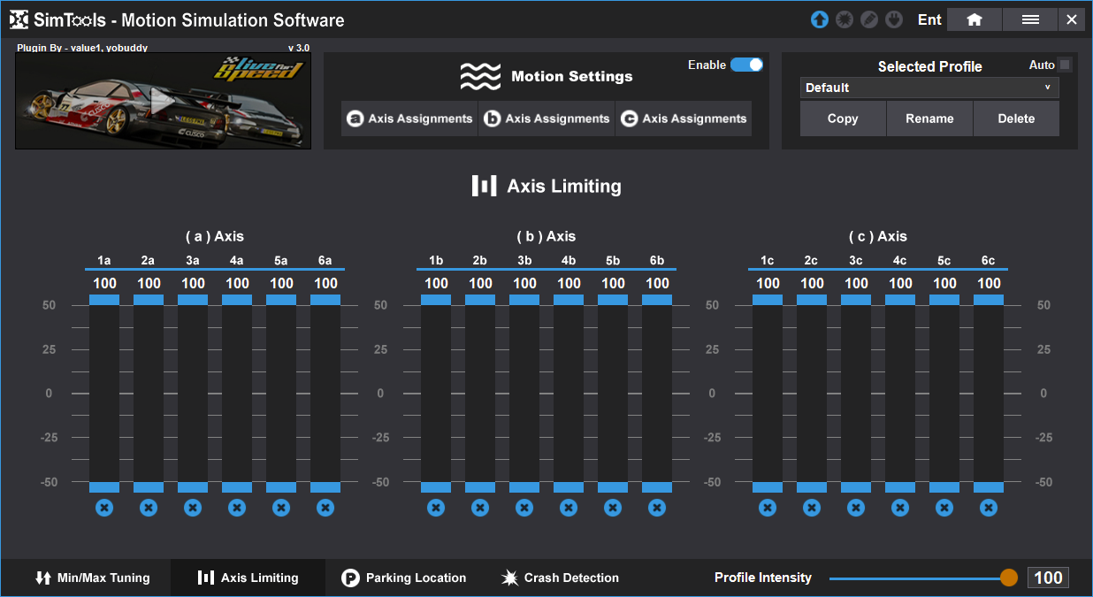

    Is the axis limiting linear? I don’t think so. Because I set axis 1,2,4 and 5 to 70% and I don’t notice anything. Then I reduced to 35% and know it seems to be about 70% when I test the settings.
    Also I set the smc3 clipping limit to 255 and max limit to 90. know I am about 70%
    As I know from the manual the output type in the advance 2d generic settings are for seat belt tension.
    For explanation, I would like to use 120 ° of range of motion. Like sk1 from simukit. The rod is mounted half way between ctc lever and motor shaft. So 6,74 ctc the rod is mounted 3,37cm. So the heave way is near linear.

    Set the location you want and click save and park, now start a game and the sim will slowly center for the race.
    Exit the game, and the sim will slowly go back to its parking location.
    SimTools expects your sim to already be at it's parking position at the start of a game.

    When it is linear, is 100% is equivalent to 360 degrees? I thought is equivalent to 180 degree.
    Further I thought that parking position is center?!

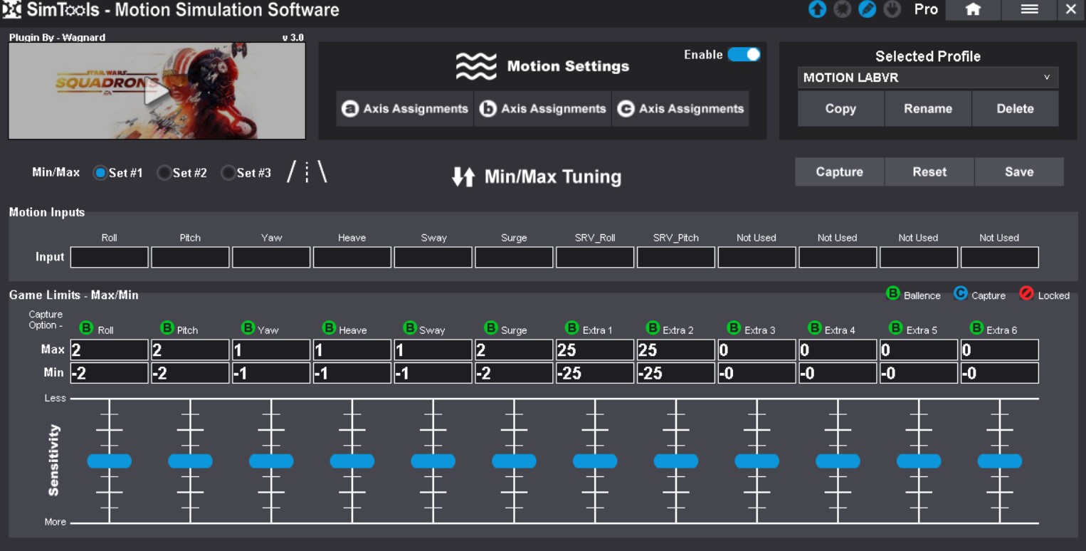

    For anyone having problems with the game Squadron with Simtools 3.0.
    Follow the step by step:
    - In the Min/Max tuning Tab, click on CAPTURE, fill in the values:
    Rool: 2, -2
    Pitch:1,-1
    Yaw: 1,-1
    Heave:1,-1
    Sway:1,-1
    Surge: 2,-2
    Extra 1: 25, -25
    Extra 2: 25, -25
    Once done, press Stop and save!
    Additionally, you will need:
    1. Go to the \SteamLibrary\ steamapps\common\STAR WARS Squadrons folder. Then change the file name: starwarssquadrons_launcher.exe
    for
    starwarssquadrons_oldlauncher.exe
    2. In CMD with administrator privileges, access the \SteamLibrary\ steamapps\common\STAR WARS Squadrons\ folder and type the following command:
    mklink starwarssquadrons_launcher.exe starwarssquadrons.exe
    This will create a symbolic link of the file name.
    Once this is done, access the Game through Steam itself.
    Motion will only work in story mode. In phase 5 of story mode it will not work. Then it works again in phase 6.
    @Wagnard
    Can anyone put this information on the notes page for this plugin?
    It took a lot of work to achieve this and there must be a lot of people with this same problem.

    Do you mean when axis assignments are set to linear? if so then it means the jump between stop points is all the same amount or distance. As SimTools does not know if you have a linear actuator, a rotating actuator with a 360 pot or 180 pot connected and so on. So it just depends on what you have connect to your motion interface. I hope this helps?
    It is center, unless you change it on the parking location page.

    Apologies for the misunderstanding. I was referring specifically to the axis assignment when using a rotational motor, questioning whether the 0-100% scaling is linear or if it follows an exponential or logarithmic curve, equivalent to 360%. To my understanding, this would mean setting it to 35% is equal to 70%, which is approximately 126 degrees. Because when I set the axis limit to 70%, the lever moves almost 180 degrees... My potentiometer ranges from 0-5V and covers 360° in a 1:2 ratio, so a 180° movement of the lever equals one full rotation of the pot.
    I haven't changed anything on the parking location page, only the speed. What I've noticed is that when the motors are powered on and idling, and no motion program like SimTools, FlyPT, or SMC3Utils is running, just the Arduino and motors powered up, the rig jumps from 5% to about 30%. When I test the axis assignment or start a game, it jumps to center (50%).

    The scaling is linear by default, unless it is changed in the axis assignment setting.
    Although your pot is 360 deg, your 2:1 lever moves 180 degrees. If so, then setting this to 50% would give you about 90 degrees movement on the motors lever I believe. (or 180 deg on the pot)
    Just making sure you don't mean axis limiting?
    Because this simply shrinks the same output, or simply reduces the amplitude of the output. So when you set one to say 50%, its the same movements as when set to 100%, but simply in half the space. (is it now will only use half of the available axis)
    So this means the sim is heavy enough to move the motors out of place when the power is off. It does not mean the motors are not big enough or anything, it's just that the gearing and motor setup won't hold the sim in place when powered off. I would expect the cis to actually jump to center when turned on, but maybe your motor drivers are in low power mode or something until communication starts?
    Since your sim jumps to about 30% when powered on, try setting the parking location to that same spot.
    (you may want to put the parking speed back to 50%)
    Then when a games starts, the sim will slowly lift to 50% (instead of jumping there). And when the game is closed, the sim will slowly go back to the parking location 30%.

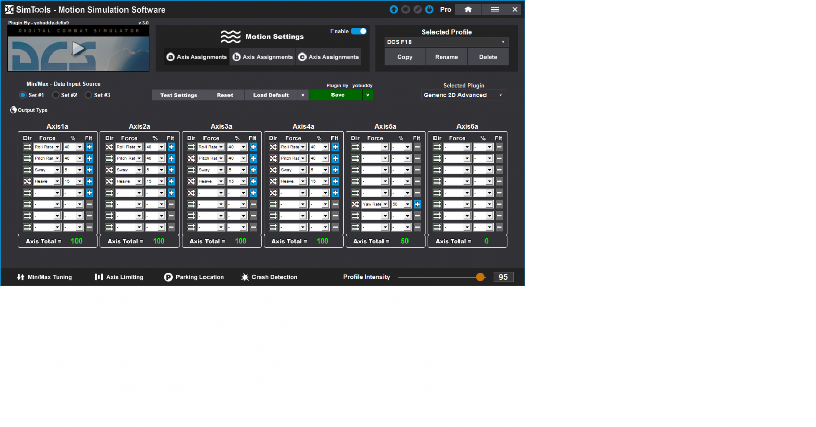

  19. Moe Colontonio
    Moe Colontonio Member Gold Contributor
    Dec 9, 2017
    131
    New Jersey USA
    827Coins
    +32 / 1 / -0

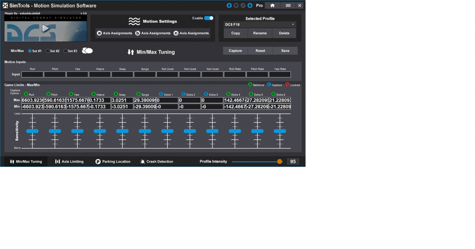

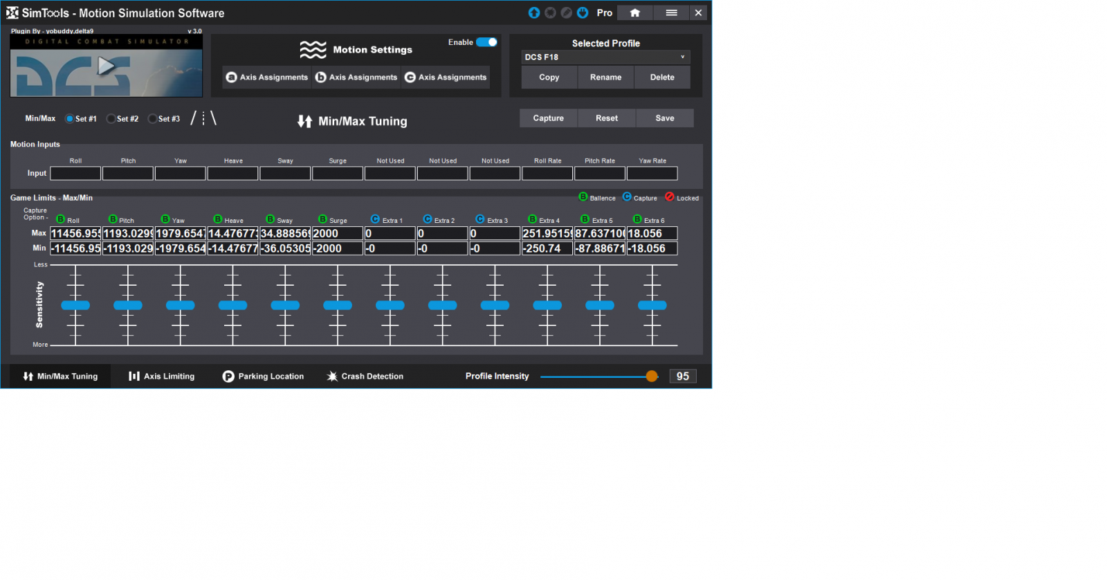

    Been messing around with setting up V3 with DCS, and getting some wackiness. Any suggestions are appreciated.
    -On the ground, any application of brakes, or when taking off from a dead stop, I'm getting extreme vibration/chattering in the rig.
    -When I fire the gun in the F18, I get teeth chattering vibration, similar to what's coming through on the brakes.
    -In general, I'm getting a lot of jumping and what feels like junk feedback while maneuvering.
    -If I use SURGE at all, while on the ground sitting still, I get a rhythmic seesawing of the rig. I can tune this out by increasing values in min/max tuning, but then I lose the accell/decel pitching I'm going for in the rig.
    I have an SFX100 based 3DOF with Heave & Traction Loss
    Below are pics of my values.
