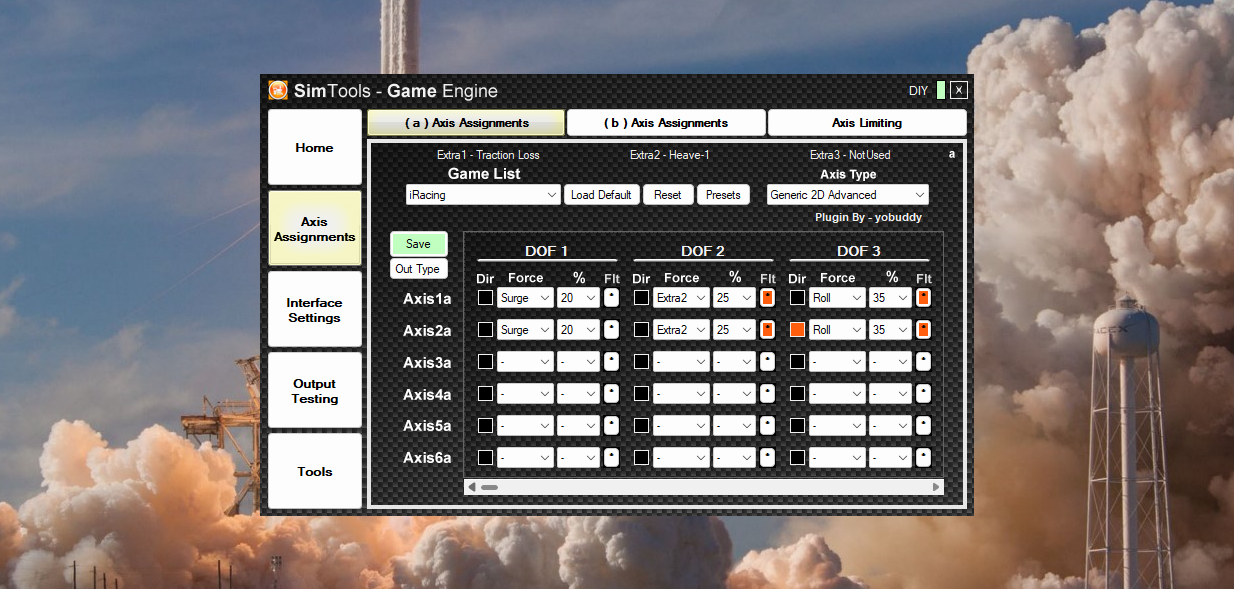

    Hello. I've been trying to set up SimTools 3.0 for a long time and my success is so-so. The main problem is that I don't understand how the heave setting works in almost all games. One gets the feeling that a very limited amount of data is being transferred. I tried to copy the settings from simtools 2.6, it didn't lead to anything. Very little movement. I tried to adjust the min/nax settings, and I get either strong shocks or no movement. Simtools 2.6 has a constant stream of data that creates the effect of vibration from the road surface. What am I doing wrong?

    Can you post some pics of you settings?
    You probably just need bigger Max/Min settings for heave, but if you post pics, we can look it over.

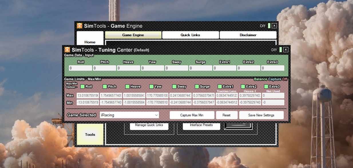

    I'v been investigating heave too, with AMS2 and iRacing. My rig has been working like that lately, too: a bit too strong and harsh at "normal" values, and very little movement or no movement at all when is min/max is set higher. I seem to have lost that "suspension" feeling with cars. I can´t figure out why.
    You might want to check this in your PC, if you are driving iRacing. Today I noticed this, I wonder it this is normal: In iRacing when a car is stationary at the pits (Mazda MX-5 or Kia Optima) there is constant 0,99 heave. I mean, car is at level tarmac and it gives nearly 1 heave. Why? I wonder it that pluging is working normally? I recorded mix/max values for heave while driving around at Lédenon. Result was -0 and 2,79. It this normal, zero heave to negative direction, even when driving steep downhills/uphills?
    EDIT: When I first tried v3 beta it felt amazingly good. But lately no so much. Sometihng has changed, but what...?
    Any comments on that = 0/2,79 heave thing?

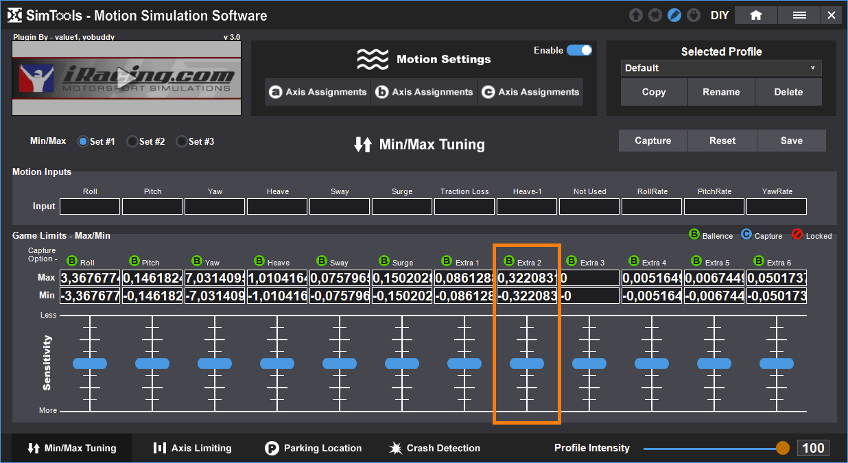

    Ok. Thats my settings in simtools 3.0 and in 2.6
    In addition to the problems described above, I also noticed that in SimTools 3.0 there is a strange behavior that the heave disappears even with a minimal turn of the steering wheel. Both in Lemans Ultimate and in Iracing I clearly observed such an effect.

    The game outputs the data with gravity included, which is 1g so that's what you are seeing. Extra 2 is heave -1 for a quick fix. This plugin is basically the v2 plugin updated for v3, and will receive some fixes before its finished. We are about 60% of the way thru all the plugins now looking for proper direction, adding traction loss for vibe, and a few other fixes too. This title is still on the list, we will get there shortly.

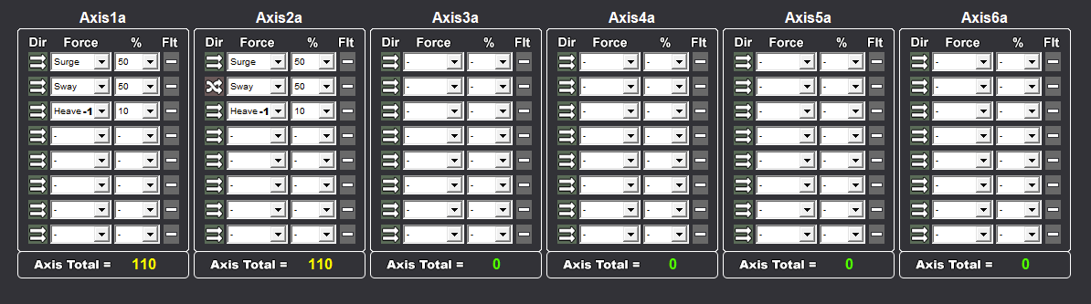

    IRacing could happen with a bank, lemaus the data is directly from the game so it should be good to go.
    Please try setting the value for extra 2 to +1.5 and -1.5
    And then maybe something like this
    You can increase heave to 20% if you want, but I would not go much over that.
    Please give it a shot, and let me know what you think.
