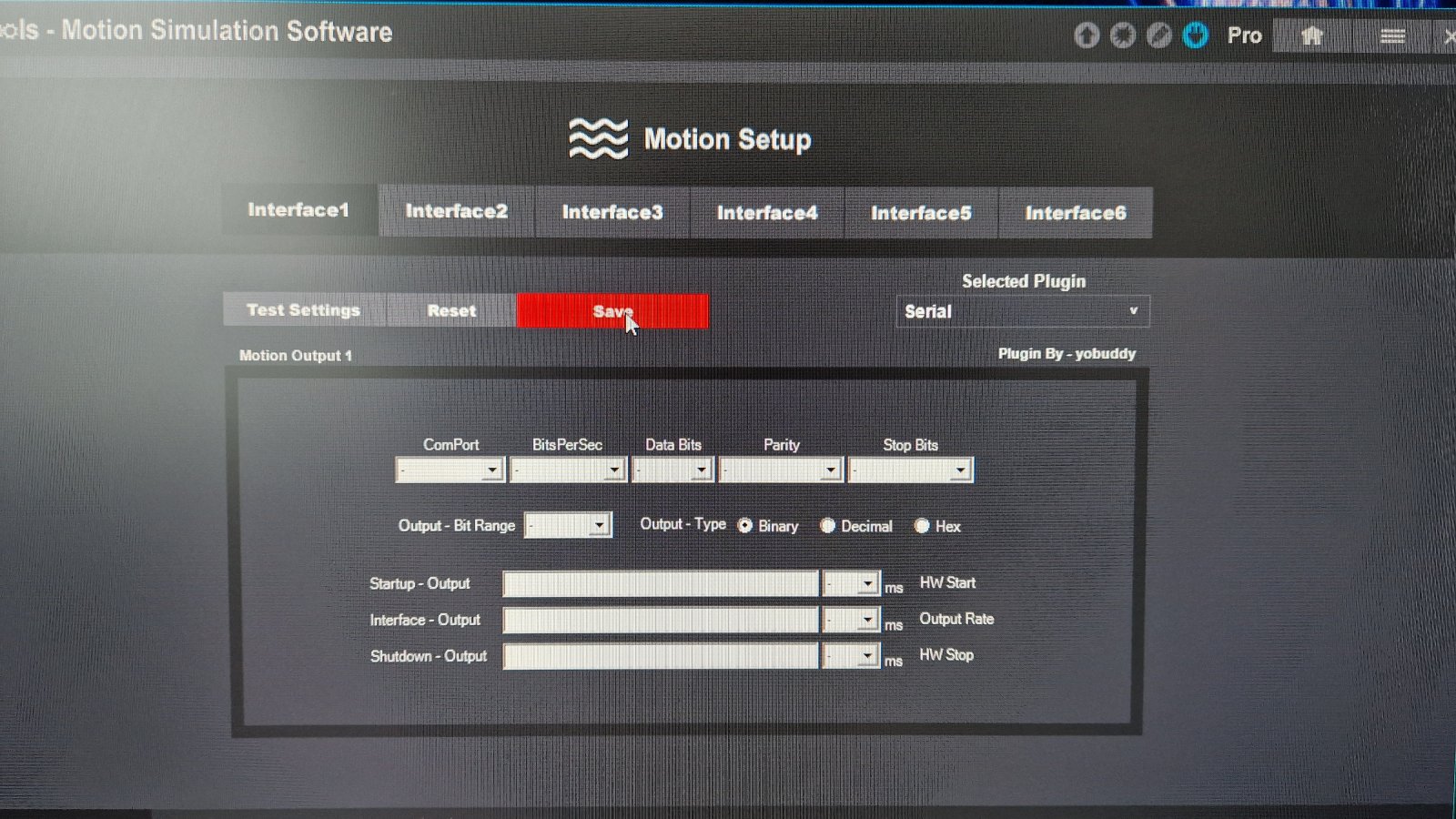

  3. Felix_31
    Felix_31 New Member
    Sep 26, 2023
    13
    88Coins
    Can someone tell me, why i cant save my motion setup? The Save Button is everytime Red. And if im trying motion, nothing happens.
  4. Felix_31
    Felix_31 New Member
    Sep 26, 2023
    13
    88Coins
    This is the photo
  5. ProjectF1
    ProjectF1 Member
    Jun 12, 2023
    53
    Electrician
    301Coins
    +17 / 1 / -0
    AC motor, Arduino, 4DOF
    I think we need to fill in and complete the table
  6. Trent Robinson
    Trent Robinson Member
    Nov 21, 2023
    65
    Systems Engineer
    360Coins
    +16 / 2 / -0
    3DOF, AC motor, Motion platform
    There's nothing to save yet. Populate the interface output field and the save should turn green.

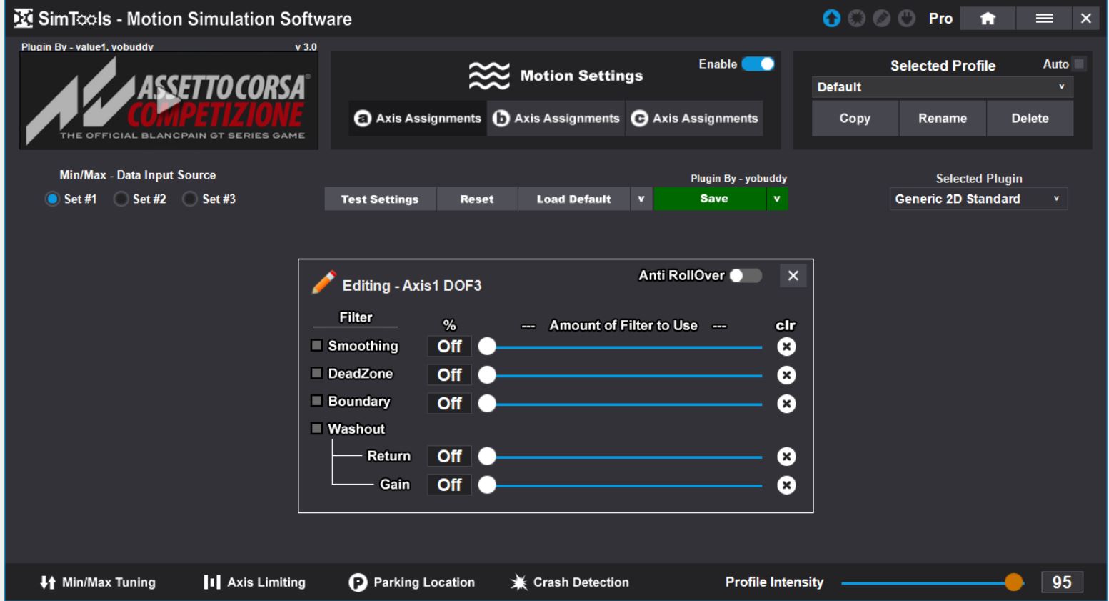

  8. Sin.Schumi
    Sin.Schumi Member Gold Contributor
    Aug 2, 2015
    44
    - 18Coins
    +8 / 0 / -0
    SCN5
    Hello Yobuddy
    After a long Time i had a new Test with Simtools 3 and ACC and RF2 AC
    With Simttols 2.6 evertihing is work fine, with 3 iss all of them the Stuttering so the Actuartos feel like moving in 1% Steps but with normla Motion Effects..
    I try the MIN/MAX Capure with 1 Effect no positive result :(
    So when i ride with 1 Effect the Stuttering iss all so...
    My 4 Actuartors are the Platform, 5a the Sway AirGeforce and 5b Surge is an Extra Actuartor and 6 iss Platform Traction Loss ;)
    So everthing iss good configurated ;)
    I try to make a video

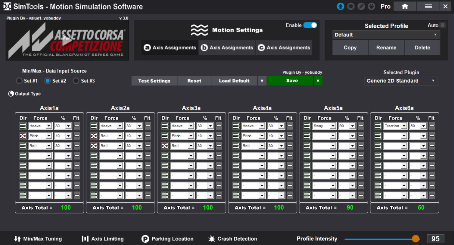

  9. Sin.Schumi
    Aug 2, 2015
    44
    - 18Coins
    +8 / 0 / -0
    SCN5
  10. yobuddy
    51,771Coins
    +5,206 / 19 / -0
    What does your axis assignments look like?
    My guess is your using the rate outputs for roll, pitch or yaw and not using washout?

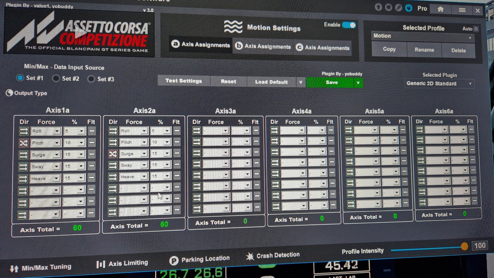

  12. yobuddy
    51,771Coins
    +5,206 / 19 / -0
  13. Sin.Schumi
    Aug 2, 2015
    44
    - 18Coins
    +8 / 0 / -0
    SCN5
  14. yobuddy
    51,771Coins
    +5,206 / 19 / -0
    My guess is this is suppose to be pitch?
    You would get a better ride if you replaced the roll with sway and the pitch with surge btw.
    (you will find the sim reacts to your inputs much better, gas ,breaking etc...)

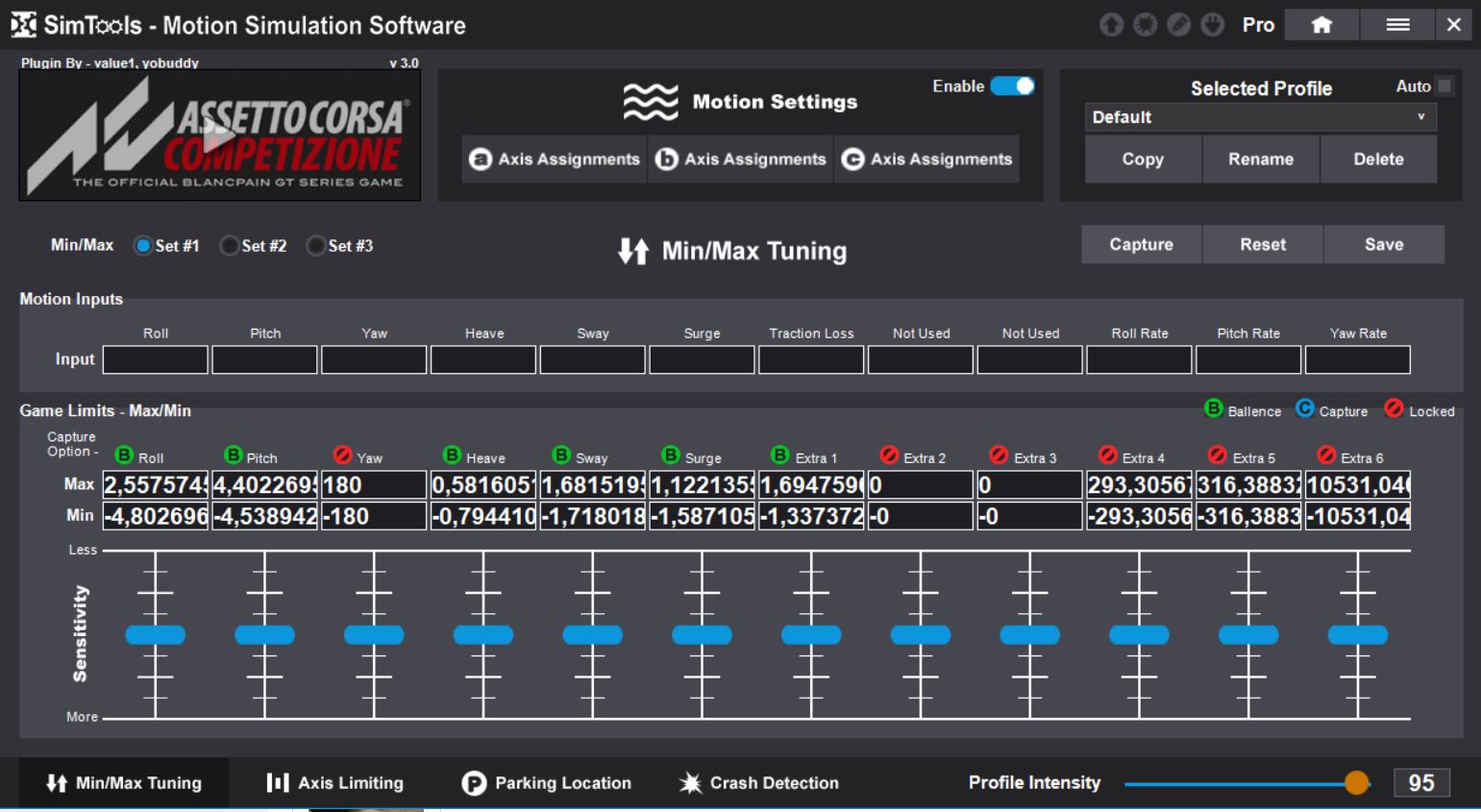

  15. yobuddy
    51,771Coins
    +5,206 / 19 / -0
    Unless you need separate max/min settings per axis assignment, I would suggest keeping the data input source set to Set #1. (As most of the game plugins have a default max/min settings for Set #1)
    Anyway, I just think it may be easier for you in the long haul.
    Take care!
  16. Sin.Schumi
    Aug 2, 2015
    44
    - 18Coins
    +8 / 0 / -0
    SCN5
    Sorry that was my Fault during the test,once again i have a new setting with one Effect and test with set 1 all so the same problem :(
    I had sent you an PM, but i think the HyperAxis Plugin has an Problem... All Test are with the problem in my Video
  17. yobuddy
    51,771Coins
    +5,206 / 19 / -0
    May I see your max/min settings for the game buddy.
    I'm currently using the scn interface with my current test sim, and the hyperaxis interface is the same code with a bit different startup routine is all. I took a quick look and I don't see any problems, but can take a better look tomorrow morning.

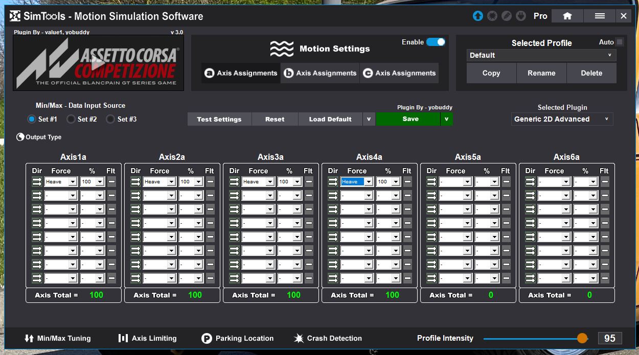

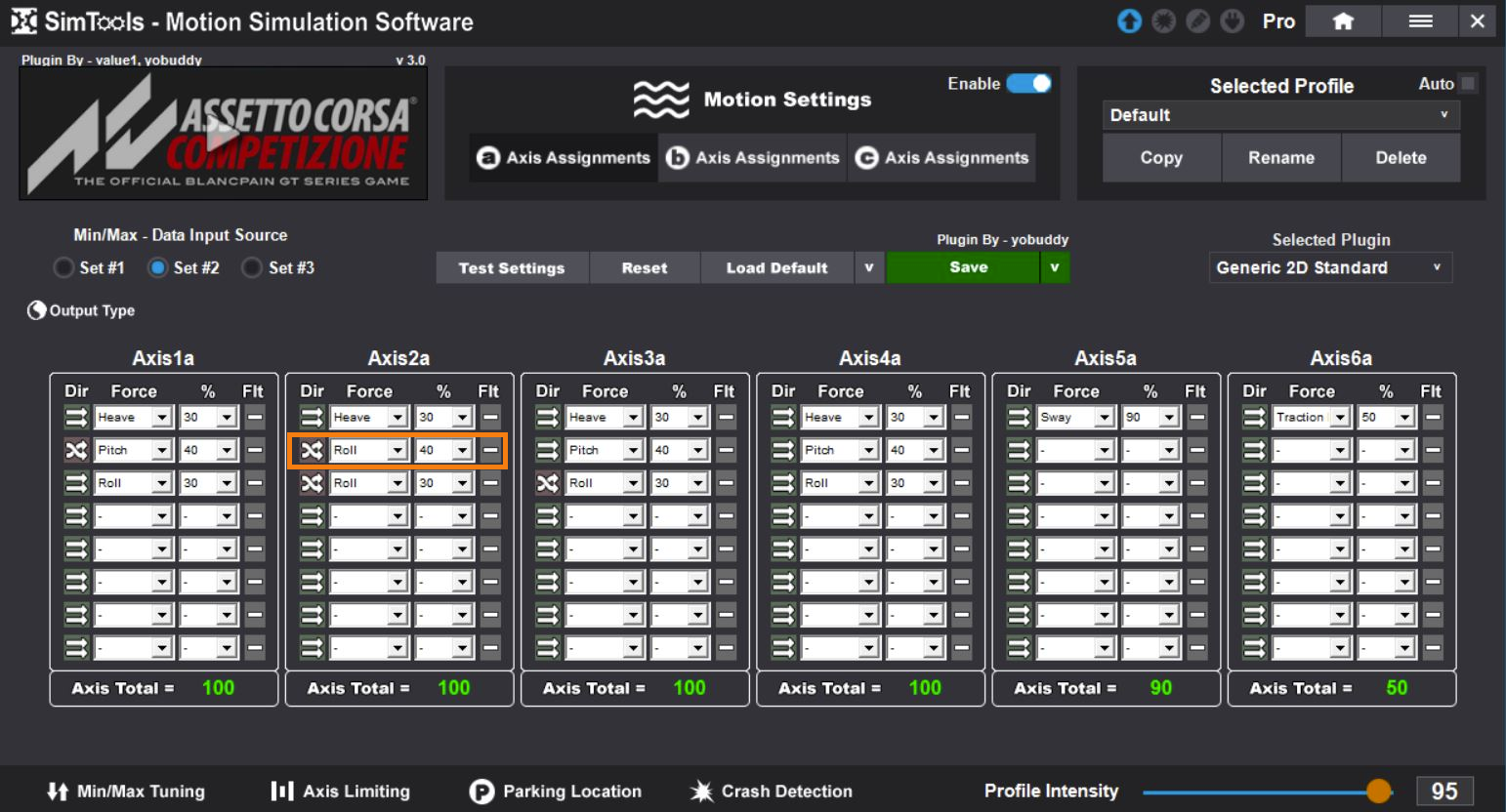

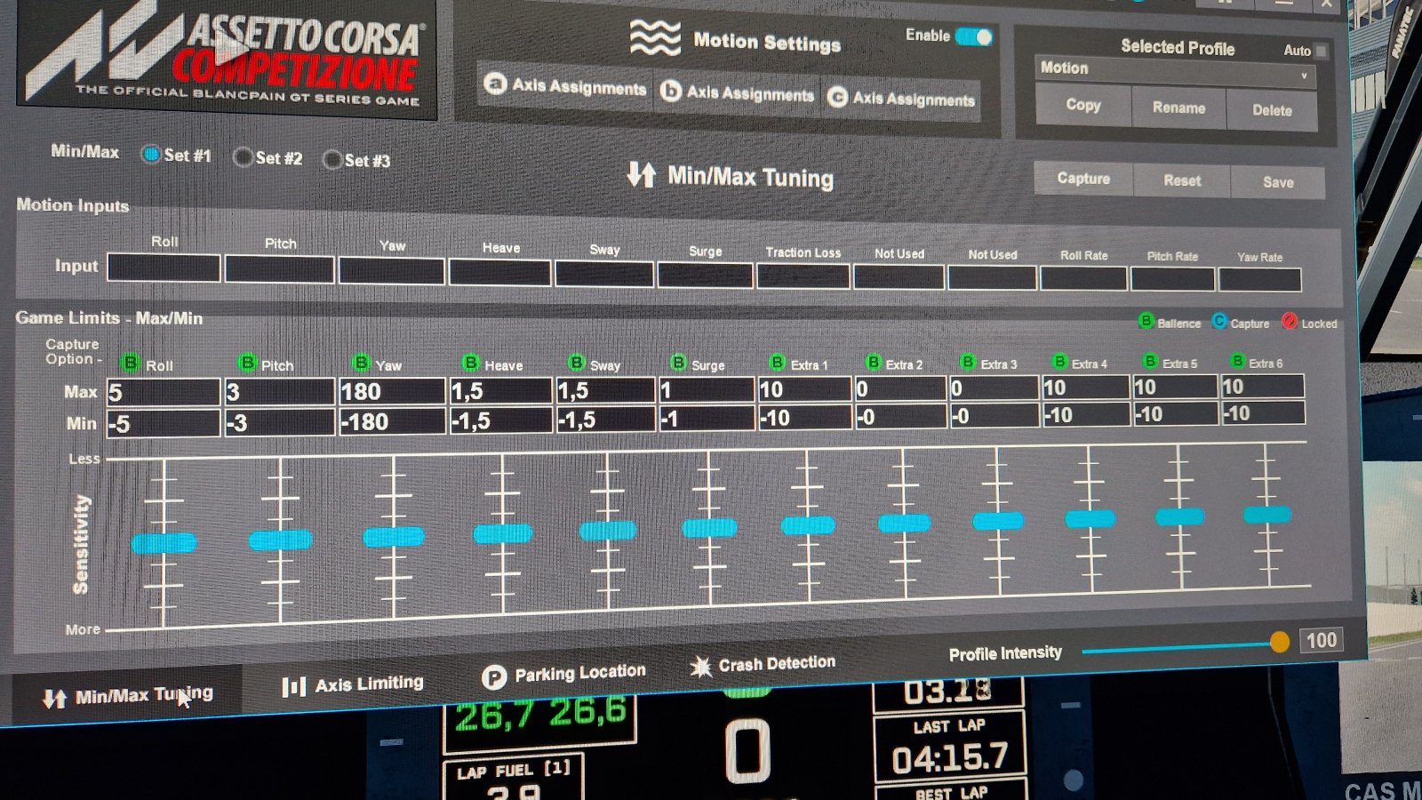

  18. Felix_31
    Felix_31 New Member
    Sep 26, 2023
    13
    88Coins
    Hello everyone, I'm currently setting up my Simtools V3 again. Does anyone have any tips for me? It's too choppy for me, the effects basically work, but it's still pretty stuttery and I don't think it runs very smoothly. I've seen videos where it looks much better. Since many of the videos are in English and I'm from Germany, it's of course possible that I haven't understood something correctly and have set it up incorrectly. I'm attaching pictures of how it's currently configured. In AC it is working better than in ACC. But im currently trying to configure it for AC. Or do you think i should use Simtools V2.6?
  19. Felix_31
    Felix_31 New Member
    Sep 26, 2023
    13
    88Coins
    I mean im currently trying to configure it for ACC
  20. Felix_31
    Felix_31 New Member
    Sep 26, 2023
    13
    88Coins
    And Acceleration is only Wirkung well in the first gear, in the other gears you are recognizing near to no acceleration.
