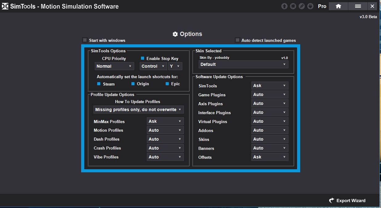

    Hey, erverthing work fine now, but the Enable Key dont work, so i try diffrent combinations , normal Control Y
    All so taping on the Field "ACC" it will restart after Clicking 4-5 times, is it an issue ??
    On Simtools 2.6 work Perfect
  5. yobuddy
    51,773Coins
    +5,206 / 19 / -0
    What is Field "ACC"?
    You will only be able to enable or disable a section when a game is not running btw.

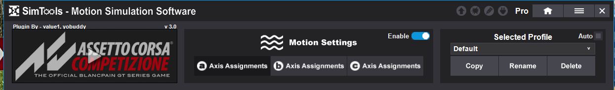

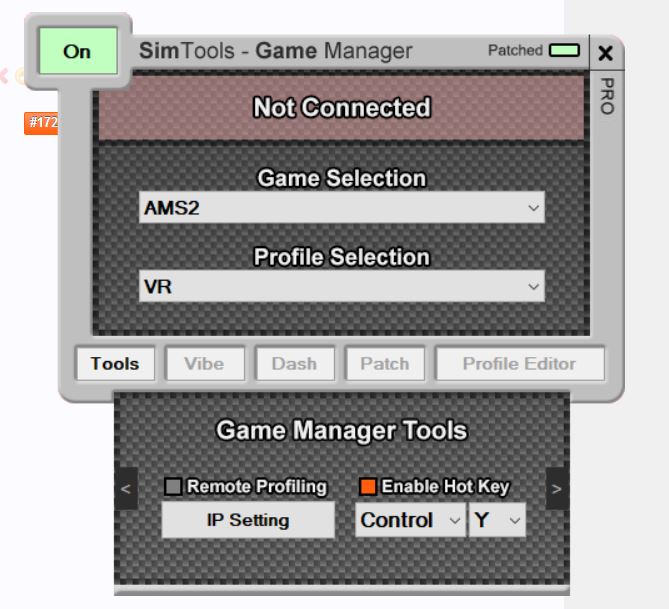

    SCN5
    "assetto corsa competizione"
    I will enable and disable the Motion with the Buttom, during the Game runs
    same like Simtools 2.6 (see in the Pic)
    When i press it there is no function.
    And with the Mouse you must click 3-8 times before an response

    I had test it, yes thats the issue, but your combination CRTL + Y are not working anymore... it will no Double click..
    So there no option to use with Streamdeck.
    Only to Stop Motion, is possible

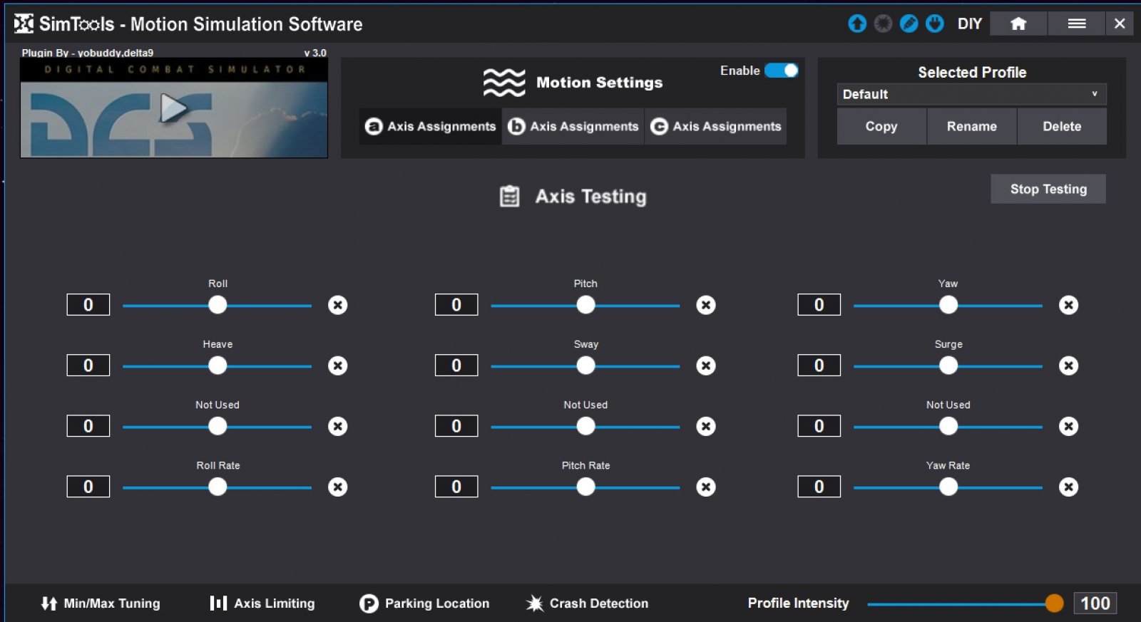

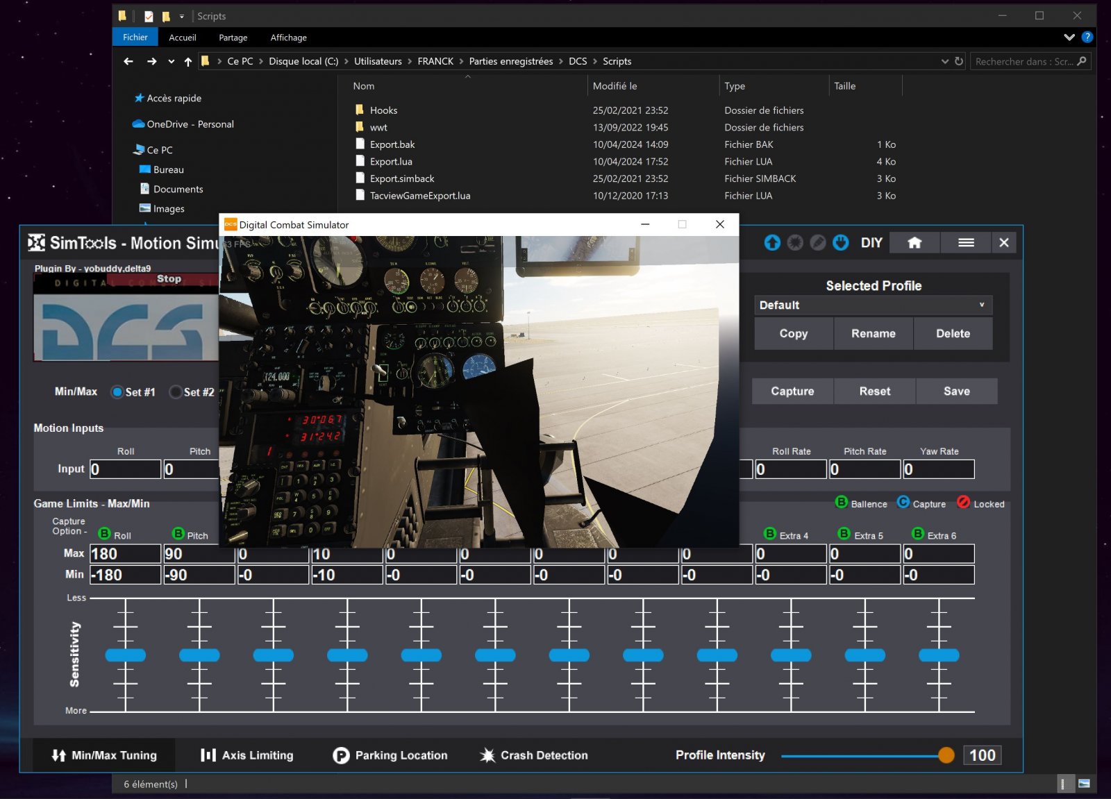

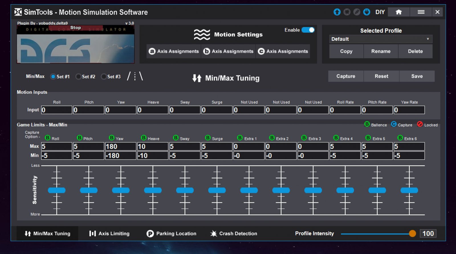

    I currently have a problem, my motors no longer work with DCS.
    I am using the latest version of the DCS plugin for simtools 3.
    Motion inputs are 0 in flight. However, simtools detects DCS well.
    I have no movement issues with my other games.
    Has anyone had this problem?
    I can't find the solution.
    I'm attaching a screenshot of simtools in the game and my Lua file from the game.
  13. yobuddy
    51,773Coins
    +5,206 / 19 / -0

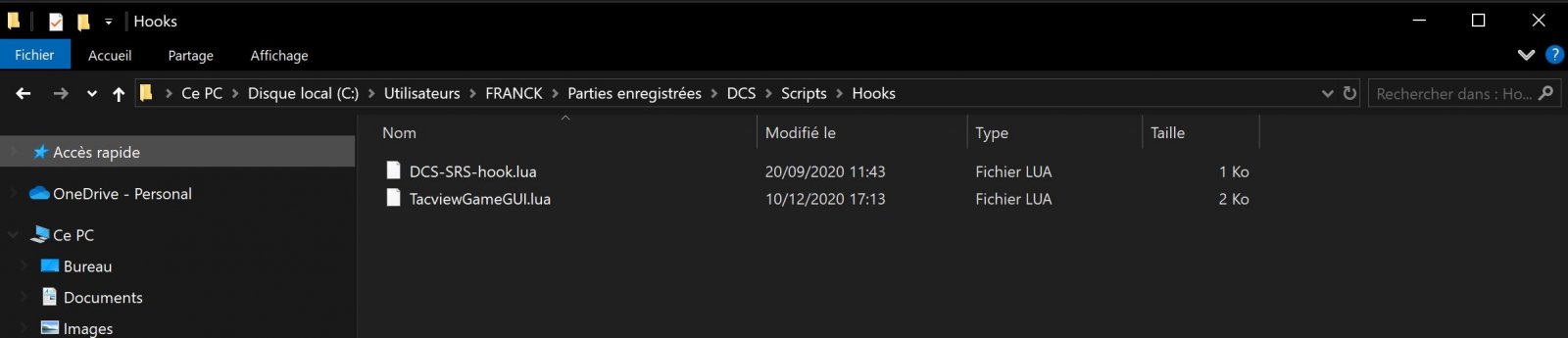

    The lua script for the DCS plugin is missing from the scripts folder.
    (You should have a script called "Export.lua" in the scripts folder.)
    If you remove the v3 plugin, then restart SimTools v3 and reinstall the plugin, it should work again.
    (I have no Idea how the lua script got removed thou, maybe other software your running is removing this file?)
    Take care!

    Hi
    I just deleted the plugin and reinstalled it.
    The lua file was just created in the script, but the problem is still there. No movement
    :( Capture dcs.JPG

    When I test the movements in game no problem it works.
    But in the game, the movement inputs are 0 and there is no movement.
    Does someone have an idea?

    Yes, I've had the exact same problem for over a year now. In fact I've had it since I first tried to connect my motion platform to my DCS installation via SimTools. No one could never give me any tip that were useful.
    I'm beginning to think that the problem is not so much in the Simtools software, but in the Windows version you have installed. As long as you use a Windows installation with english language as the installed language it seems to be ok. But in my swedish installation of Windows the map "Saved games" has another name in the swedish language. I'm beginning to think there is a problem with DCS lua files supposing and taking for granted every one uses an english installation of windows. Therefore it can't recognize the language SimTools need to find in the lua files.
    I could ofc be wrong from beginning to end, especially since I'm not a programmer.
    Anyway, I have the exactly same problem as you have. Can only hope for someone to take a deep look into it and find a solution some day.

    The DCS file outputs data in a way that it will work for all regions.
    My guess is the problem has something to do with there being multiple lua files in the script folder.
    Or that there is other software re-pacting the game for itself when the game is run.

    What software would that be? I'm running quite a standard installation. Ok, I have a Fanatec steering wheel and pedals and HP Reverb G2 VR-kit. And a Samsung 49" Odessy screen. Thrustmaster Warthog stick and throttle. Could any of that be the reason of re-pacting?
    No multiple lua files that I can see.

    Anything else that needs a lua script for the game really. I have seen that SimHub like to auto patch things.
    Do you not have a scripts folder in the dcs folder?
