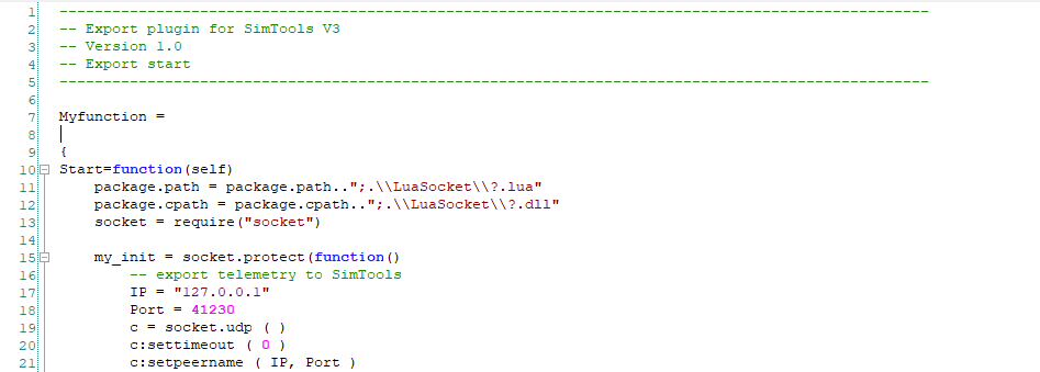

    Please verify that the lua file looks like this below, as our lua file for the plugin does not have that text in it.
    There is no need to rename anything, just select the "...Sparade Spel\DCS" folder and after patching, you should have a "...Sparade Spel\DCS\Scripts\Export.lua" file, and it should look like the above pic when opened.

    Sorry, that line were from the Script folder in the game itself. You talked about the "dcs" folder so that's where I took the example from. I just wrote it to make an example of the game using the word "Saved Games" and not "Sparade Spel" by it self. Thought it maybe had something to do with my problems. Now you have explained it don't so I leave that hypotes behind.
    And yes, I have the exactly same lines in my folder "Sparade Spel"_DCS_Scripts_ export.lua

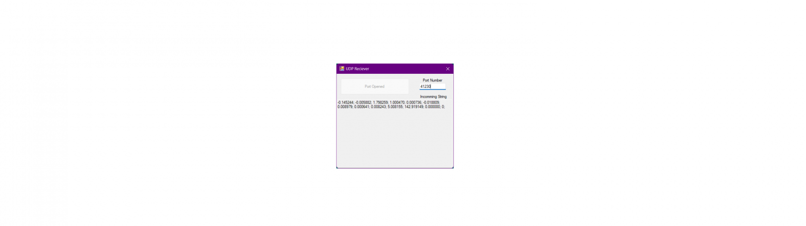

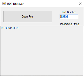

    Now lets see if DCS is loading and running the script correctly.
    (Please make sure SimTools is not running)
    Run the test app I linked below, set the port to 41230, and then click "Open Port".
    Now run DCS, and see if you get any data in the window of the test app.
    Please let me know how it goes.

    Yes, I did run that app. Lots of numbers going on and changing all the time. I did need to turn off my windows virus defender to make the app UDPRecieve to run though, so I thought maybe that was the problem for me and turned down my virus defender system all tougether. Firewall I have already told to make exeptions for SimTools and for DCS (installed on my second harddrive).

    Excellent, so we know the script works, and the game is sending the data we need.
    Will you please post a screenshot of the test app showing the changing data, so I can compare it to what I get?
    No need to do a bunch of extra stuff, were just testing one step at a time.
    We now know the plugin is patching correctly for you, and the script is working for you, as the game is sending data. So the next step is to to take a look at what you are receiving from the game, vs what I am receiving, a screen shot of the test app will tell me that.

    This was after I closed down DCS and the strings therefore not changing anymore.
    I'm extremly grateful for your efforts to help me out.
    Kind regards

    Your output looks just like mine here. With the same amount of data (13 groups), same period as decimal point and so on. So I see no reason 'yet' as to why you don't have incoming data.

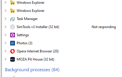

    I have problem when installing SimTools V3.
    The program always not responding.
    Firewall and windows defender allready off.
    Can someone teach me how to fix this problem?
