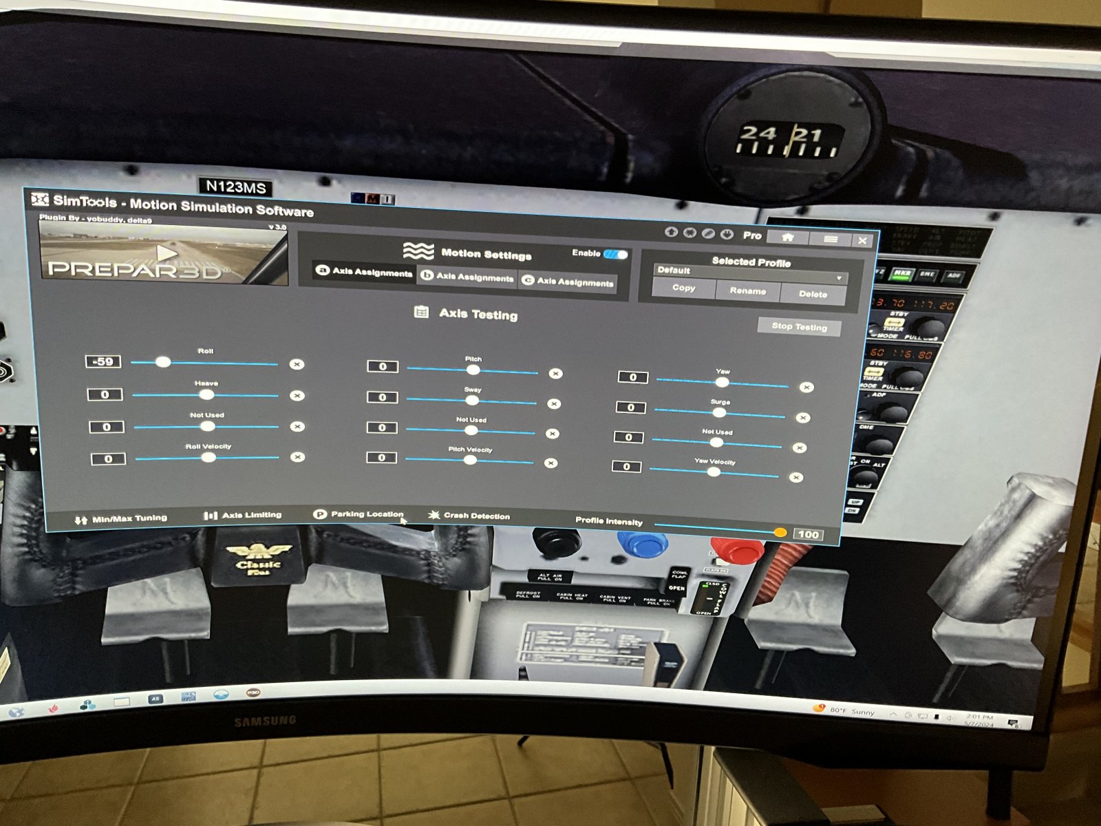

  3. Gerardo Rivera
    Gerardo Rivera Member Gold Contributor
    Jul 1, 2023
    32
    116Coins
    sim was working fine after update now back to no motion. When test got motions.
    thanks,
    gerardo

  7. Gerardo Rivera
    Jul 1, 2023
    32
    116Coins
    I did a new install still issue with Prepard3D and FSX no motion MSFS been working fine even after updates.

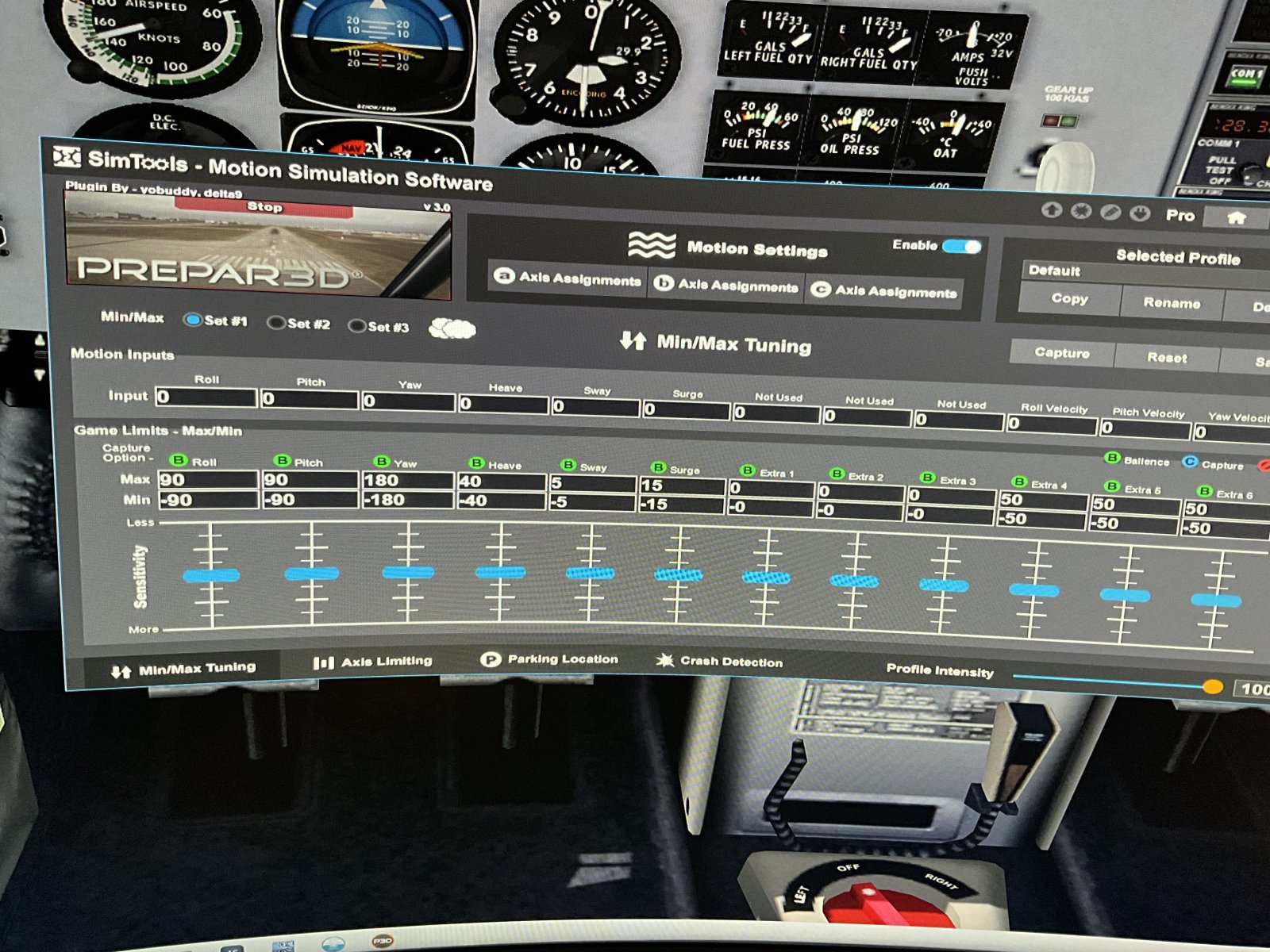

  12. Gerardo Rivera
    Jul 1, 2023
    32
    116Coins
    After V3 simtools update Msfs2020 works fine with motions but lost miscrosoft FSX and Prepard3D motions
