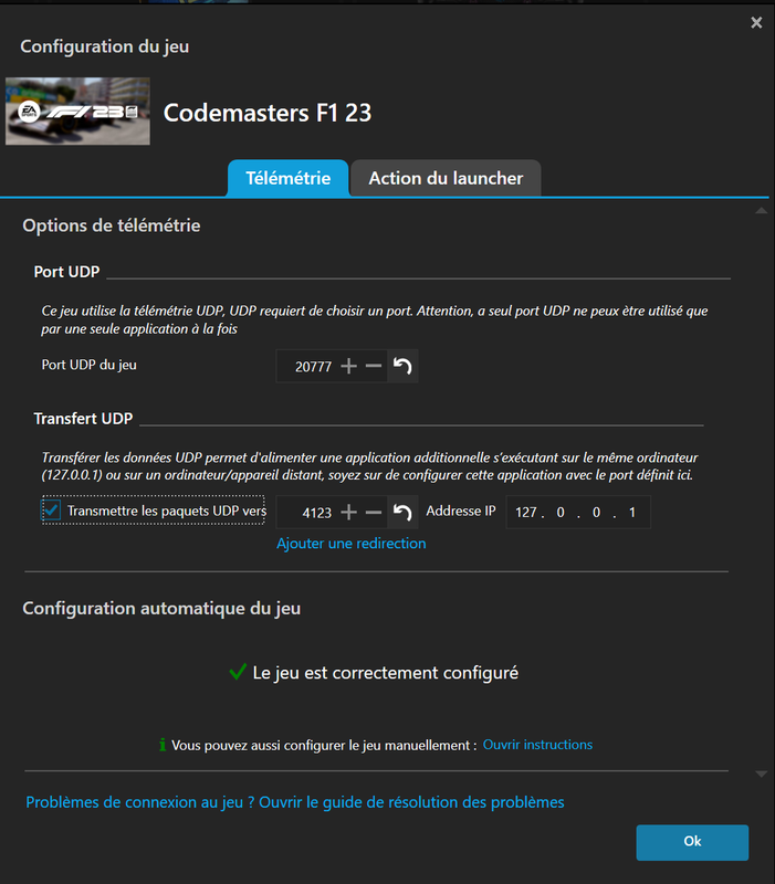

    Your redirecting the packets from SimHub to SimTools with the page your showing above. Therefor the port in the game settings needs to be 20777 for SimHub. I can't tell you if simhub is doing anything to the data, but the plugin is working just fine here without using other software. I mean you have even had it working at one point, so we know the plugin works fine. To me It sounds like you just need to refine your axis assignments, as your getting something from the game now.
    We believe IRacing introduced a bug in their last update that may be tied to their new anti-cheat system. it seems whenever you use more that one app to collect data from the game, it can cause problems that causes the connecting apps to get nothing but blank data. However when using IRacing with just SimTools it works every time and we can not get it to error. So if you are using other apps that collect data, you may have to shut them down to get a reliable startup from the game for now.

    I had the same problem as you, I went through simhub to send the data to Simtools and my simulator had inconsistent movements when I was driving on F1 23.... I therefore sent the data from the PS5 directly to Simtools and the simulator responded perfectly to the movements.
    On the other hand, to be able to use Simhub (display of the dashboard on a phone) I use the data transfer from Simtools to simhub: I now have a display problem on my phone, it displays a bit of nonsense!...
  12. yobuddy
    51,776Coins
    +5,206 / 19 / -0
    This can happen when the two apps expect a different years API for the output telemetry. (Codemasters seems to update the telemetry every year) Anyway, the SimTools plugin works with both 2023 and also 2022 output from the game, thou it defaults to 2023, it may also be worth trying 2022, as it could be what SimHub expects.
    Take care!

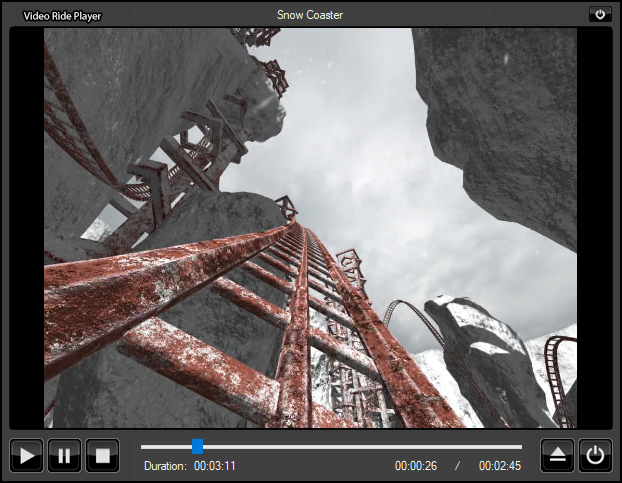

    SimTools update posted (Now with support for the Video Ride Player for v3) :thumbs
    You should update SimTools to the newest version before installing the plugin.
    https://simtools.us/plugin/?varname=1526&color=0e97dd
    We will take a look at it next week buddy.

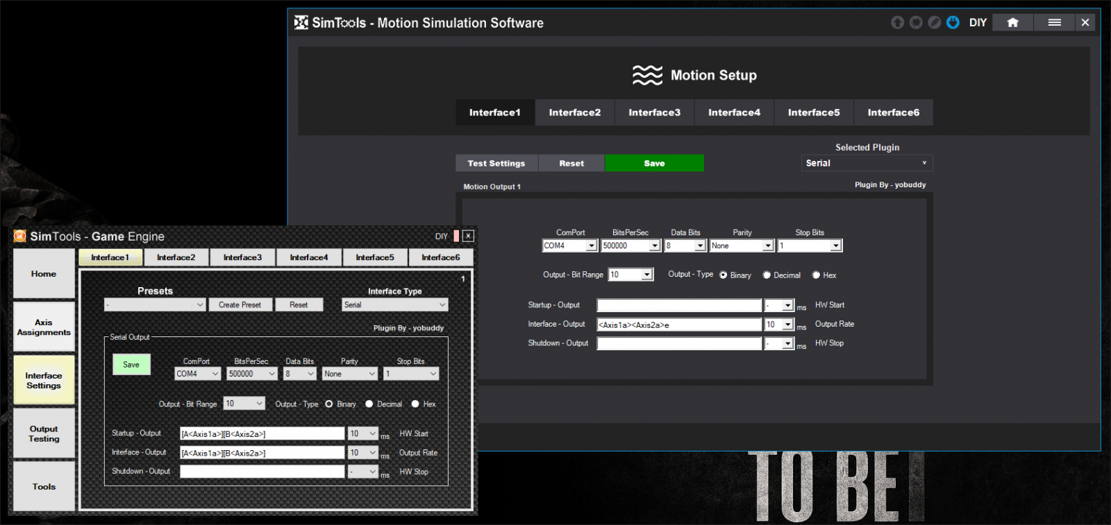

    Hi all, finally trying to test out SimTools Beta v3 to get all the spicy new game plugins.
    For me it is not working unfortunatly.
    Tried all the same Interface settings but nothing moves at all even when testing output.
    Added firewall exception already.
    Here are my settings compared to Simtolls v2.6:
  17. FoxHound.92
    FoxHound.92 2DOF seat mover
    Jan 11, 2018
    73
    52Coins
    +30 / 0 / -0
    After changing the Interface settings from the official manual to mine it works.
    Difference: "<Axis1a>" vs. "[A<Axis1a>]"
    Is the manual outdated in that regard?

    What official manual buddy? It looks like your using the SMC3 sketch with the normal settings.
  19. FoxHound.92
    Jan 11, 2018
    73
    52Coins
    +30 / 0 / -0
    Yeah, I remembered that as well by now.
    I referred to the SimTools3 manual offered on the website.
  20. yobuddy
    51,776Coins
    +5,206 / 19 / -0
    Glad you got it all working buddy.
    The manual simply shows example settings that are not specifically for smc3 is all.
    (But If I had bad information somewhere, I would want to correct it is all.)
    Thanks for the message!
