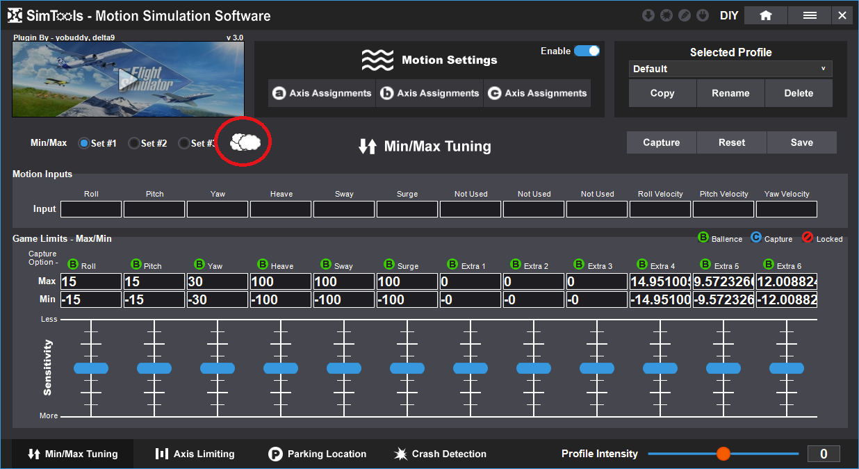

    Hi yobuddy thank you for your reply.
    I have already done all the above you said, simtools seems to get min/max values for air and runway separately by pressing "save" button , but when I stop playing the game and return to simtools I see that min/max values for "air" have all returned to zero!
    What happens?
    Thank you in advance.
  2. yobuddy
    51,775Coins
    +5,206 / 19 / -0
    It's probably the new SOLO interface plugin, go-to the plugin manager and click interface plugins.
    Game Plugins get a update arrow marker on the banner to click to update the game plugin (unless your options is to update game plugins automatically) There is no need to remove a plugin to update it for future reference.
    Know that before uninstalling any game plugin that is working you can make a backup of the game plugin with all you settings. Go to Options, then export on the lower right, then click the game plugin you want to export. Select custom export and check all the added settings you use (motion, crash, dash and vibe) and hit export. Now if you ever want to re-setup this plugin you can simply drag-drop it back into simtools and the plugin with all your settings get restored.
    It also worth exporting a setup plugin for backup also. This way if you ever need to reinstall the whole app, you can simply drag-drop the your backed up setup plugin, and then a backed up game plugin and your all setup again with no settings required.
    Hope this helps buddy,

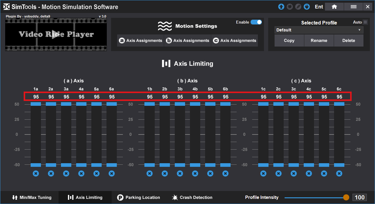

    Hello Yobuddy, I have running SMC3 with Arduino UNO for maybe around 1 year. But sometimes my rig moves beyond limit. If it does, I have to stop the rig and open up SMC3 app and then give zero values for the limits and click ON. Motor back to center after that it works again.
    I'm wondering, does SMC3 have 'Auto Reset' for that?
  6. yobuddy
    51,775Coins
    +5,206 / 19 / -0
    I believe the limit is adjustable in the SMC3 app, but a simple fix can be to simply set the axis limiting for all the axes to 95% or so in v3.

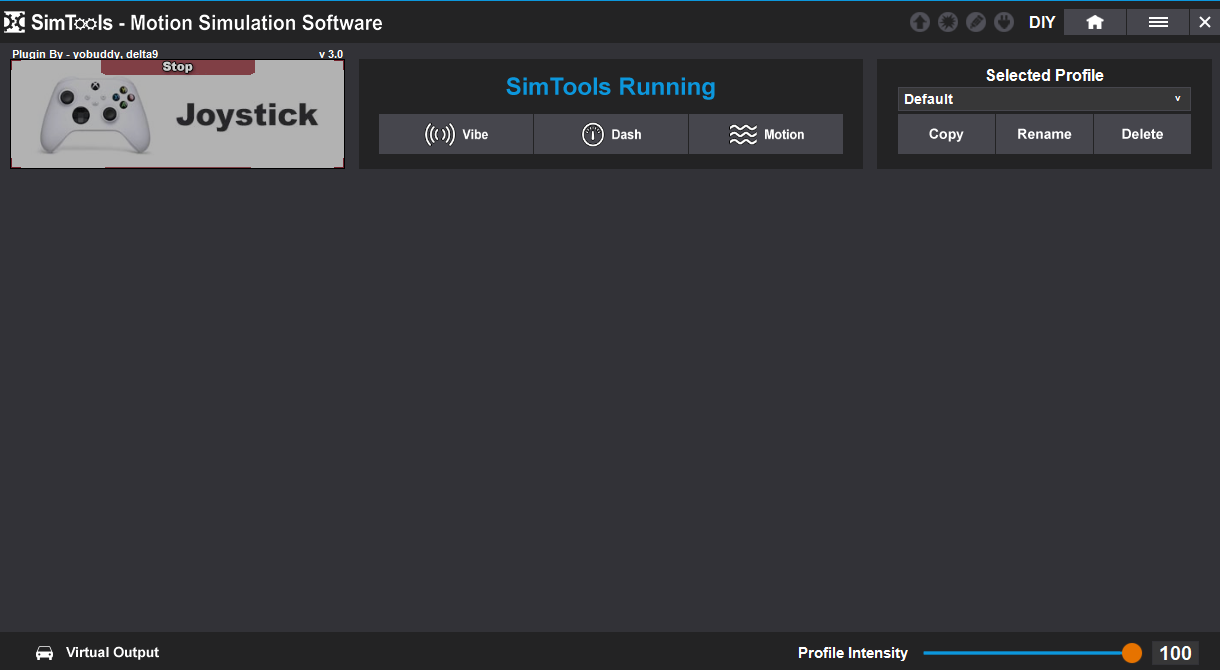

  9. Resrees
    Resrees New Member
    May 11, 2024
    - 34Coins
    Hi.
    I have occured the problem I used joy stick plungin and work well but this plugin necessary show on the window tab but some game need to switch game tab window after that simtools cannot be worked after I switch to game tab window !
    Would you help or advice any fix this problem ?
    I need to keep joy stick plunin running durring I play the game
      File size:
      53 KB
      Views:
      257
  10. yobuddy
    51,775Coins
    +5,206 / 19 / -0
    If using a wireless game-pad, please connect the game-pad to the pc over USB, the plugin should then work even when SimTools is not in focus.

    Is it possible that the "on ground" part of simtools V3 is bugged? In both DCS and FS2020 i get strange spikes all over the place when I am sitting on the runway not moving, however as soon as I start moving they disappear and everything is fine. if I stop on the runway they return. Any ideas here?
  13. yobuddy
    51,775Coins
    +5,206 / 19 / -0
    Know that you can tune the max/min numbers for both 'on runway' and 'in the air'. so my guess is your 'on ground' numbers needs a bit of tuning.

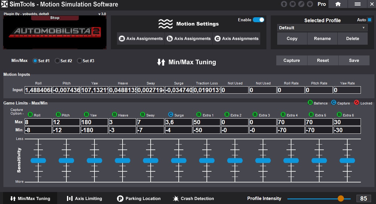

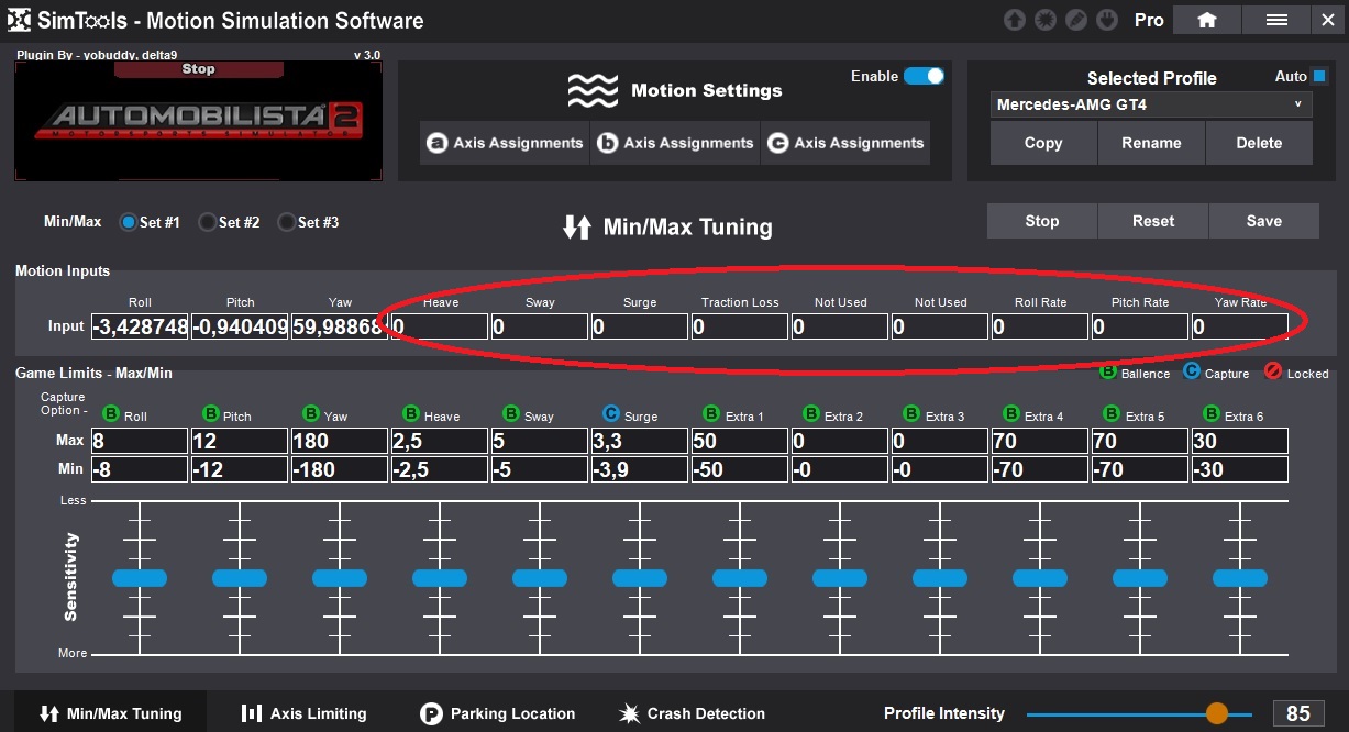

    Hi @yobuddy! Glad to to see SimTools in RC phase!
    I seem to have a problem with the latest version of V3. Automatic profile selection (Auto) does not always work with AMS2. For example, in this picture, SimTools is connected to the plugin and data is coming in. Car at the track is GTE Corvette. However, the default profile is still turned on. Sometimes it is enough to put Auto off and turn it back on to make SimTools detect a car, but that does not always work. Any idea what could cause this?
    Also, recently I have noticed that SimTools stops getting data from the game, while I'm tuning min/max values. I have to select Stop and connect again and that usually fixes it. I have Windows 11 and all the updates are always installed. And SimTools is updated, last yesterday. Windows Security (Defender) is my antivirus. No other security software. What could cause this kind of disconnecting?
    EDIT: This view just occured(partial_data): MB GT4 only partially displays data. Capture is on as you can see, I drove around, throttled, braked, spinned etc... Still, nothing but roll, pitch and yaw. Hard to believe that this car would give only that much. So far it hasn't been like this. What is going on...?? :thinkAny help is really appreciated.
    Could it be that there is some problem between SimTools and AMS2? What can I try to do to fix this issue? Is it possible that AMS2 works differently now? It is updated to 1.5.6.3.
