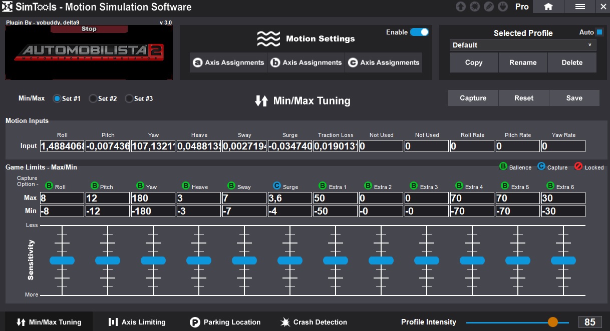

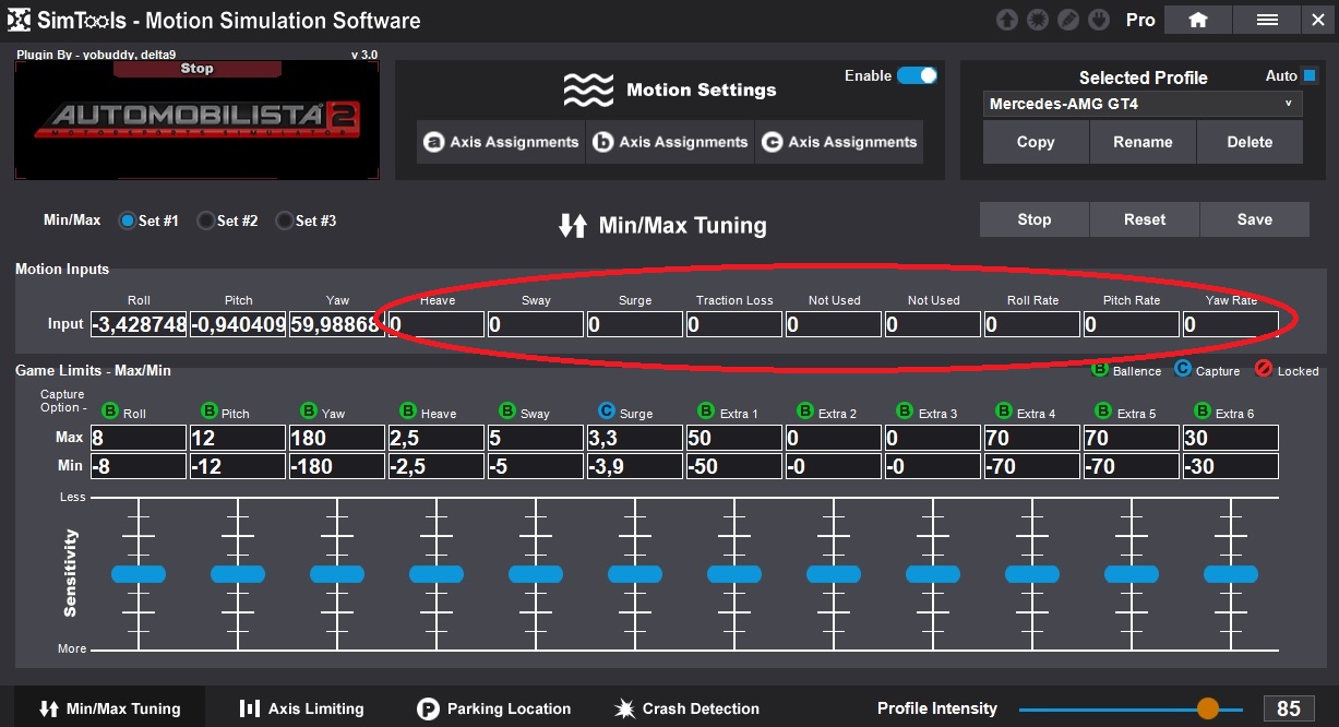

  11. Racer54098
    Racer54098 New Member
    Oct 28, 2021
    18
    117Coins
    +8 / 0 / -0
    Motion platform, 4DOF
    Thank you very much! I got this tested moment ago.
    I did it like this:
    1. AMS2 game open from Steam, monitor only (My Play shortcut is configured to launch VR, this time I did not want VR)
    2. Double-clicked SimTools "Play" to connect to AMS2
    3. Default profile selection on.
    4. On the first attempt, I took the same car (MB GT4) to the track. Profile changed to MB GT4 and data came to all DOFs. So far so good.
    5. I kept SimTools connected to AMS.
    6. I tried to manually change the profile to default.
    7. I went to the main menu and back to the test drive MB GT4. The default profile will NOT change automatically anymore.
    8. When I exit and re-launch SimTools and don't touch the profile, it works again.
    9. Second test: Again, if I change the profile to default or any other car profile, SimTool doesn't change back to a correct car profile, when I go driving from AMS2 main menu.
    10. It doesn't help even if I stop the plugin connection and reconnect.
    DOF min/max values seem to flow ok, though.
    So maybe not totally ok? I hope this helps.

  14. yobuddy
    51,775Coins
    +5,206 / 19 / -0
    Hi @Racer54098,
    SimTools only changes profiles when the vehicle changes in the game. So after you do these steps.
    After step 6, please change vehicles in the game again, and the profile should auto switch for you as needed. SimTools only tries to switch profiles when the vehicle changes in the game. Since the vehicle has not changed at this point, the user can manually select a different profile to compare then with each other. But if auto is on, and the vehicle changes in the game, then so should the profile.
    We could lock the profile drop box when auto is on, and it would keep users from changing the profile, but its nice to be able to compare profiles when tuning in a new vehicle in the game I think.
    Anyway, maybe run one more test and see what you find.
    Take care,
