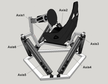

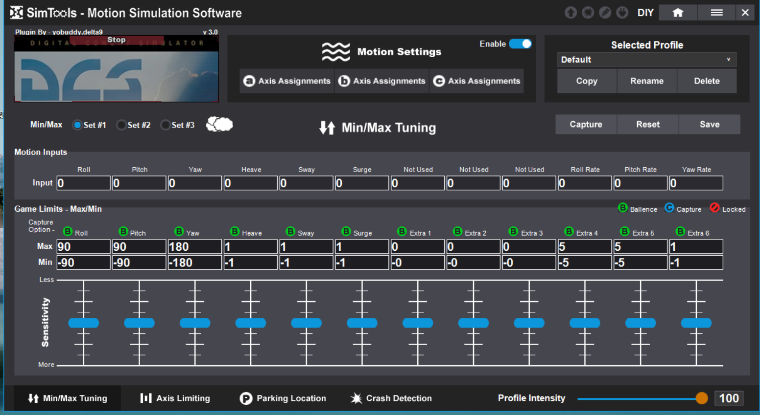

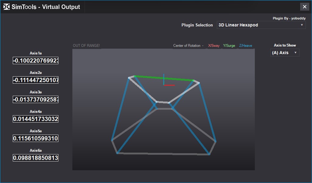

    I'm not sure whether this is a bug with Axis 1a of the 6DOF linear hexapod interface.
    I'm using the flypt actuator order for my Stewart platform and everything works as expected in flypt.
    I can't seem to get roll working in simtools v3beta - all other axis behave as expected however, roll appears to move in the pitch axis between actuator 1 and 5 but works correctly in the virtual output? Is there something that I've missed? Screenshot 2024-09-09 221800.jpg Screenshot 2024-09-09 221701.jpg Screenshot 2024-09-09 221530.jpg Screenshot 2024-09-09 221439.png

    Hi @darkknight,
    "roll appears to move in the pitch axis between actuator 1 and 5 but works correctly in the virtual output?"
    This seems strange, as the same output calculations that run the virtual output plugins, is the same data that is sent for output for the sim. Combing thru the code today thou, I did find a small bug in the boundary filter. Could you show me what filters you are using in the axis assignments? (You can PM me if you want, so we don't clog up this thread.)
    Just a thought, is this the output order you are expecting?

  8. darkknight
    darkknight New Member
    Feb 1, 2021
    29
    63Coins
    +19 / 0 / -0
    Thank you. I thought it was strange as I am not seeing what I expect from the virtual output. The axis order you have shown is correct. The only filter I am using is smoothing at 100% for all axis during testing.

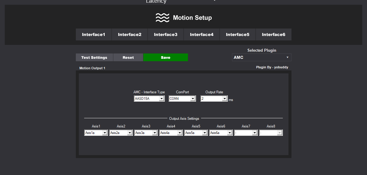

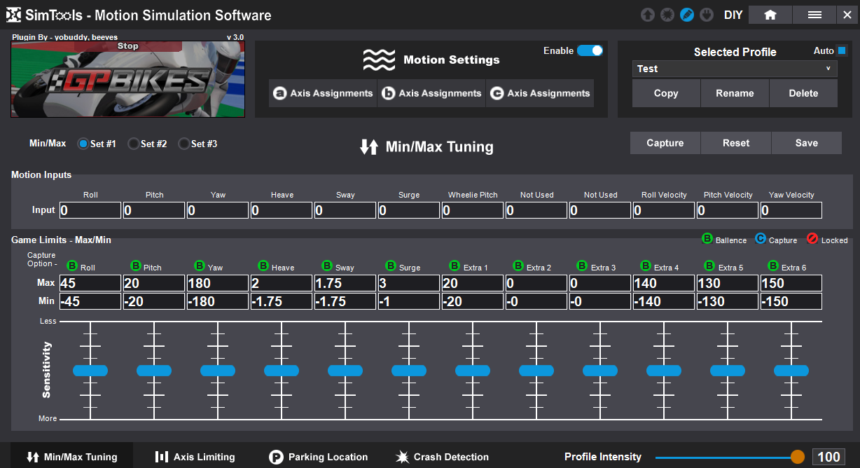

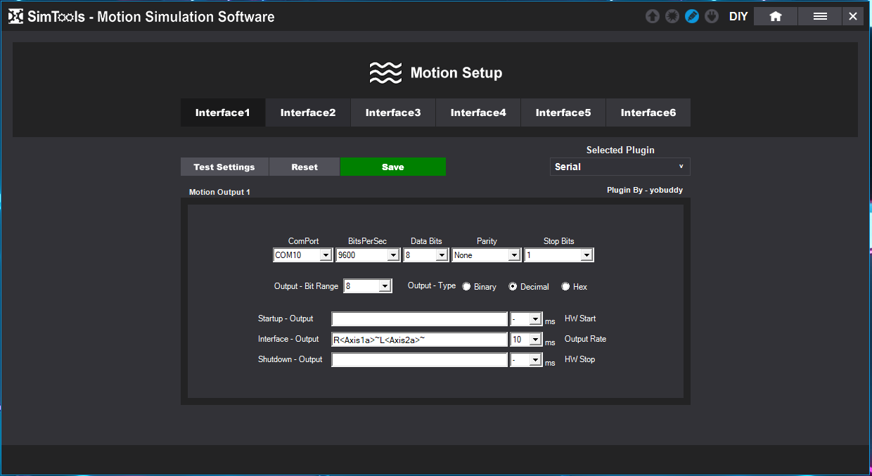

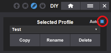

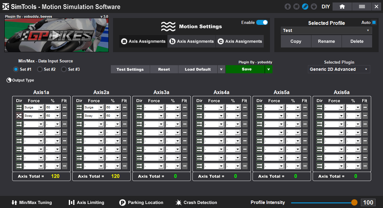

  14. Bouzigues Bastien
    Bouzigues Bastien Bastos26
    Sep 30, 2024
    10Coins
    Thanks @yobuddy for your prompt reply !
    I use a DOF plateform with an arduino UNO R3.
    Here pictures of my settings.
    All is mooving great in "test" mode.
    I use GP BIKES (STEAM version)
    Do you see default in my settings ?
  15. yobuddy
    51,776Coins
    +5,206 / 19 / -0
    You have Auto profiling on, so my guess is when you get in the game the profile changes to a blank one? (As the default profile is not saved with working settings yet?) Please uncheck the Auto profiling and give it another go buddy.
