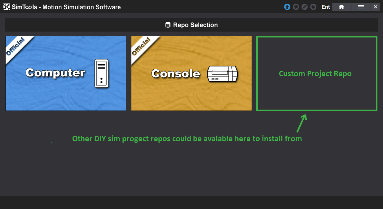

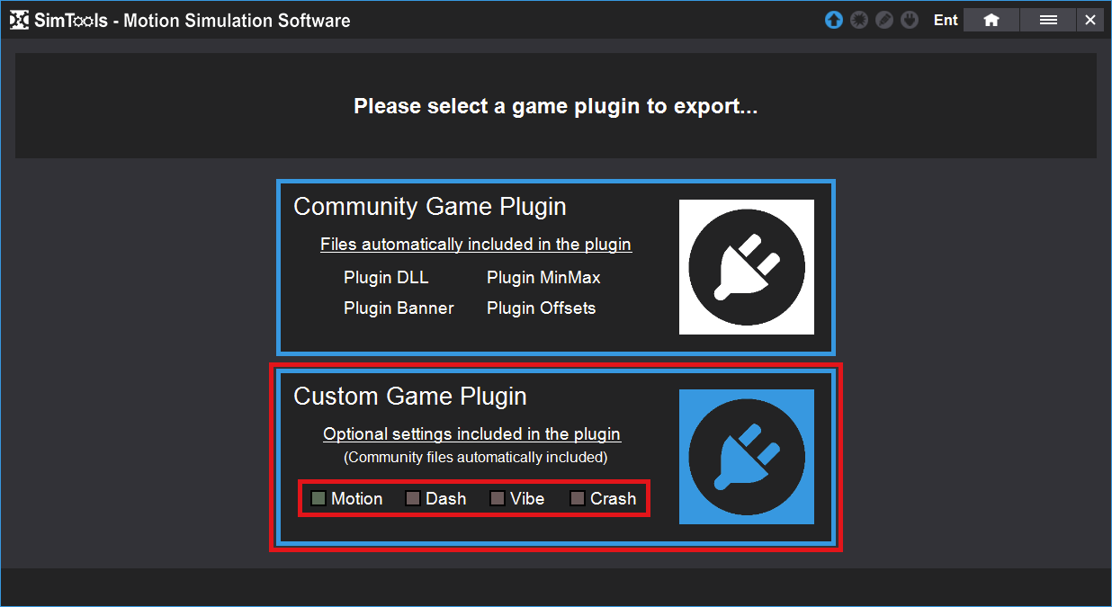

  4. yobuddy
    51,776Coins
    +5,206 / 19 / -0

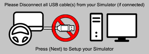

    Note that with simtools configured as needed for any given simulator project, that we can export a setup file for the project directly from SimTools v3. And this new setup file will allow future users to install the file and have SimTools fully setup, without the need for any user settings at all. It will even automatically find and correct the needed com ports for the new system.
    and then...
    All done!
    So the only thing left would be for the user to install a game plugin and configure it. But we can also automate this too.
    Here we can export a custom game plugin that has already been configured in SimTools and it can contain working configurations for Motion, Dash, Vibe and/or Crash. From here this game plugin can be installed by future users and instantly be played. This means a whole setup for a end user is configured and the user does not need to configure anything at all by themselves.
    NOTE: This is also a great way to backup your working SimTools and Game Plugins setups.
    Taking this to the next step, we can even create new repo's for these projects to live at. and have the setup file and a catalog of games pre-configured ready for users to install.
    Anyway, should we find sim projects a lot of people are building, know that we can quickly build a small community of files around a give build. And hopefully make the whole project easier for all.
    Take care,

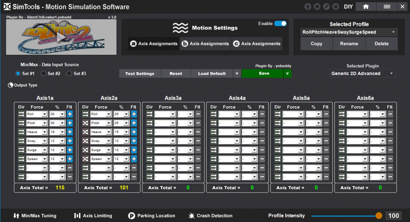

    After learning a lot I've settled on the following settings for No Limits 2 (on my rig)
    Notes that I found good as a newbie:
    • (2DOF system) I found my pitch and heave are in the same direction and "add" to each other so watch out that the unit doesn't "max" out past your limits.
    • Alternatively Roll has sway "removed" from it so you can push it a bit more farther.
    • Surge is opposite of pitch/heave.

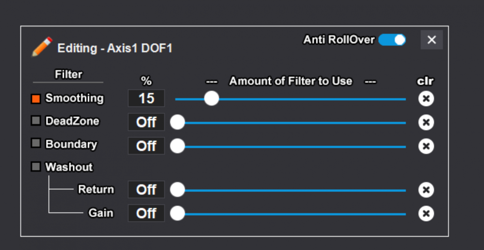

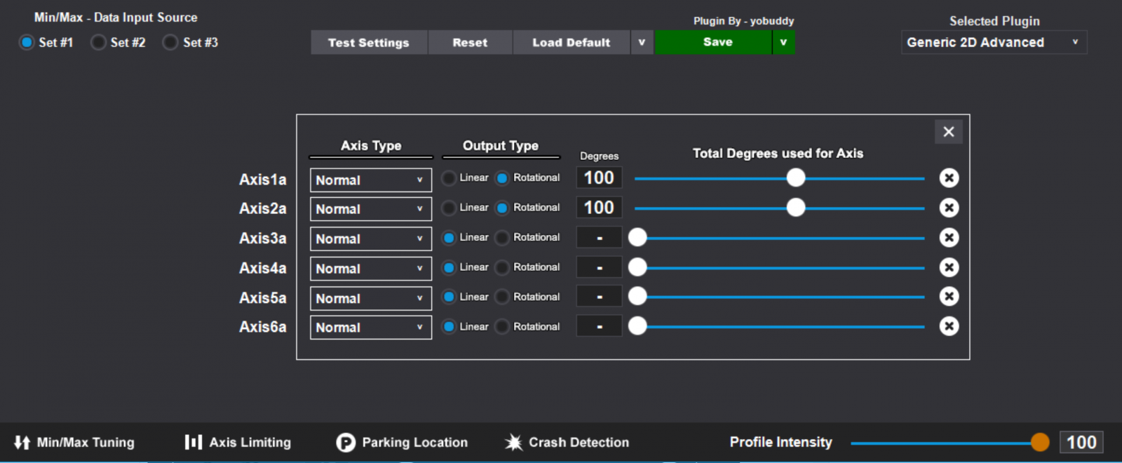

  17. cstdarknight
    cstdarknight Member
    Oct 18, 2024
    45
    265Coins
    +15 / 0 / -0
    2DOF, 3DOF, DC motor, Arduino

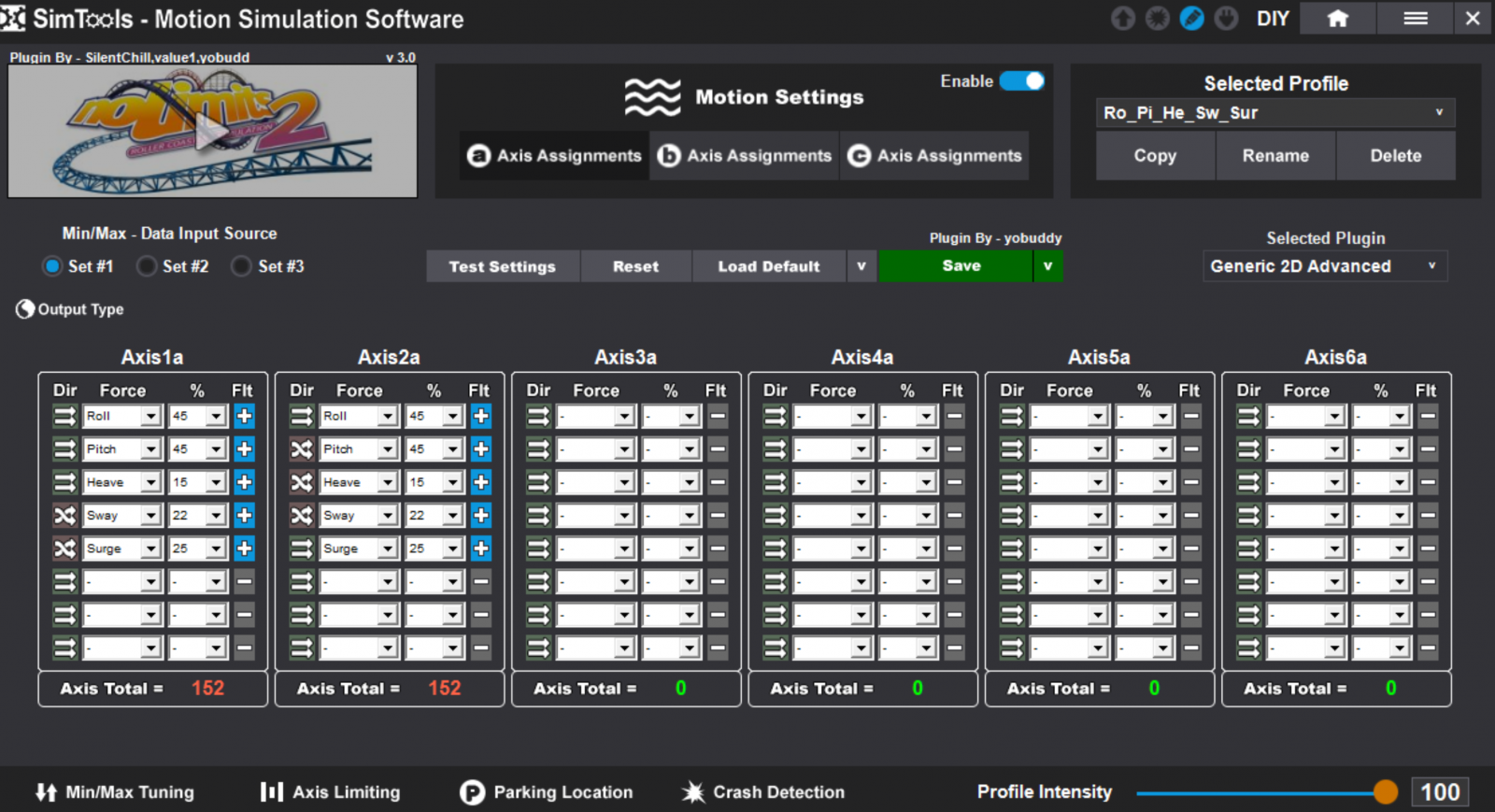

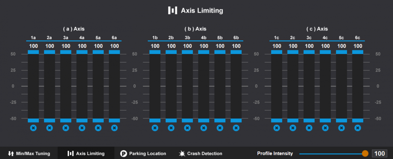

    My God if I knew how fun this would be I would have spent more time building it faster LOL. Having a simulator 2DOF is great for IL2 and I can't wait to add my yaw (traction loss) axis. Anyways I have set up my 2DOF for IL2 with the following settings. Please any tips or suggestions to "tune" it would be very welcome.
    Note:
    • Setup on SimTools 3 (ST3)
    • motors are mounted opposite of each other in opposite directions, hence Roll is same dir and pitch is opposite dir.
    • I needed to adjust the Pitch in min/max tuning to 180/-180
    • No changes to default for Parking Location and Crash Detection
    • Lesson Learned - Anti Rollover on Roll and Pitch is a must in flight sims.
    • Question - My smoothing is set to 15% but I'm wondering if that may be too much. It seems good in the game but suggestions or feedback is desired.
    • Question - I'm not sure about setting my min/max - Data Input settings to "Rotational" and 100 degrees. It's working and getting very close to my "max" range but I do have about 170 degrees in total range (even with it set to 100 degrees).
  18. noorbeast
    22,228
    154,837Coins
    +11,227 / 57 / -2
    With smoothing keep in mind its effects are across all axis, so the minimum amount is generally the best objective, after you have refined the base motion profile as much as possible.
    Yes rotational is correct for your rig.
  19. cstdarknight
    cstdarknight Member
    Oct 18, 2024
    45
    265Coins
    +15 / 0 / -0
    So if I understand correctly. Setup my axis's 1 at a time with no smoothing, then turn them all on to make sure it works and IF it is too "jerky" apply smoothing a little at a time until it is smooth and no more.
    When you say it is across all axis do you mean once I put smoothing on a single force and axis (e.g. Roll Axis 1a) it is now applied to Axis2a and to all of the force(s) on Axis1a and Axis2a?
    • If so, and I applied smoothing to all of my forces on both axis (8 in total (4 Forces on 2 axis)) does it "stack" i.e. my smoothing could be at (8 * 15%) 120%?
  20. noorbeast
    22,228
    154,837Coins
    +11,227 / 57 / -2
    Yes that is the approach, aim for the most accurate and smooth profile as possible, then the minimal amount of smoothing possible.
    SimTools mixes axis settings on the fly, so their is a degree to which the axis settings are mixed.
