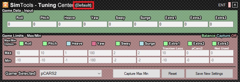

    Just a quick update and pics to show what I'm working on over here.:thumbs
    (All this stuff is functional, but needs lots of testing still, v2.4 is still a work in progress)
    First some of internal stuff that is awesome to get done (finally!)
    - All internal network communication for SimTools has been completely overhauled for speed and efficiency.
    - GameDash and GameVibe communication was also overhauled.
    - PCars fix (I can't get PCars to crash GameVibe anymore, I think its fixed?)
    - Company Tools now includes GameDash and GameVibe (with auto correcting re-setup - com ports/sound card settings)
    - GameManger and GameEngine are now live synced! (select a game profile and the other app has it selected too)
    - GameManger and GameEngine connection and re-connection chatter is completely gone. (now super efficient!)
    Now some good stuff!
    Game Engine now has 3 modes. (Default is Standard)
    If left in Standard mode, everything works as it does now.
    This is great, as it means it does not get any harder for the new user.
    If you set Game Engine in Advanced Mode, you will get per Game Manger profile Min / Max settings.
    (The current profile you are editing is shown in the main title bar as seen in the pic below.)

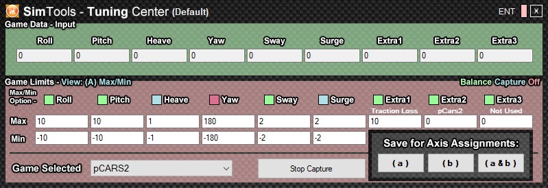

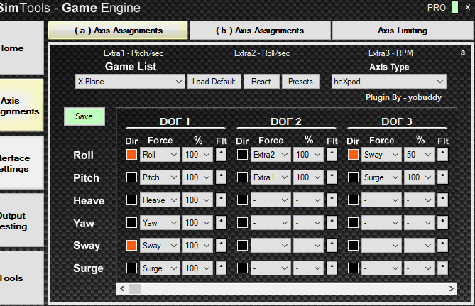

    But then some of you need even more, that's where the expert mode comes into play.
    Here you get per Game Manger profile Min / Max settings but also can also have different Min / Max settings per Axis Assignments.
    Clicking save will ask you what assignments you what to save.
    The expert engine is pretty smart also.
    If you have the same Roll (Min/Max) values for both (a & b) Axis Assignments, it will only compute the needed value once for both Axis Assignments.
    But If they are different, it will compute both sets.
    This continues the trend in only doing as much as is really needed in the engine for output.

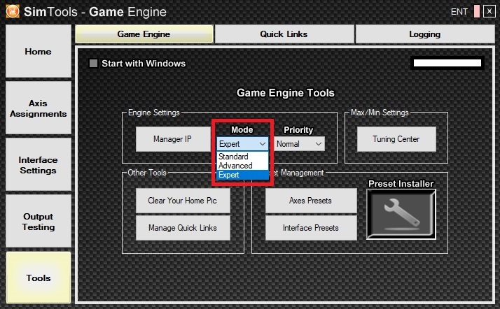

    Oh, and by the way, you can change the Game Engine Mode your using at any time.
    (all modes create files for the other modes, so changing at any time is possible)

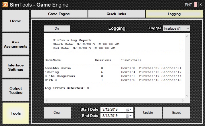

    And the Entertainment Version is getting some love too.
    You can set the interface (trigger) so it will begin logging only when that interface successfully starts up.
    So it only actually records sim time and not just if the game is running.
    And of course you can set some dates and generate some reports etc..
