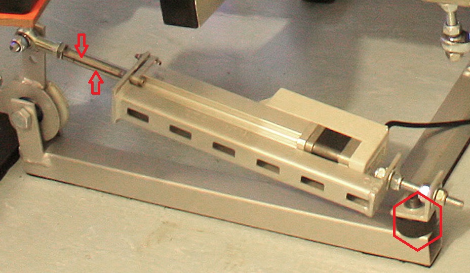

    In your original design, you showed a pivot point with a bolt. That would work well. The actual design is using a rubber mount? How soft is the rubber mount? If it is not soft enough, it will cause radial load which will result in bushing wear and a premature actuator death.
    Please review the diagram below. If the rubber is not extremely soft, then I think the rotation of your arm will create radial load forces where the arrows are in the picture.

    bvillersjr,
    In attachment, picture and sketch to explain my system. Is it enouth ?
    [img600px]http://img715.imageshack.us/img715/4963/img1341b.jpg[/img600px]
    [img600px]http://img502.imageshack.us/img502/5088/img1280k.jpg[/img600px]
    The SCN's support rise up to one centimetre (* on sketch). In your opinion, is this a problem ? (without the weldings)
    Please, see the modifications HARD that y want to realize. It's only mecanic :
    [img600px]http://img687.imageshack.us/img687/600/modif1c.jpg[/img600px]
    It seens the reaction are to hard, don't you think:
    http://www.youtube.com/watch?v=Jlb9V6qhbzI
    http://www.youtube.com/watch?v=E4EYlkX8FCE
    (To modif setup Force-Profiler ?)
    Is it enouth ?? Otherwise what and how to do ?

    I was suggesting that rubber is probably not the best choice for this bewcause it will not give freely enough. If it doesn't give freely, then forces will be applied to the actuator shaft causing the shaft to wear against the bushings.
    It would be better to have a pivoting joint that allows the actuator to move freely in place of your rubber IMHO. You could also use some rubber for dampening, but the most important part is to ensure the actuator can easily move up and down.
