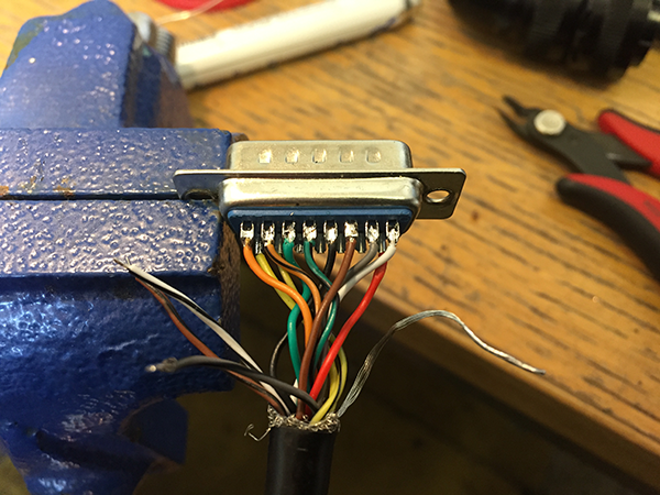

    I typed the number in aleien express and it worked. Just the link not working. they both look like data cables and the ends are wrong for simucube. when im home from work tonight ill take mine off and get you a couple of pictures of both ends mate

    Cheers mate, I will probably have to put the new plug on for the simucube that shouldn't be to much of a problem its just the other ends that fit into the motor if they would be right.

    Yea i suppose the simucube end is straightforward but the motor end is the tricky one. One of my cable looks like the picture at the motor end but the power one only has 5 holes in it. you could contact them and ask as they do say its for power and data

    I urge you to order your cables from MIGE. They are $13.00 from MIGE and the wiring will match the various pics around the web.....see below pic provided via google
    The power cable wires direcly to SIMUcube. For the data cable you will need a female d-sub 15 pin plug.
    you could also contact simracingbay and see if they would sell you a set of completed cables. they are fairly close to you. (Slovenia).
