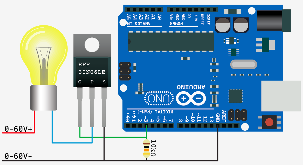

    To me this is not needed to drive a 12v fan. This can be easily achieved by simply driving a mosfet with pwm from the UNO no need for complicated pid control.
    As per pic I borrowed from somewhere.
    Instead of a light we can use a fan.
    Now this makes the code a lot simpler to be done.
    @Ministrinity start a thread in the beta area and I will explain all.
    Edit :Would also recommend a NDRIVE to be used, nice and simple all contained on pcb for you,
    www.freetronics.com/ndrive.

    Btw, that Ndrive seems pretty useful. Will it actually prevent us from burning the arduino? I've burnt about 5 arduinos till now because my power supply is 12v 10A.
    One of those delta fans take 4.8A!
  6. eaorobbie
    20,505Coins
    +1,687 / 23 / -2
    Yes you drive the gate with the pwn pin and will handle 60v to 20amps.
    Your circuit from the other tutorial will work but yes no protection from the 12v.
    As the same an quivilant mosfet and resistor will do the same as the NDrive, but for $7 its no worth trying to make one. I originally used it to drive 12v ShiftLight.

    A quick example
    int Speed;
    int MaxSpeed = 350;
    int MinPWM = 20;
    int FanSpeed = 0;
    int bufferArray[6];
    void setup(){
    pinMode(3,OUTPUT);
    Serial.begin(9600);
    void loop(){
    //****************************** READ DATA FROM SERIAL ******************************
    DriveFan();
    if (Serial.available() >= 4) { //if 4 bits available in the Serial buffer...
    int i;
    for (i=0; i<4; i=i+1) { // read and label each byte.
    bufferArray = Serial.read();
    Serial.flush();
    if (bufferArray[0] == 'S'){
    unsigned int SpeedSmTools = ((bufferArray[1]-48)*100) + ((bufferArray[2]-48)*10) + bufferArray[3]-48;
    Serial.print("You have recieved the Speed of: ");
    Serial.println(SpeedSmTools);
    FanSpeed = map(SpeedSmTools, 0, MaxSpeed, MinPWM, 255);
    Serial.print("You have set the Fan Speed to: ");
    Serial.println(FanSpeed);
    void DriveFan() {
    analogWrite(3,FanSpeed);
    Could easily drive a mosfet , my self I tested with a NDrive from Freetronics , saved on wiring and creating a circuit.
