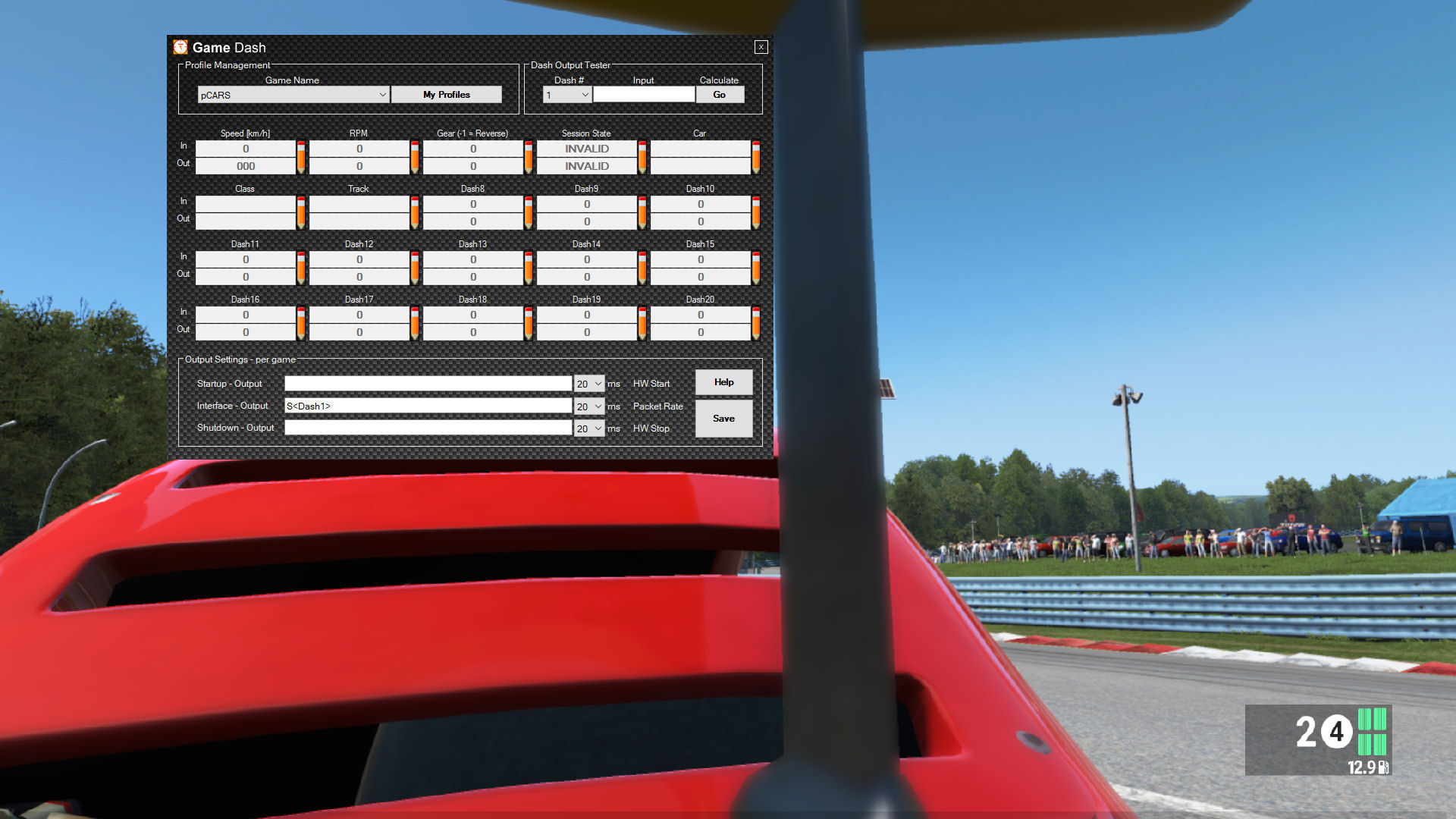

    I do have an issue with PCARS and the windsimulator, i hope somebody can help me out
    In practice mode the windsimulator works fine, but as soon as i start a career or single player race it doesn't work at all.
    Simdash shows an error in " session state " : Invalid

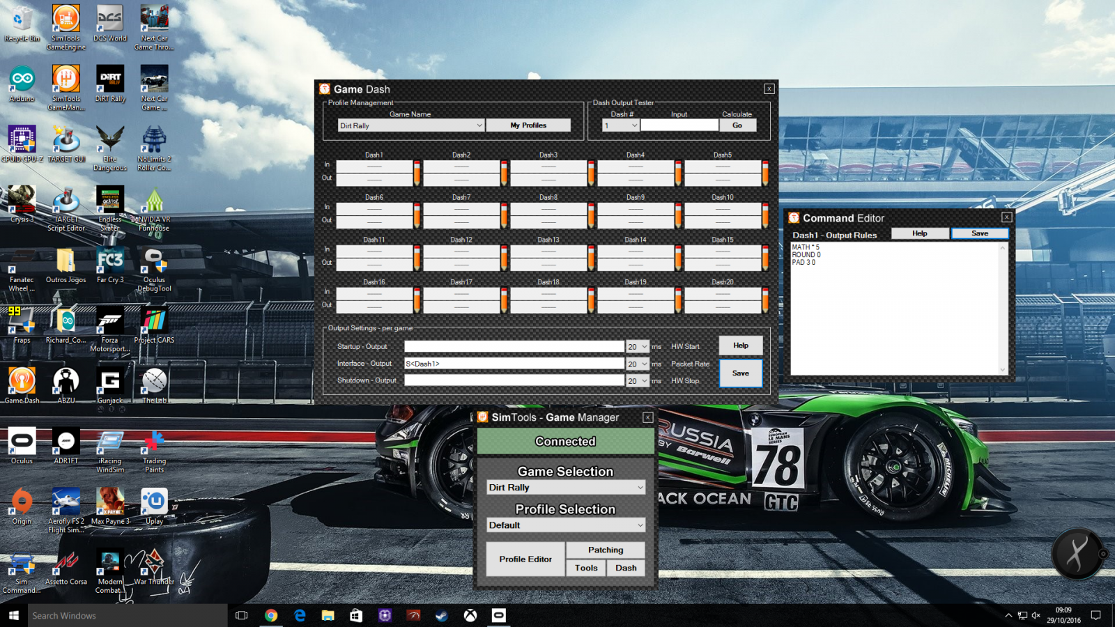

    Guys, here are my settings. No matter code (code from first page or code from page 4) the blowers starts at full speed and will never decrease until I upload another code. Any idea? tks

    For starters you probably don't need to Math * 5 for Dirt Rally because it should already be in KPH.
    Can you post your com port settings?

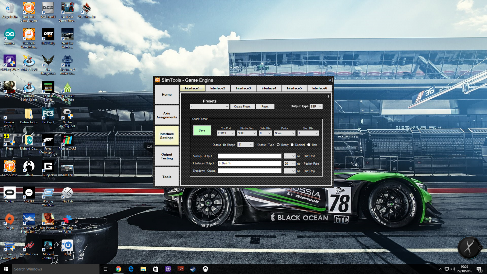

    Hi Richard, I also tried to remove the math line. Here are my com port settings.

    Yup. I figured that would be the problem. I had someone else do the same thing.
    You have it set up in the wrong place, that section is for motion. You want to set it up under the game dash screen
    Delete those com port settings
    Right click the GameDash icon on the task bar then go to settings.

    Finally i have found the cause of why PCARS wasn't working for me:
    Somehow you need to have a race that has at least 9 laps in order to have "simwind" working in Pcars
    https://www.xsimulator.net/community/threads/project-cars-plugin.4780/page-11#post-117264

    I did some further testing and I have narrowed the window down in which simdash works in PCARS race session
    It's 9 - 13 laps
    If you start a race with more or less laps, simdash will see the Session State as INVALID
